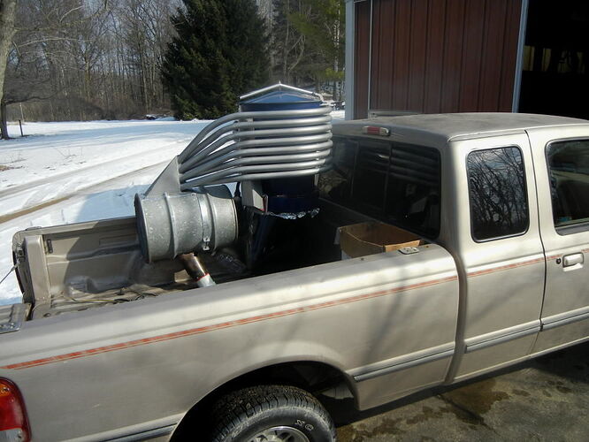

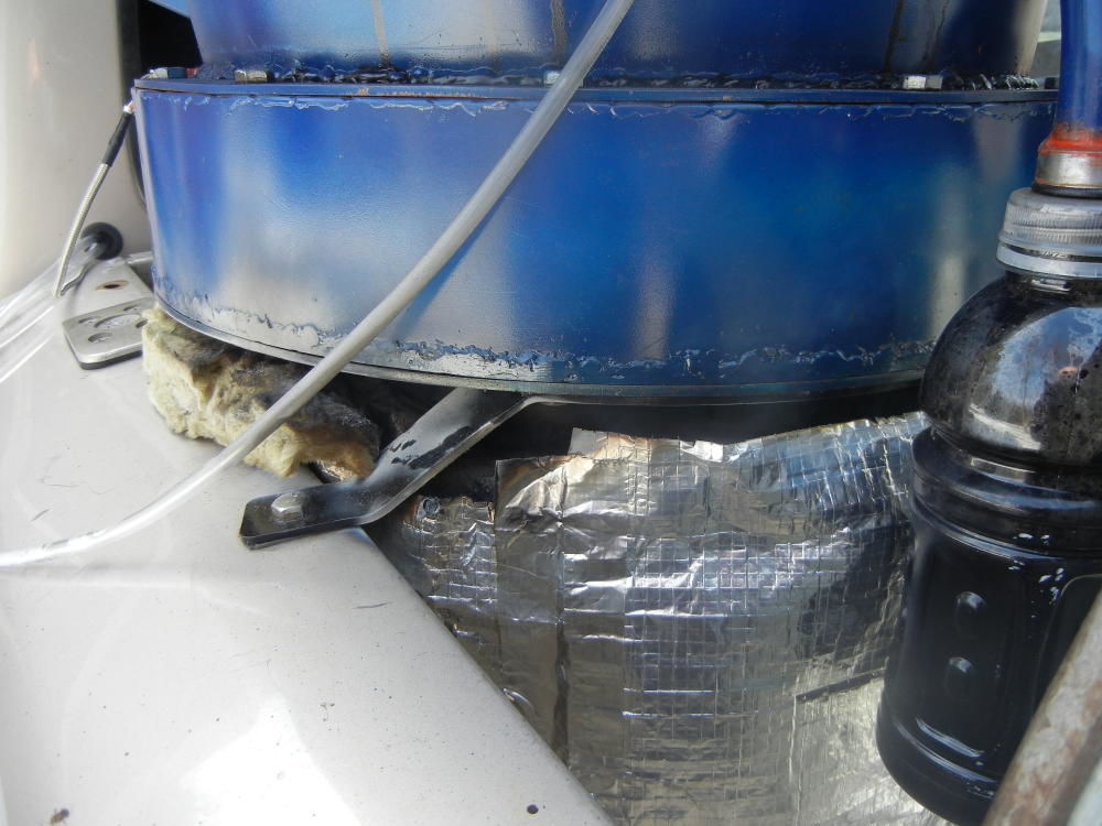

Got the producer fired up. Started the engine on gas. Switched over to woodgas about 3min after lightoff. Drove into town about seven miles away. All I could get was 60 mph. About halfway home I noticed a wisp of smoke from the bed so I pulled over to investigate. A little smoldering of some bad insulation I once used I guessed, so keep on going! About a half mile from home I had a good amount of smoke now. Wow I’m glad to be almost home! When I shut her down I got some flame up from the insulation. Also,Looking underneath at my ash bin I see the paint has burnt off. It didn’t do that on the other firings, but then I didn’t have my foot into the throttle either. So I’ll be pulling the gasifier out of the bed to do an inspection.
Looks good Terry! Neat looking pipes around the hopper, is that the cooler?
Yes Chris they are. It is a GEK knockoff. So after the preheat tubes and the cooler I had just a slight temp increase at the filter. It was upper 30’s durring the ride though.

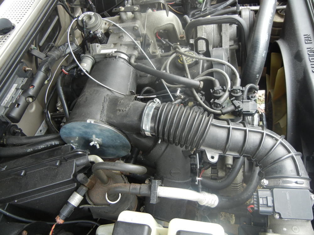

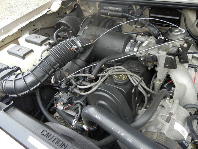

Looks great Terry. Any chance you could add some pictures and details about the throttle arrangement and the modifications under the hood? I have more or less settled on a ranger as my woodgas vehicle. First one will be charcoal (blasphemy I know) but I’ll work up to raw wood. Would love to know what you did after the gasifier to feed it in and control it. Love the cooling tubes looks so pro…

I just did a pressure test now that it has cooled down. Couldn’t find anything at the ash bin.
There is a little ash in the slipped char. I don’t get any in my lawnmower. Before I pull out the gasifier I think I’ll try smaller nozzles. I might have too much combustion going on at WOT. I think I’ll try 85%.

Hi David, The next nice day I get I’ll snap under the hood. I’m using the same throttle and air intake. The gas combines with the air into a mini cyclone right before the TB.

OK here are the under hood pics.

Real neat set up you have there. It looks factory!

Did you make the butterfly valves to fit inside the pvc for the gas supply? Nice setup I really like that. What a difference in the engine configuration.
Yes Bruce, one valve is in the pvc. For the intake I made a collar to fit the id and put a butterfly in that.
