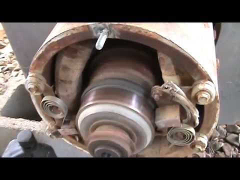

It would be involved but if you found anther Dead unit with electric start you could swap the generator ends and make the 5k unit electric start too. That brush issue is serious enough that I would not attempt to start it until you get the brushes fixed. I might even go as far as to say replace the bushes with new and send me a PM with your address. I will mail you a Com stone to clean it up…
@Wallace I went back in with a good flash light and found the springs to be gone on two of the brush retaining clips. I looked at that clip listing and discovered the next one down, sold two clips for $13, so I ordered four altogether.

I would recommend you change the brushes and buy a stone. Best think to do is read the manual and see what the minimum length the brush should be. If you have less than 25 % life left then change them. Obviously this is a seldom used machine, 25% will last years with infrequent use.
But you have some mild come damage there caused by arcing and it might be a better idea to change them and more aggressively stone the com. and seat them. It all depends how much brush you have. if they are greater than 50% I would leave them

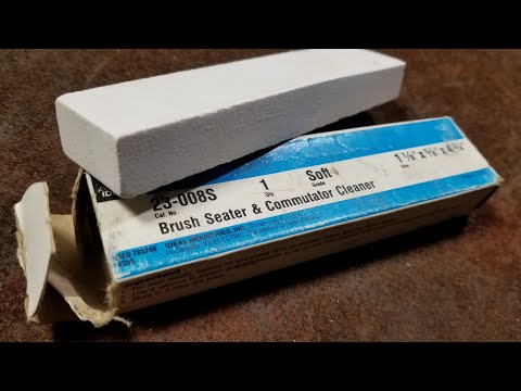

Any fine grade of stone will do. It should be white and chalky. I find the easiest thing to do is scavenge a chunk of Bamboo or tight grain wood and cut a length long enough to reach inside and clean… Think of this as a tooth brush for your slip rings and comutator.
Then I cut the stone down with a hack saw ( this will dull a blade like crazy you are cutting basically an abrasive in a weak binder so use a scrap blade ).
Then I glue the stone to the end of the stick to make something i can reach around and clean those rings and coms with. This does two things… I t cleans of course but it also seats the brushes …
Later I will go out to the shop and get some stones and sticks and show you what you want to make .
https://maraindustrial.com/cart/motors/brushes/ideal-23042s-brush-seater-23042s-3-x-2-x-8-soft.html
Absolutely do not use sandpaper like this. The abrasive may be conductive.
If you have nothing to work with find a piece of canvas ( not plastic… real canvas ) Wrap it around a stick and use that. it will polish and clean but it will not seat and surface a com and slip rings.
This guy has kind of got it right and I even use that same brand myself but you can see its too large and you need to be able to move back and forth to clean not just touch and sit there.
