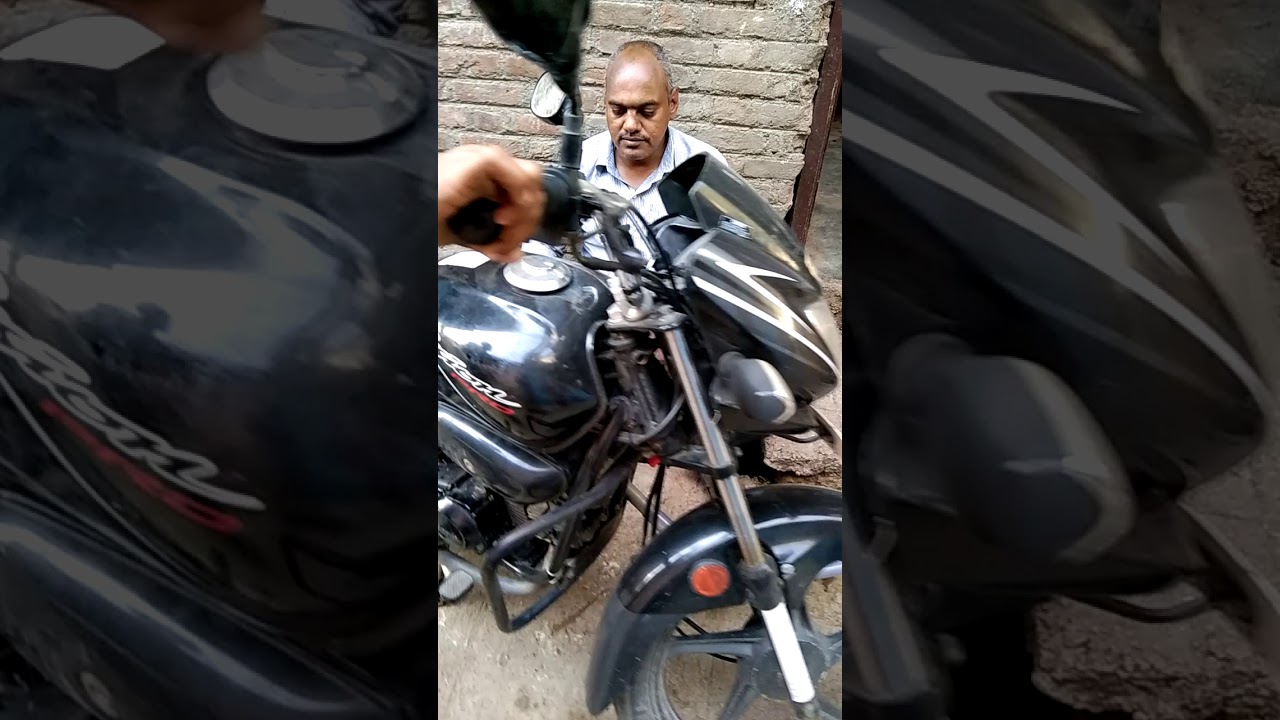

Gasifier based on cattle dung
Link of my video or just search simple fire my version
Well done Vinod , proof of concept now established , now for the fine tuning to begin !
Does the engine rev up at all ? i can hear it ticking over , what happens when you throttle up the engine ? see how long it will run like that before your pipe starts getting too soft and see how much charcoal you have used up and how the nozzle has stood up to the temps .
Hi Dave and Brian,
Yes the rpm were high approximately 10minutes we run on charcoal, after throttling bike used to off,the engine stops
The pipe was not too hot but softened and charcoal consumption ,I have to see
No problems found in nozzle.
