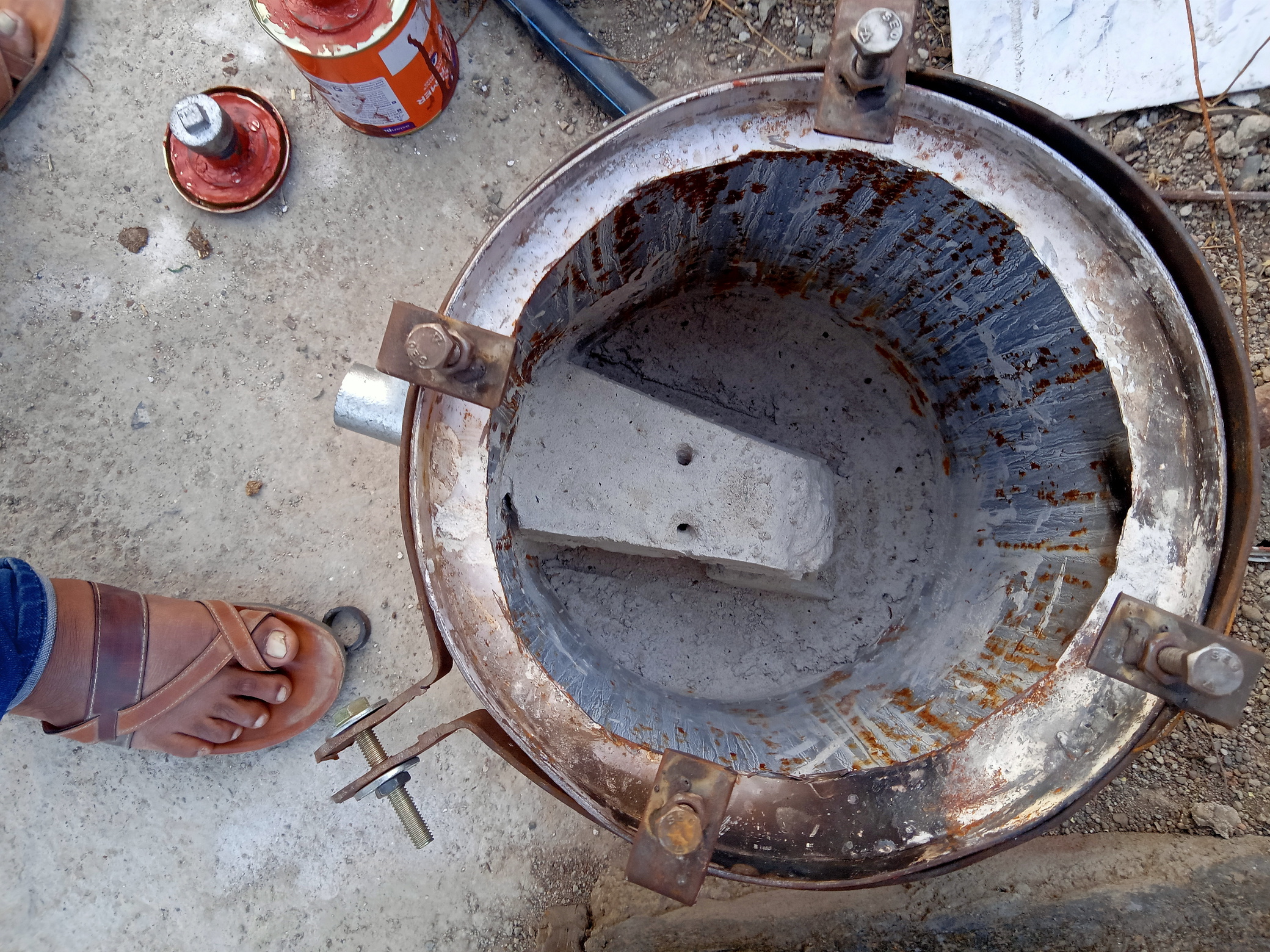

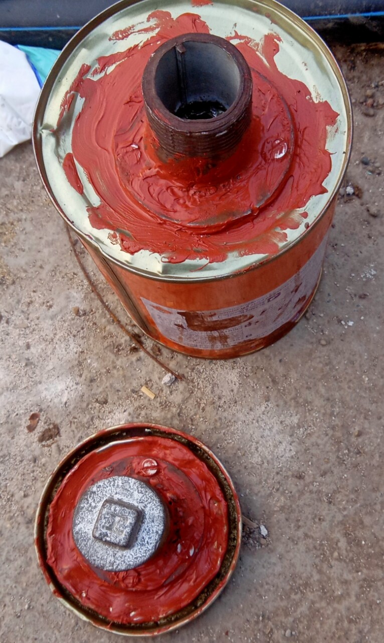

The same tube I am using as gasket for lid sealing of charcoal reactor.

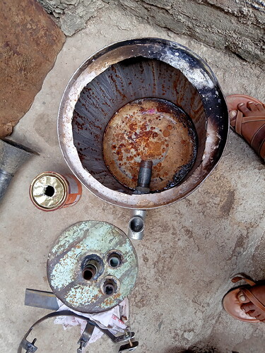

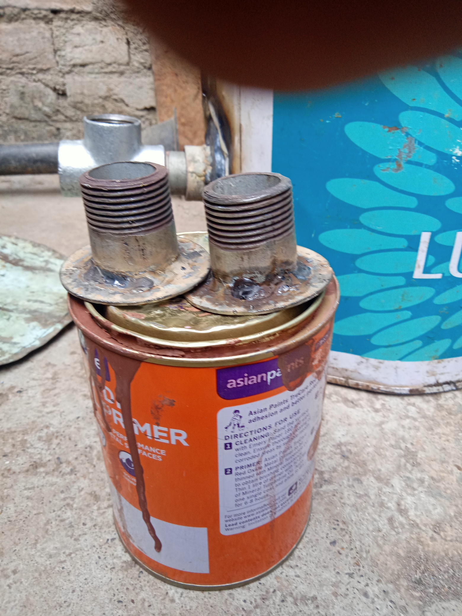

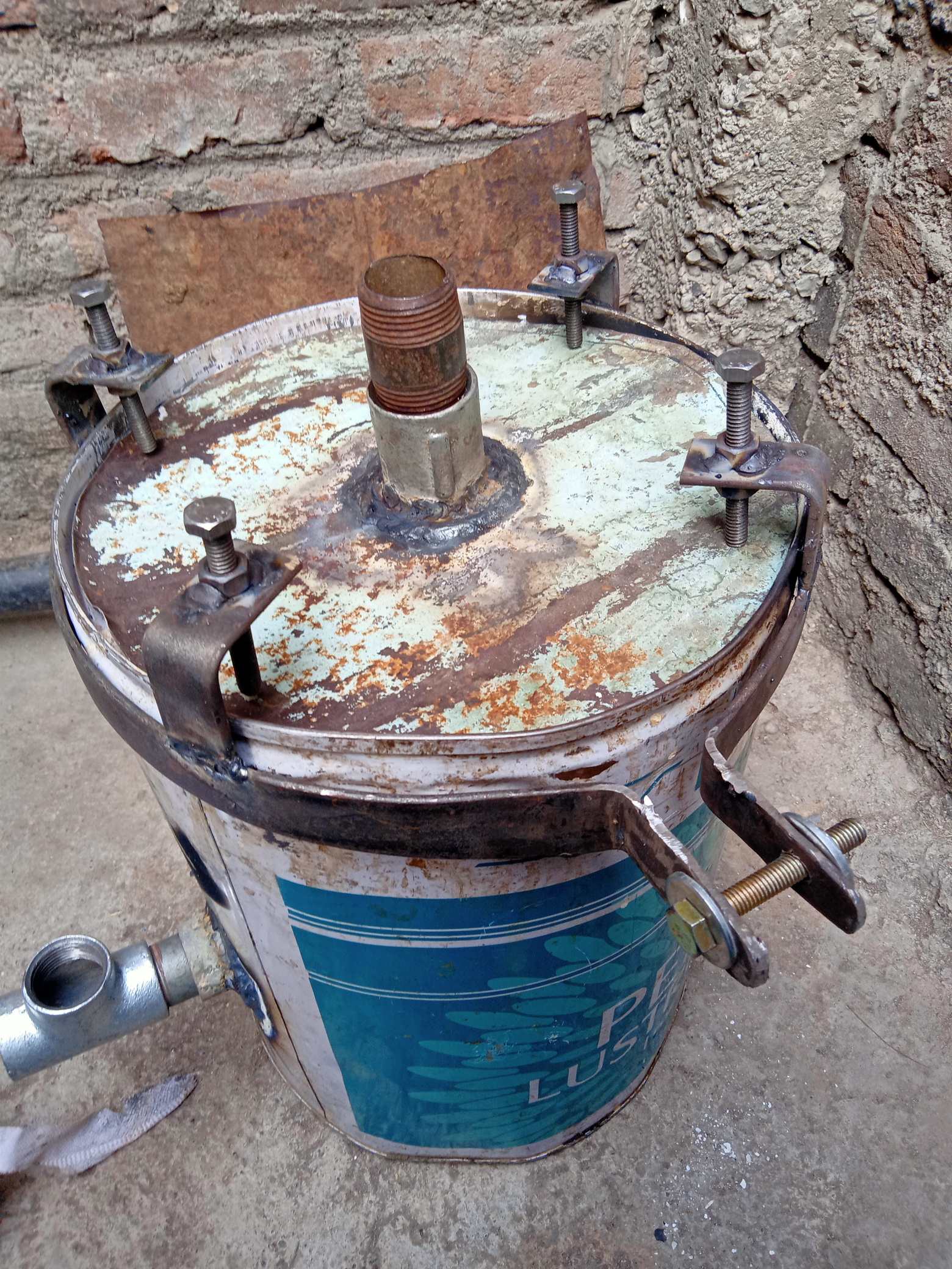

Sorry for photos not a good photo grapher

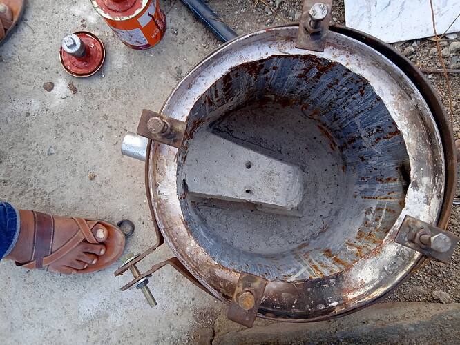

Photos look fine Vinod. That hold down for the lid looks like a lot of work. Good to see you are a doer and not just a talker. Looking forward to seeing it done.

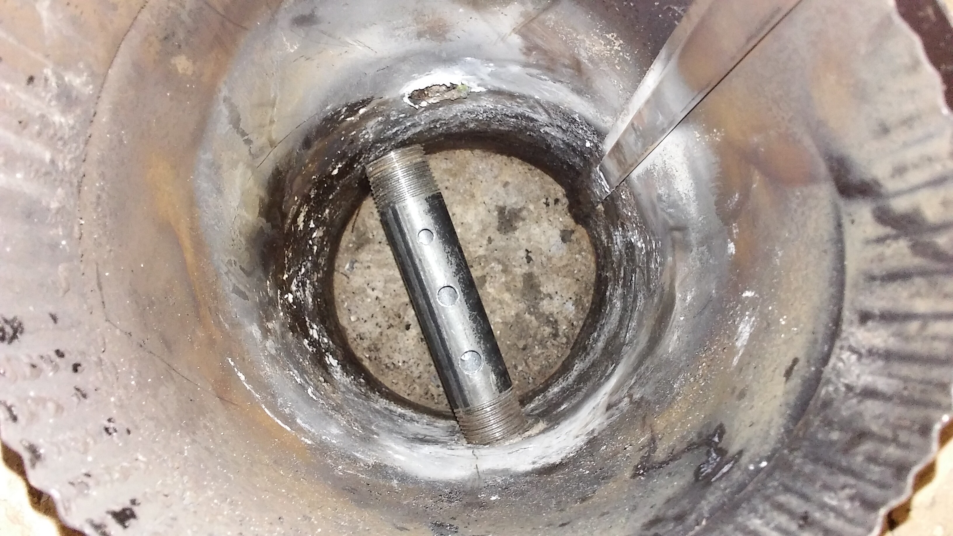

Vinod , just one thing before you light it up , try and protect the nozzle pipe you are showing in your first photo , it will work and it will make gas but it will only last 30 mins and you will have to replace it .
a quicker way for you would be to try and install a T I G nozzle tip into the end of that steel pipe and encase it in some fire clay , or think about trying to order some shot blasting nozzles they are normally made of various types of tungsten carbide you should be able to get them locally or on line .
The lid is held down good but make sure you have a seal of some type there as the smallest amount of air getting in will cause you a lot of problems .

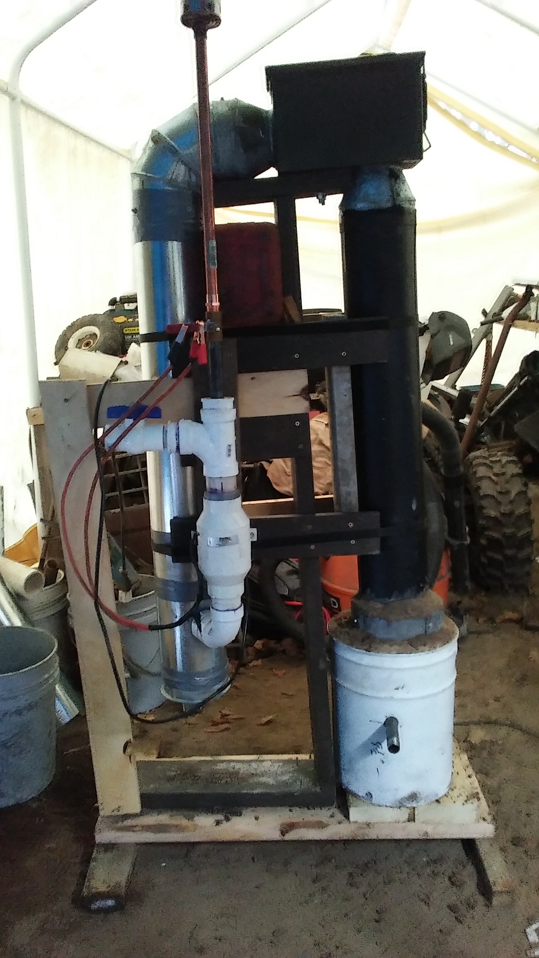

I’m really curious about how you are going to mount this to that little bike. Have you watched any of Koen’s videos?

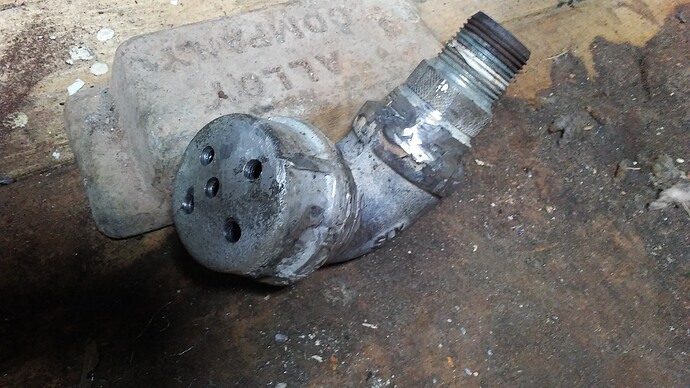

What Dave mentioned about the nozzle. You may have not had time to look all through the forum. You should look at the nozzle Bryan White made.
Also the fluted nozzles that KristijanL developed.

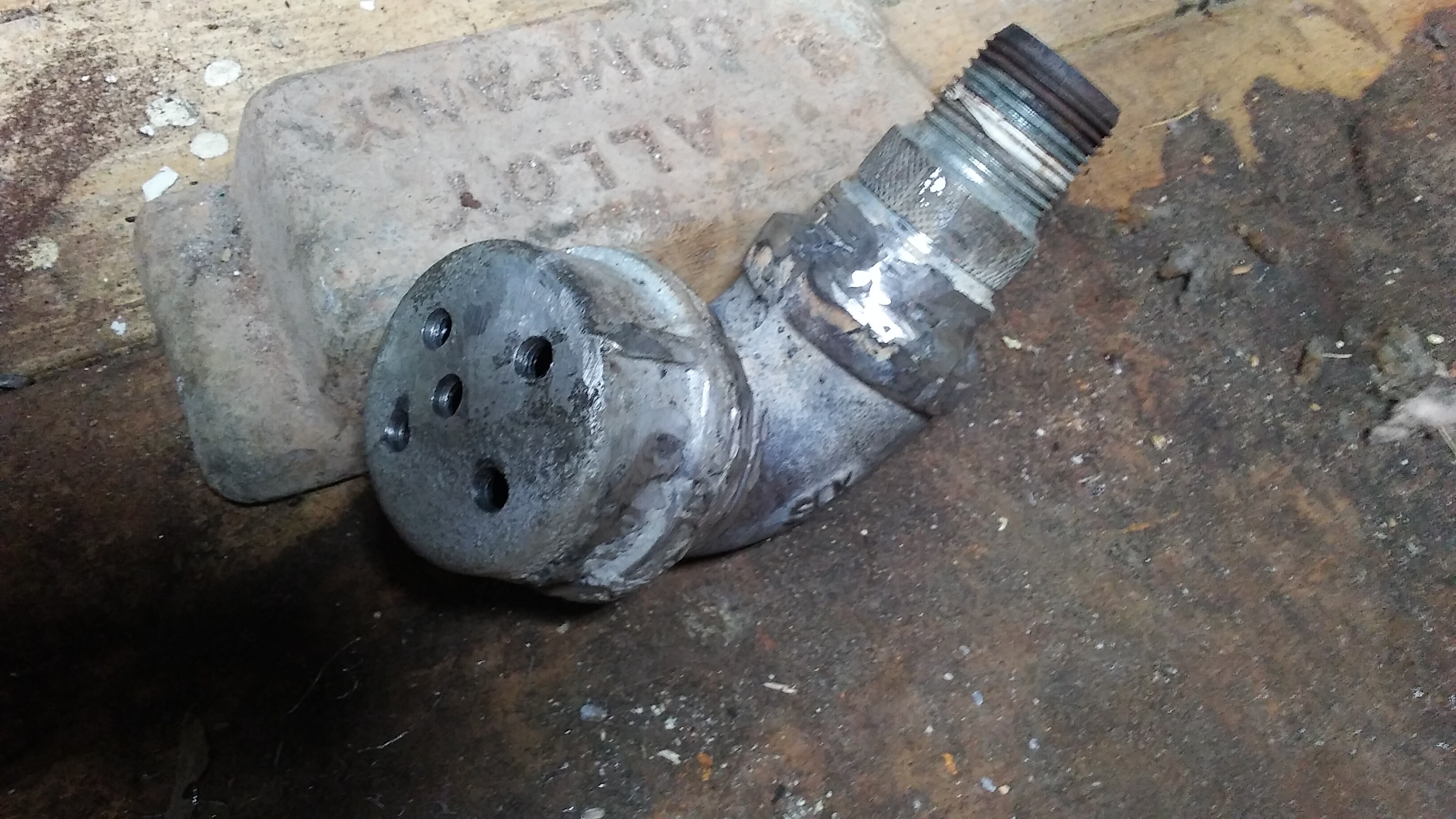

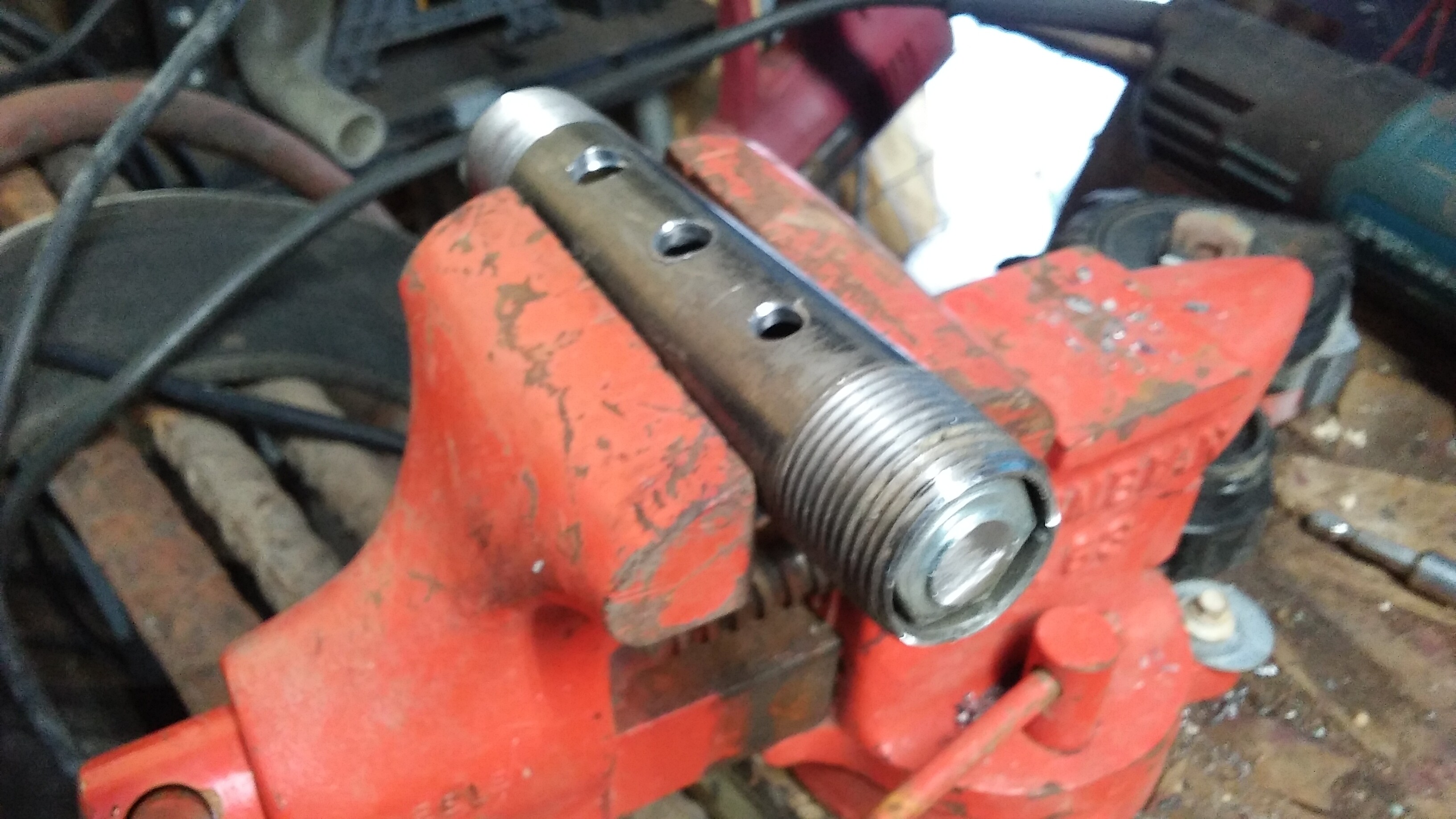

I have made both of these for the simple fire I built. Haven’t been able to test them yet but they are proven designs. This is the Fluted nozzle in my SF.
The Bryan White design.
Either of these will screw into the fitting your existing nozzle is it and can be easily interchanged.
Mr.Tom,
I will use cycle tube as gasket between lid and container

Mr.Dave and Mr. Brian,
Here all these materials is not easily available the nozzle is available online but very costly.
As per Mr.Gilmor I also plan for steel pipe cover for nozzle and and searching same in local market.

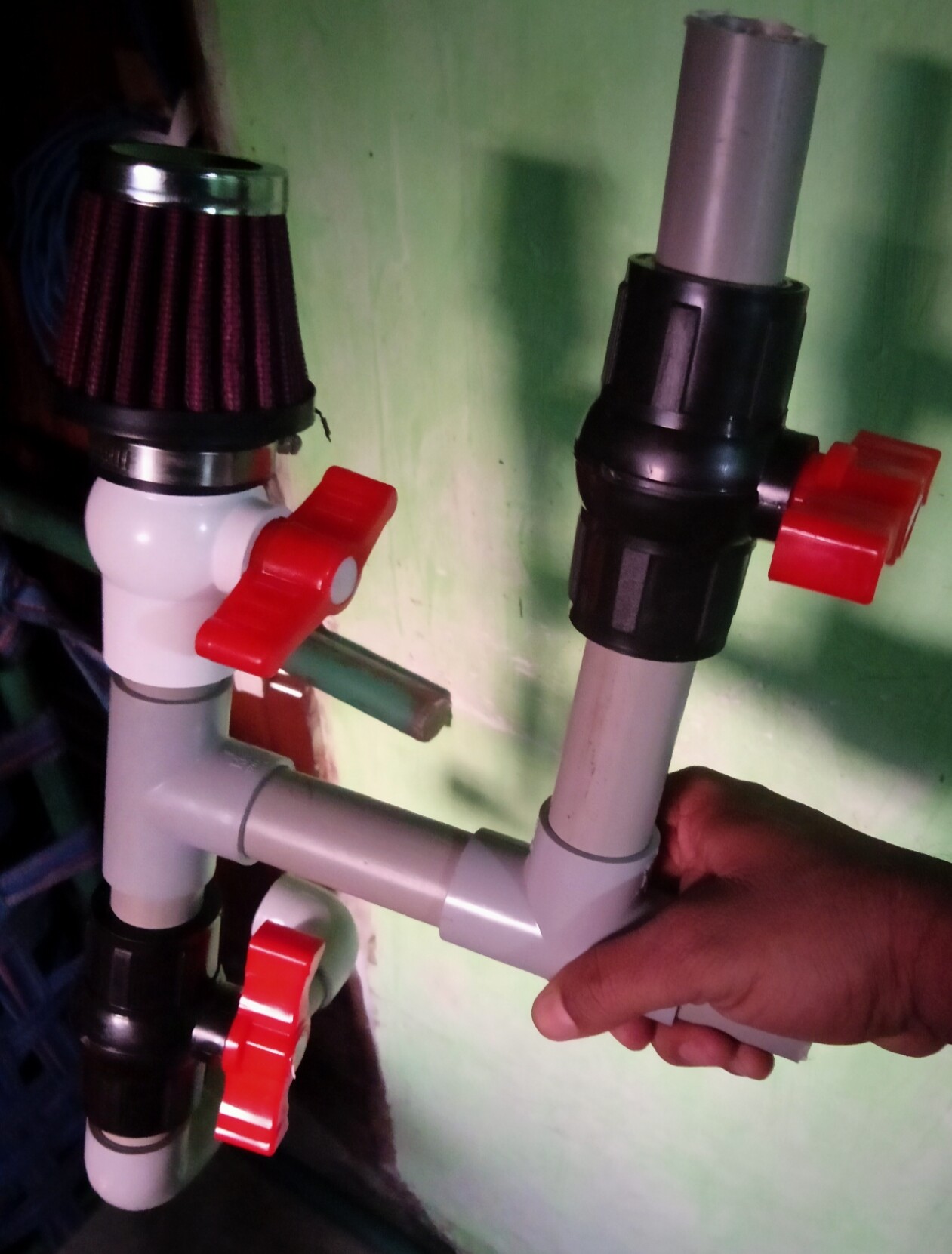

Fortunately dirt bike filtration system I got here just like Mr.Koen used in their gasifier.
Mr.Tom,
Thank you very much I was trapped here in nozzle,but you escaped me the second one is my solution.

Mr. Tom
Just for sack of information if I apply 2 Nd nozzle picture above the same pipe will ignite my gasifier
Either of those nozzles should just screw in the the same threaded coupling in your reactor. My reactor is only six inches across so you would have to make your second picture with a longer nipple to get it to the center of your reactor. If you went with the fluted nozzle I think you would want the center of your line of holes at the center of your reactor. If you look in the picture where I have the fluted nozzle in the vise there is a half inch bolt head driven into the end of the pipe. I did that to allow the water drip to seep out in case too much water gets fed into it. You really need more experience people to help you out here. I’m about half new.
This is a picture of my Simple Fire. Untested. I’m going to try and get it fired up this week.
