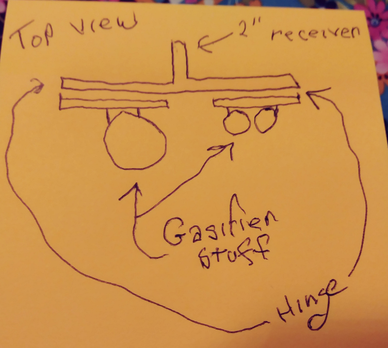

2" receiver hitch. Slide in Tee with hinges at both ends and arms. Noe two arms and gas stuff hinges outward to allow opening tail gate.
One way to fix a gasifier on a car.

That’s work but I have to make sure to keep weight down as the leverage will make the car quite light on the front wheels.
Sorry I don’t get what you mean exactly.
Should I mount two arms with hingers at the hitch and move them out like a V?
Or should I hinger a arm at the cars corner and fixate it on the hitch?
Only problem with hingers is to get them strong enough and to get a flexible gas pipe that handle the heat.

Just an idea made from 2" square tubing. Maybe just one hinge and a longer arm. Maybe flex tubing or disconnect when swinging open. When closed the latch should secure that end releasing most of the strain from the hinge. Maybe start with a trailer.
Maybe make it out of pipe, except the 2" receiver. For the hinges use threaded pipe elbow or what ever. It would work as hinge and gas pipe. Not sure how much it would leak??? Maybe use a pipe union as the hinge point.
Hinge, swing out bracket, gas pipe and gas cooler…
I like the Idea of using pipe that can be the gasifier and second as the frame. Dad and i have considered building a car that has the gasifier as part of the framing such as the frame seconding as the cooling rails. I am not sure of this but I think the elbow threads would be less likely to leak than the union.

Expanding on Jeff’s idea, the hinges could be only strong enough to swing the unit out. For driving the weight could rest on the tow hitch, held in place by a pin…
Making a hinged frame to mount the gasifier on seems possible, but what can I use for flexible gas piping?
