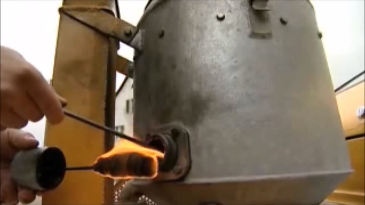

hello ian, welcome in the forum…in this swiss video the guy after minute 6 has a large gasifier for electricity and heating, feeded with old furniture stuff, like you will do…
