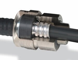

I came up with another solution:
Steel armoured cable connectors…
Remove the rubber seal and replace with a graphite packing rope for a good seal.
Advantages include making the air pipe depth adjustable for setting the distance between the oxidation zone and grate in down draft or cross draft simpler.
As the tip erodes it can be cut, ground or replaced by pulling the whole unit out.

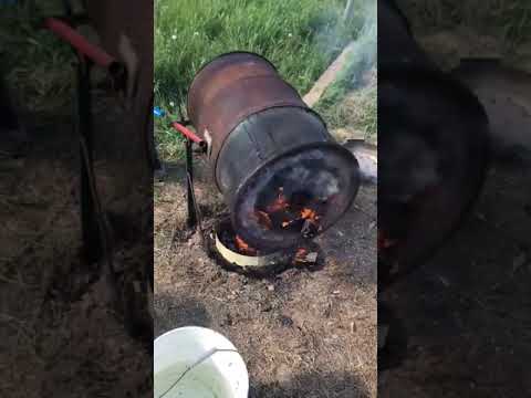

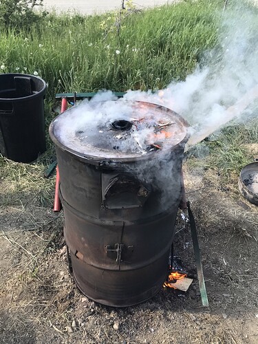

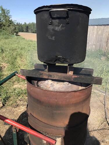

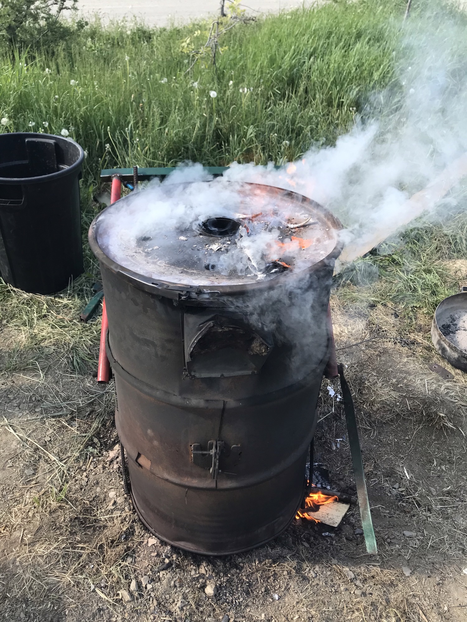

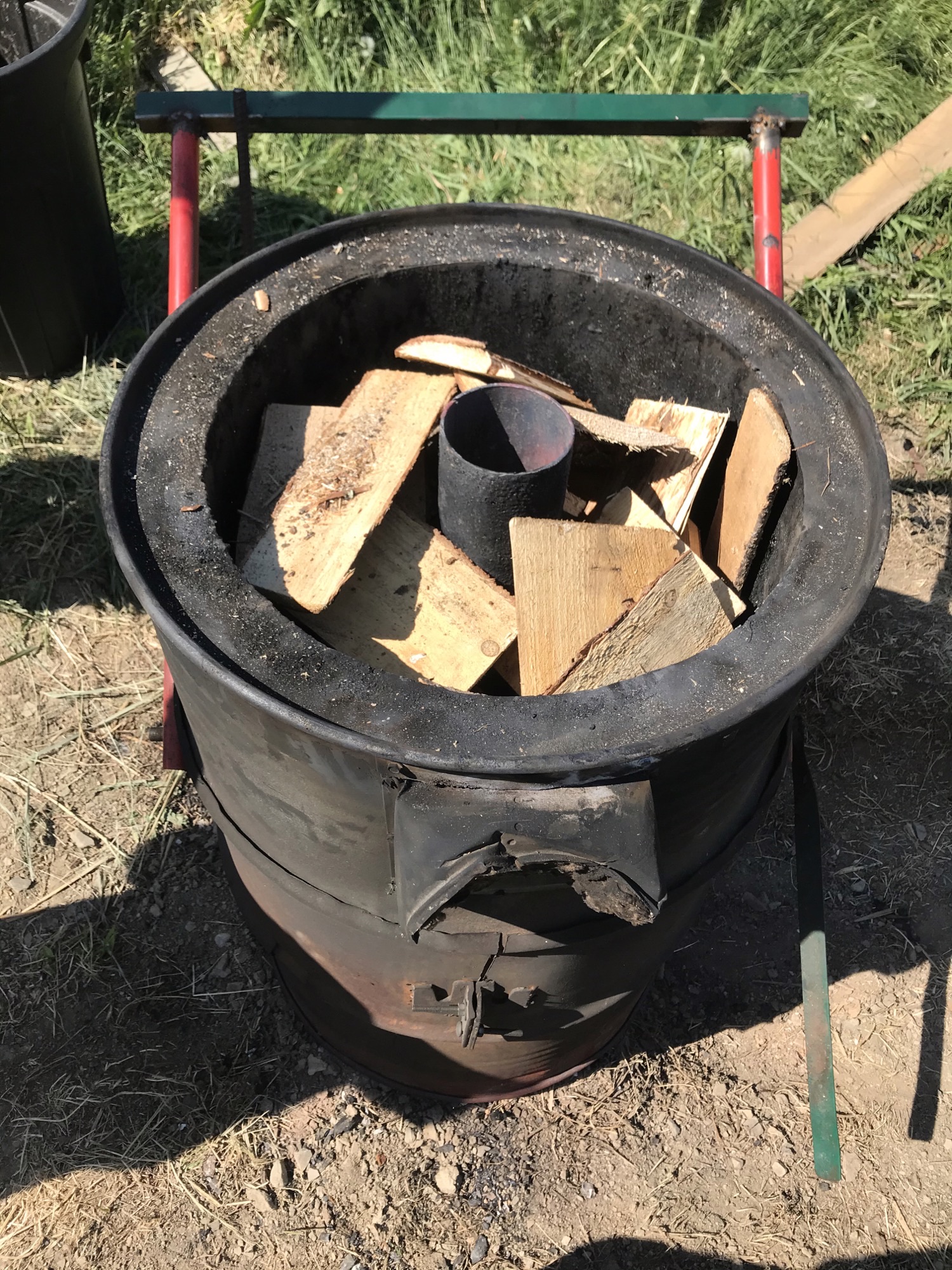

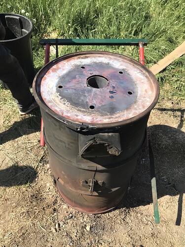

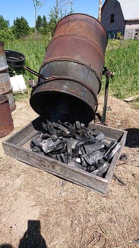

I know that I did not invent anything. I just wanted to show you how I produce charcoal while cooking our pigs’ cereals
Thierry , Québec
Thanks Thierry. More or less what I plan to build. Barrel in barrel to isolate. And take the preheated air from the outer barrel for burning. Thanks, I know now I am on the right path.
the next day, charcoal harvest

Nice looking charcoal you have there.
