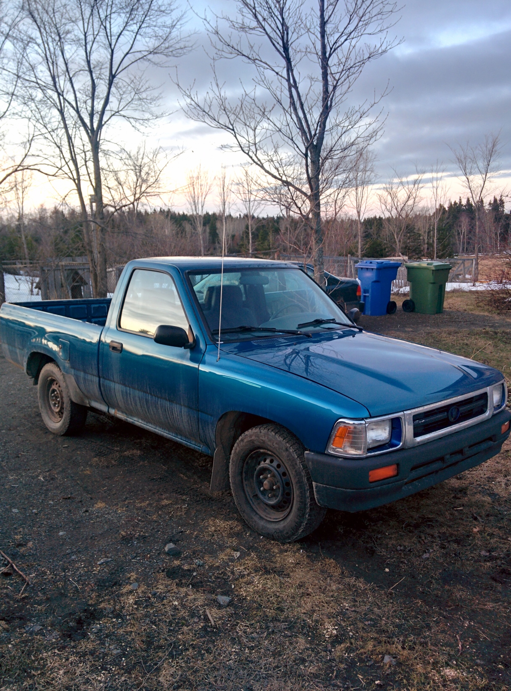

the victim . toyota pickup 1993 2.4 liter 4 cylinder engine 22re

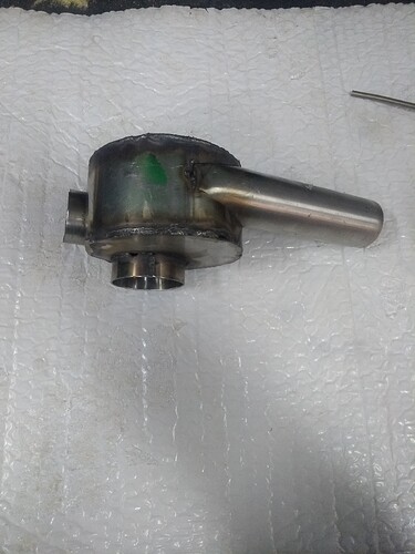

gas air mixer

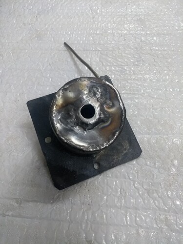

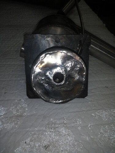

aluminum bath nozzle with integrated hose reel (for water / oil injection)

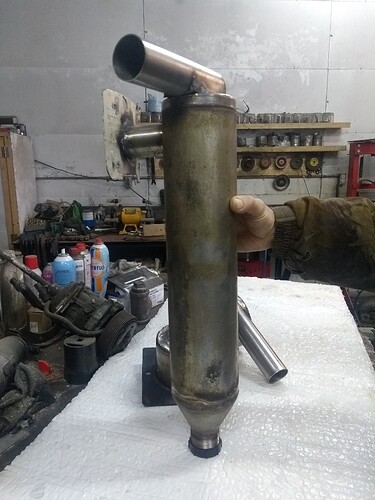

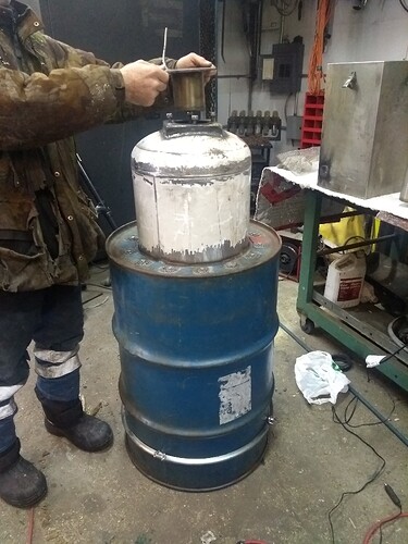

cyclone

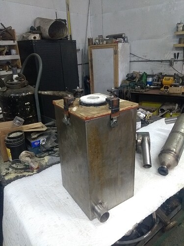

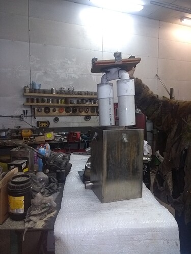

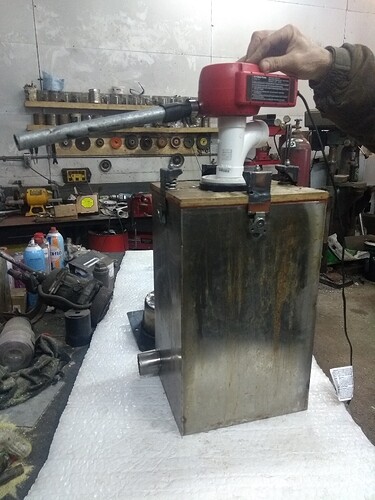

oil bath filter . inspiration from Koen’s filter

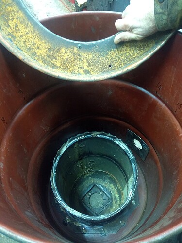

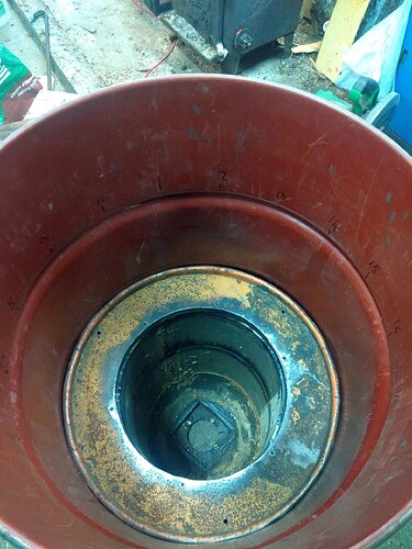

gasifier

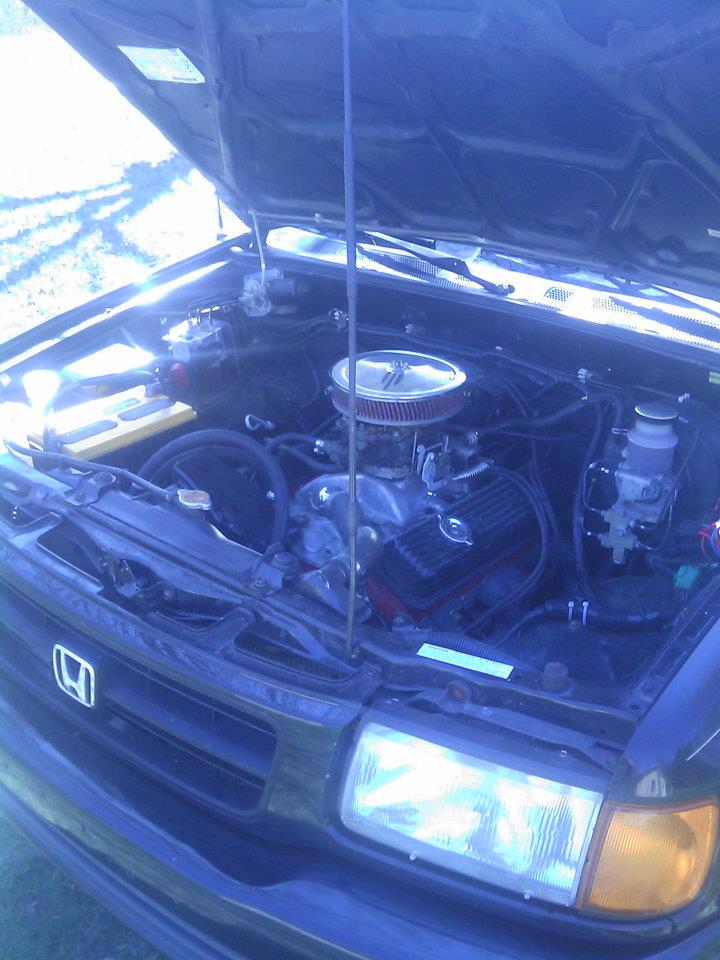

I had a 93 4WD that I stuffed a small block chevy V8 into. I retained the Toyota 5 speed and kept it all stock. That thing was faaaaaassst!!! and also Scaaarrrry!!! lol
my truck is 2 wd
it’s a feat to enter a v8 in this small body
I thinck this truck has, of origin, a good ratio weight power (2.4 liter / 2500lb).
Actually the Chevy small block V8 will fit right in with plenty room to spare. The 4WD vs the 2WD are identical bodies. When I was done with the install that V8 sat in there under the hood looking like it belonged inside there from factory.
There is a company that makes a kit for the Toyota / small block Chevy V8 conversions called Advanced Adapters. It took less than a weekend to install it with the kit.
I later did a Honda Passport V8 conversion that I custom made all the parts for conversion, including an adaptation to mate the stock T case over to a GM 700R4 transmition. The Isuzu V6 used a GM 4L60E; this is basically a modern version of the 700R4 however it had a different bell pattern. But the shaft splines were the same so I just needed an adapter to mate them.
So as you can see I am addicted to stuffing large engines into tiny little trucks!!

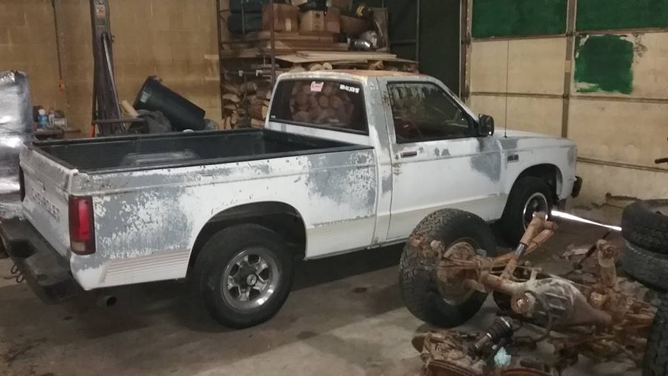

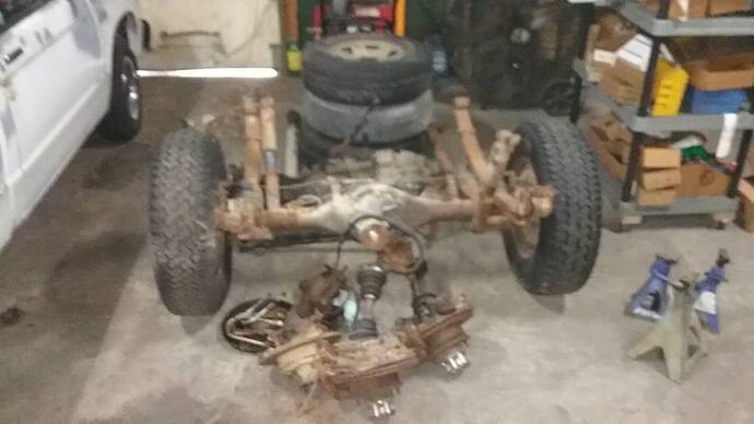

So here is my next endeavor, this is an 89 “S-10” Chevy 2WD pick up. I have a 94 Toyota 4WD drive train complete with axles, 5 speed manual transmission and drive shafts. The front axle however is from an early 80’s so it is a solid axle.
The plan is too graph the Toyota drive train under the S10 and get the trans adapter for mating up a Chevy V8. This time around I do plan on an LS based engine; more than likely the 4.8 ltr for better fuel millage.. It will still have more than enough power to get me in a lot of trouble :slight_smile:
On the Toyota project, I used a 283 CI small block Chevy V8 from a 1966 Chevy Impala SS. I completely rebuilt the engine stock. It was probably pushing around 220 HP. The fuel economy actually went up with the V8. These trucks in the 4WD flavor got around 18 MPG (I dont know what that would be in liters) (In the day that was actually pretty respectable. However with that 283 stuffed under the hood it was getting around 26 MPG on highway and around 22 - 24 MPG in city depending on how much rubber I left behind on the pavement :fire:
