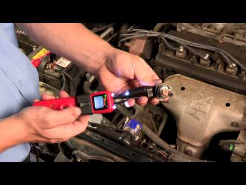

My last active 3 years as a working Master Auto Tech I used a PowerProbe II.
Zoom-zoom; really speeds up a fellow on electrical working.
But critical when + power feeding and/or rocker switch for-sure ground circuit suppling to NOT over amp blow components! Easy to do on a Fancy (Hondaâs) with elaborate in-dash bulb-out driver notifying systems just trying to fix a rear light problem. Can cost you a rear light module assembly.

A seriously under rated tool, mine is the pp3 and I use it ALL the time. Lives in the service truck next to the fluke meter that I rarely use anymore, the power probe can do so much so quickly very versatile
