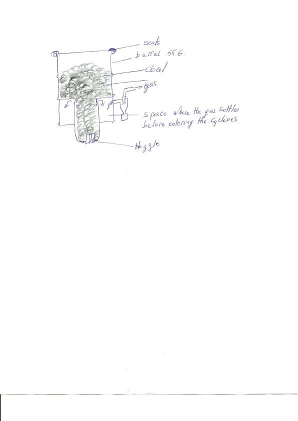

I’m having a little trouble understanding the details of your final system. I looked back at the pictures and discussion above, but I am still missing some info. Perhaps you could describe for us your current nozzle. Is there a screen over the gas exit flange that goes to the cyclones? Is the space between the inner reactor tank and the outer drum filled with charcoal? Any idea of the gas exit temperature to the cyclones once the charcoal level is down in the inner reactor? I’m intrigued by your geometry and assume it is helping to lower the gas temp before it goes to the cyclones.

here are two sketches that should help you understand.
ask me questions if I am not clear
do you think a screen would be better before the gasifier comes out?
I have not yet measured the temperature of the gas at the outlet of the gasifier. I can hold my hand on the cyclone without difficulty

Thanks Thierry for the sketches. I’m pondering.

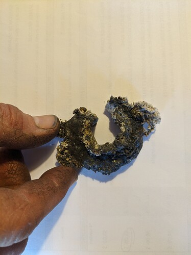

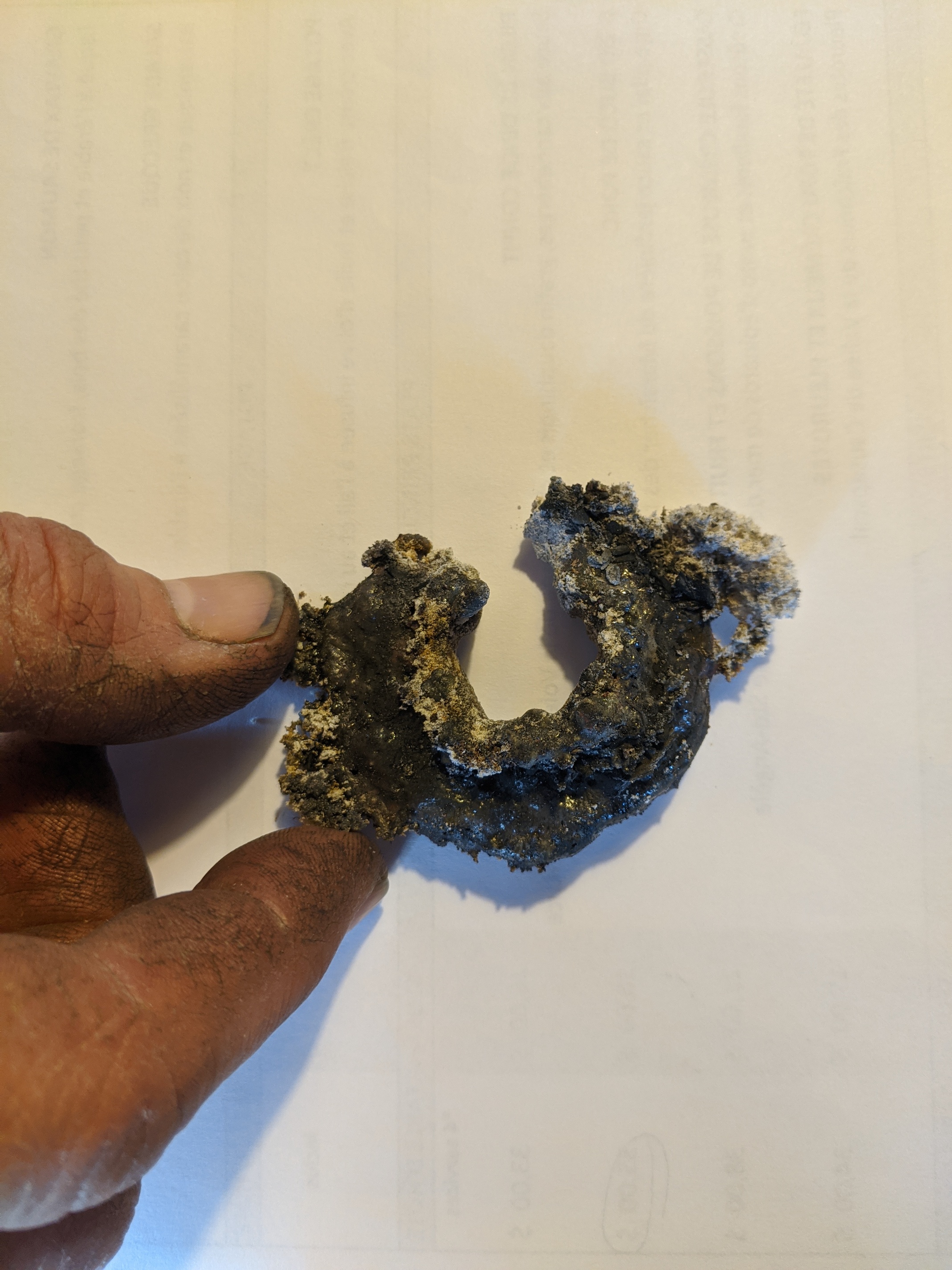

I harvested this vitrified ash cap over my nozzle this morning. I now know that my gasifier can reduce a bit of liquid (water, oil, wood vinegar …). I will test the oil drop by drop tomorrow. :wink:

Thanks so much for the reports! Your system has several novel features that are giving us new options to consider. I can hardly wait to read your experiences as you continue to put more time/miles on it.
