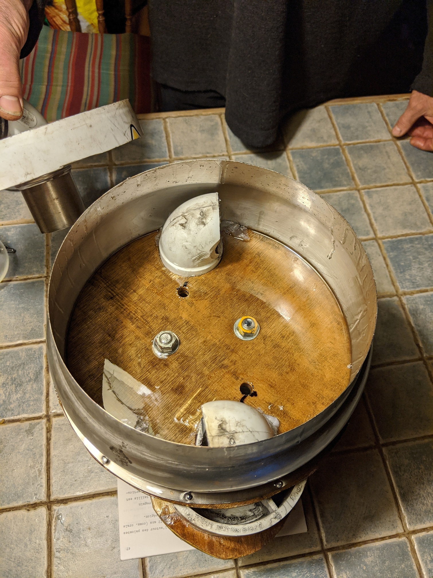

I rebuilt my oil bath filter because it was passing too much oil with the gas
the gas comes from below, dabbles in oil, passes through the steel wool tanpoms
then the gas leaves in a large cyclone before directing it towards the safety filter

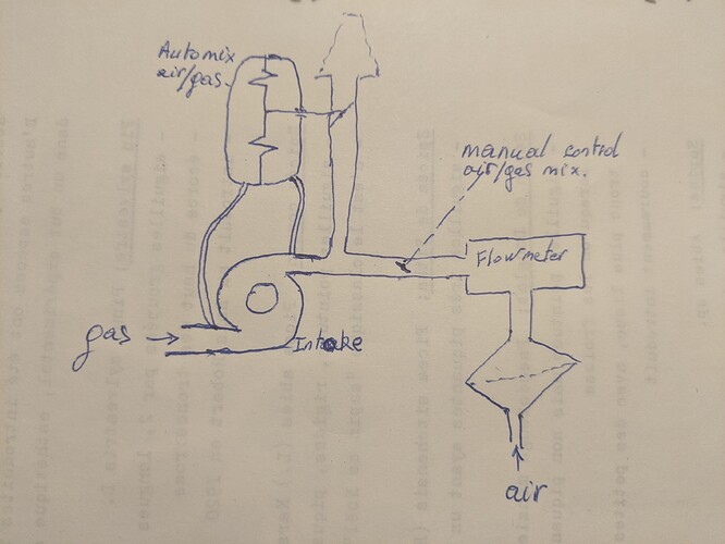

tonight, try to my automix .
the reaction time seems slow can be because of the small section of the pipes which feeds the diaphragm
`https://photos.app.goo.gl/2cmze2m44jd4UX9u5
Thierry
Hi Thierry, I looked at your video of the auto mixer reaction. It seems to be working the same as mine. When driving down the road the valve does not have to move quickly. It actually moves very little and slowly.
I hooked a live video camera up to mine valve and watched it operating and the air adjustment was hardly noticeable at times. You should be good to go.

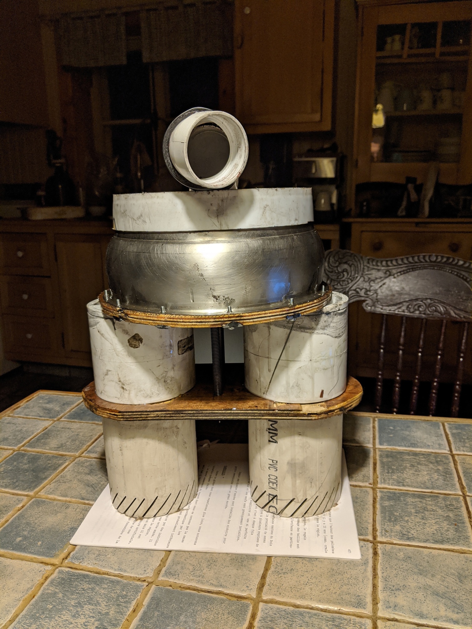

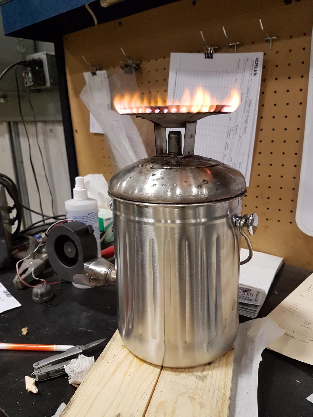

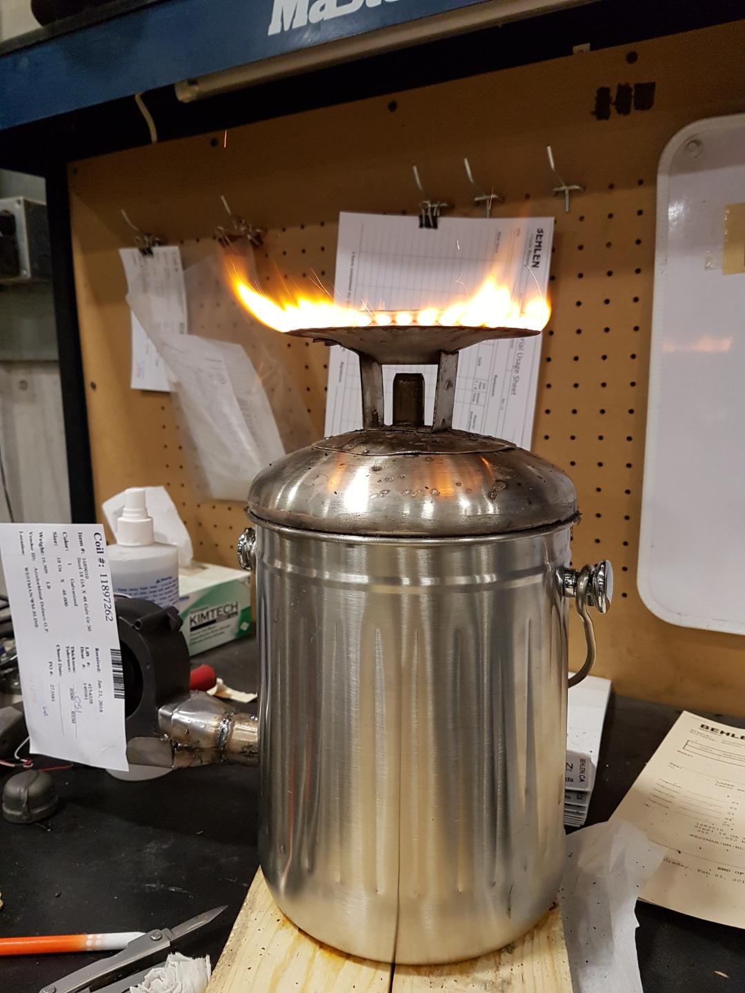

Here is one I made a few years ago out of a gas water heater burner mounted on a cut off pressure cooker and fastened to a propane tank with a computer fan blowing thru a ceramic nozzle. I used fine charcoal that fell thru a 1/4 inch screen.
I copied the idea, used a bit coarser charcoal, finer would work better no doubt.
Sorry for the poor flame in the first pic, I think it was bridging at that moment.

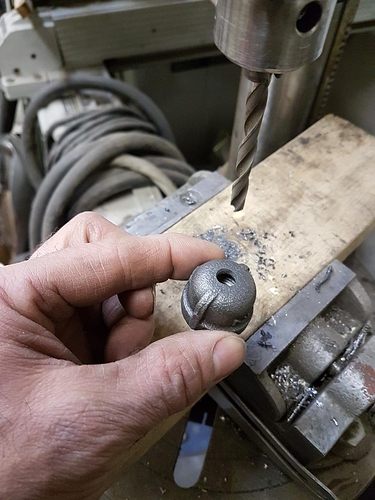

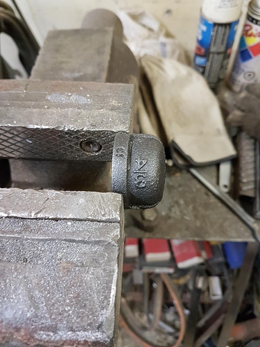

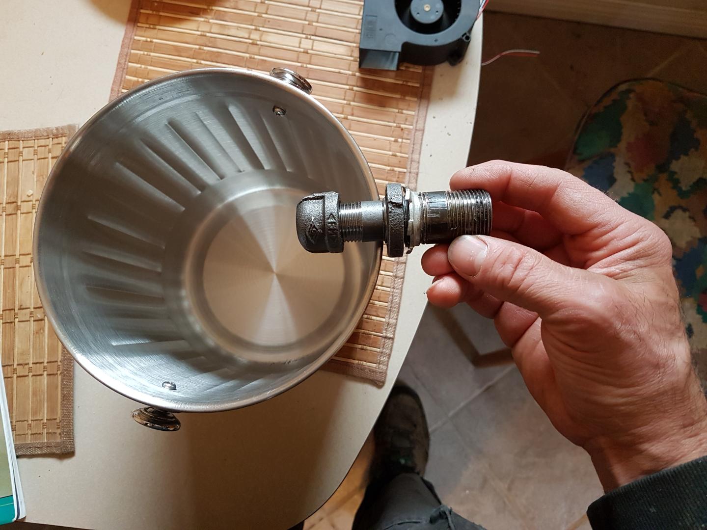

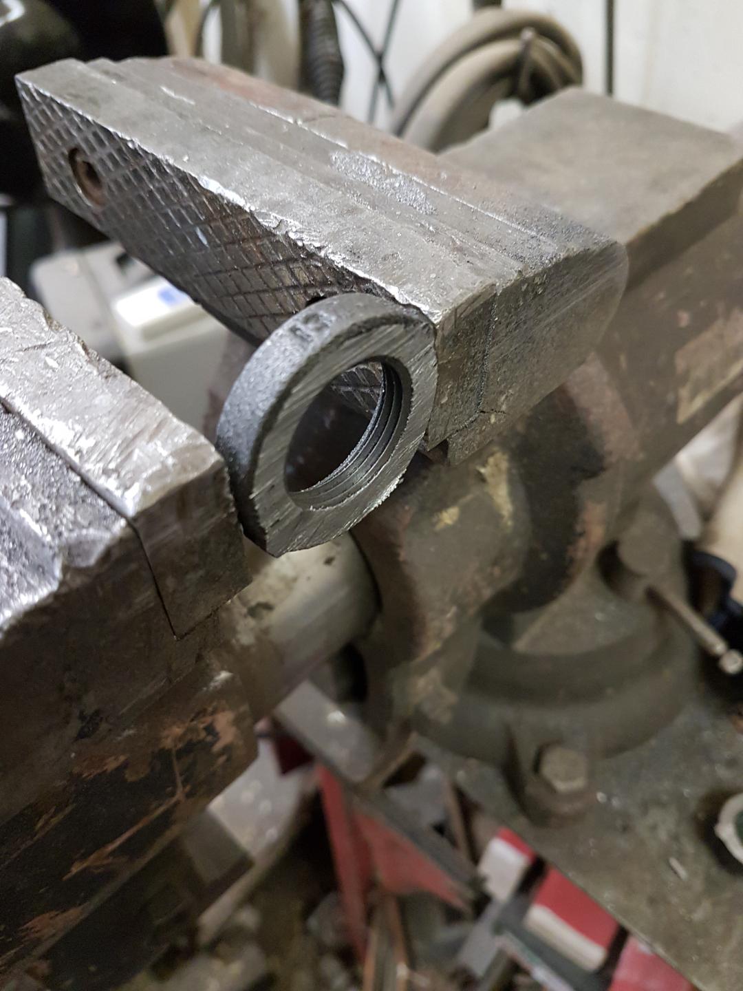

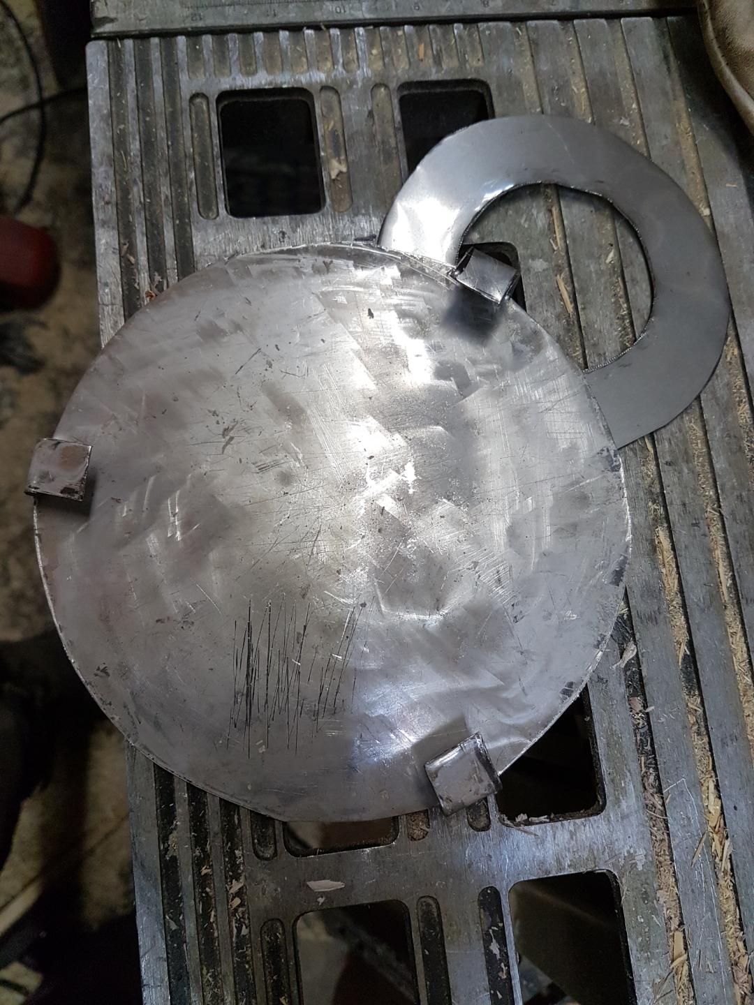

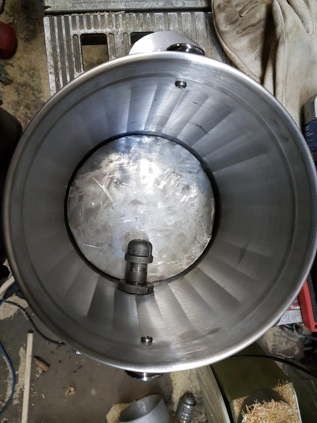

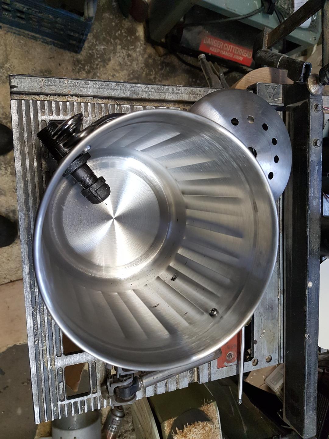

I can describe my build. I used a stainless steel kitchen waste bin from Walmart. My idea was to make something suitable for camping in fire ban zones.
Fairly simple nozzle construction, 1/4" hole in a cap, stainless 1/2" spacer to keep bottom from getting too hot.
Larry, I used an old pressure cooker with the bottom cut off because the top could twist off for easy filling and clean out. The nozzle is near the bottom like Garry shows above. Charcoal already has the tar cooked out of it so no worries there. Woodgas does not have the btu’s like propane or natural gas so don’t expect the kind of heat that the burner was designed for.
Larry; Put a lid on the pot and you will have a better chance of boiling water. TomC
