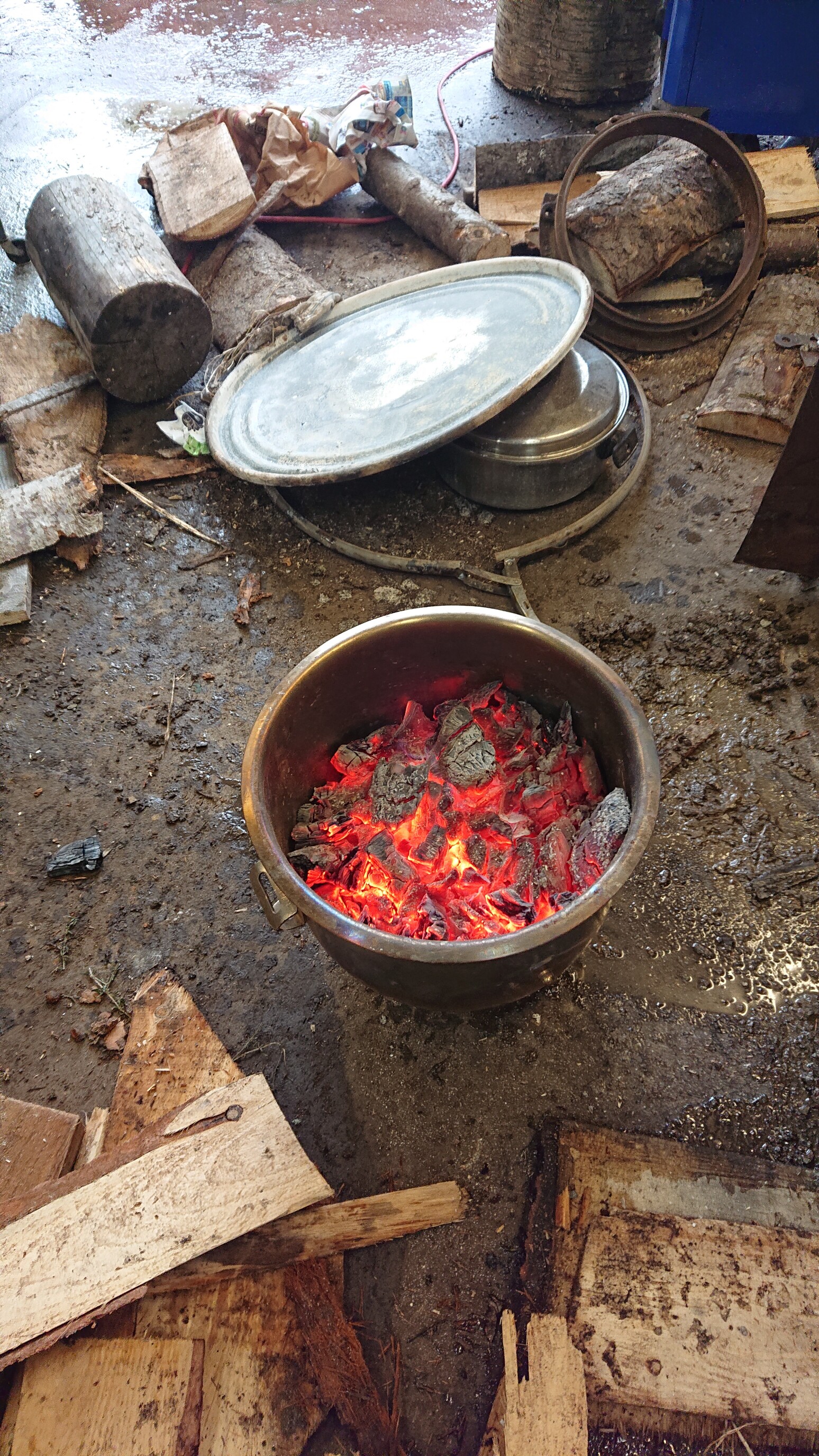

I have wet charcoal (I live in a very humid climate) which generates a lot of water vapor in the gas.
I would like to test an ejector (venturi) on the air line that feeds the nozzle of my gasifier. I hope to capture some of the water vapor that is released in the hopper before it leaves the gasifier and dilutes the gas. do you think this design could work

Hi Thierry, if you could make the venturi work, circulating the gases into the condensation pot. There is still one big problem, you will suck up H2O vapor true, but you will also be sucking up wood gas vapor with it and reintroducing it into the venturi and mixing it with fresh air through the venturi, now you a very explosive mix. It goes back into the hot charcoal zone. KA-BOOM is what I thing will happen, or if not you will have a furnace affect in the venturi.
now that you explain it, it seems obvious to me … how neither did I not think of it alone!

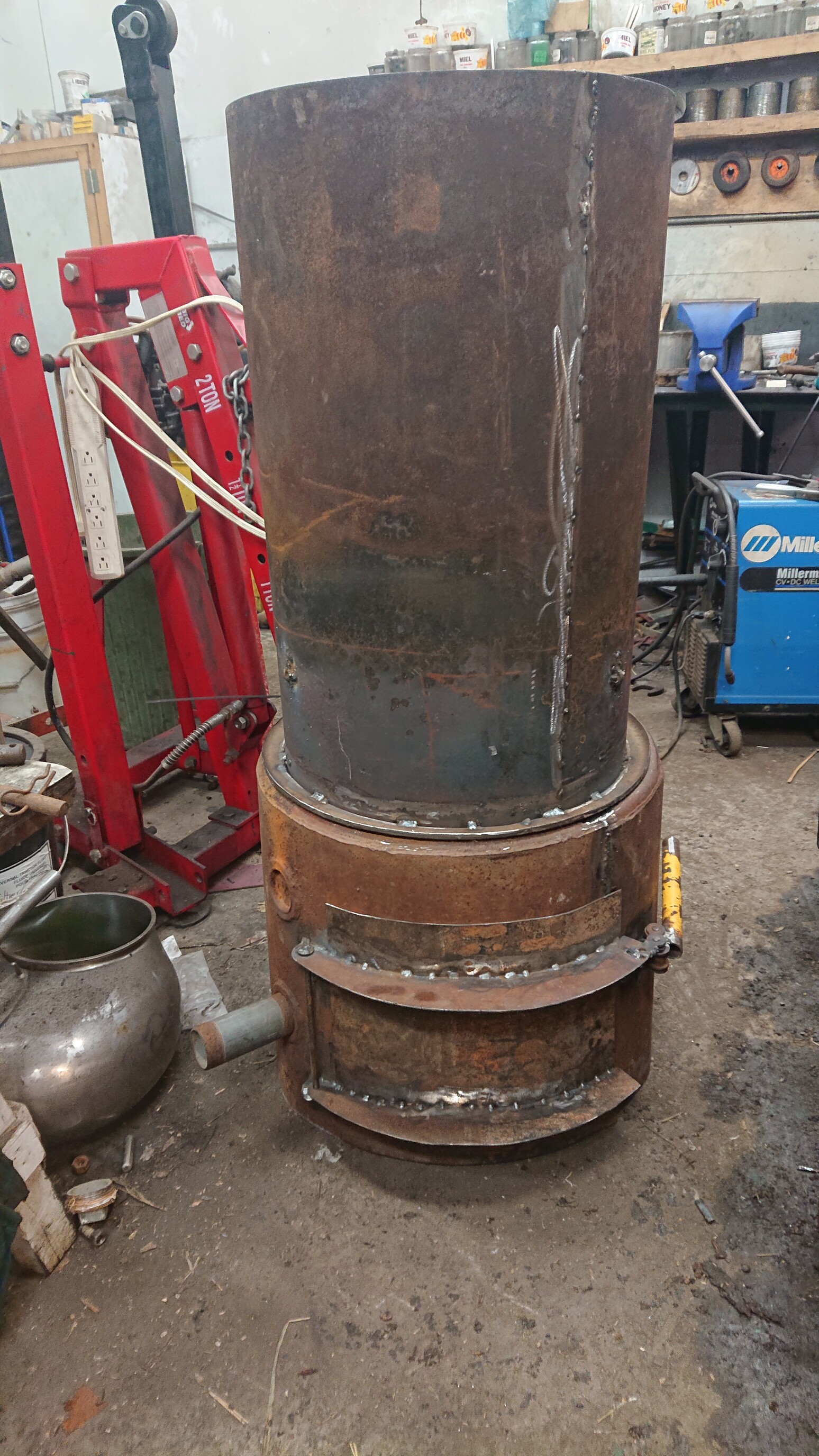

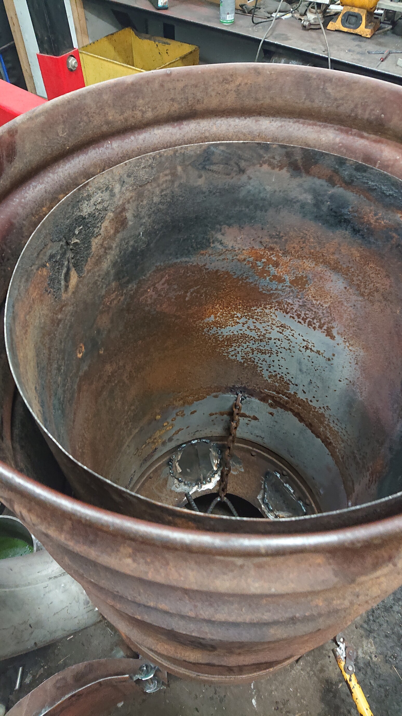

Hi Kristijan , would you be able to spare a moment to go over a few thoughts i am having , i have toyed with the idea of trying a downdraft charcoal systems for ages now .
Our fire season is about to start and so i thought now might be a good time to start looking into it , what do you think the minimum distance would have to be between the inlet nozzle to gas outlet pipe and also would you use a restriction at all or just as you have said turn a updraft into a downdraft by turning it upside down ?

Yes i did build one in the mean time and tried it a few times as well , but with very weak gas it would not get the generator to near the power output of the updraft unit i normally use .
I have got to get a hold of another same size drum so i can join the 2 together and increase the distance the gas has to travel through the charcoal, as i think there should be at least 12/14 inches between inlet and outlet pipes with enough charcoal between them to allow for the gas to convert and cool down , just the same as in a updraft is how my mind is looking at it and if it works one way why not the other .
By the way i have no restriction on this attempt at a downdraft ,
I am not sure how you mean by the " gasses bypassing the glow zone " you see in my head i can see the hot Lobe of the charcoal being caused by the suction from below and so i cannot see in my head how once gasses are produced if they are on the edge of the Lobe why they will not be drawn straight down and into the filters ect , in the same way as a updraft works .

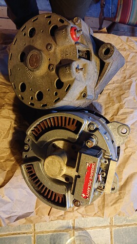

I collect parts to build a 12 volt generator from an alternator and a small motor powered by the chargas
I have 2 beautiful alternators. The one on the left in the photo was on a 1971 F-350 diesel 7.3 l (I believe this alternator has no regulator). The one on the right seems to be a leece-neville with a “transpo L77373HD” regulator.
Could one of these alternators be a good candidate for my project?

Hello Thierry
The Motocraft one has no voltage regulator and would use external regulation.
It IS very much an internally grounded alternator for negative grounded systems only.
The field terminal is fed positive current. The other contact brush is internally grounded negative to the case. The brushes accessible only by splitting the cases and inboard of the rear needle sleeve bearing.
The Leece Neville is an insulated alternator. Can be ran negative or positive grounded system.
It has a piggy back voltage regulator on it now. Fed power by a field diode trio
Easy to remove the regulator and convert to externally regulated with a two isolated terminal plate and two jumper leads.
Brushes externally accessible to the out board of the rear ball bearing.
A truck/marine and industrial alternator. Parts might be more than the Motocraft.
More important is drive shaft sizing and pulley availability.
The Mototcraft is a true 17mm shaft.
The Lecce Neville should be a true larger 7/8 inch shaft. Those pulleys cost.
