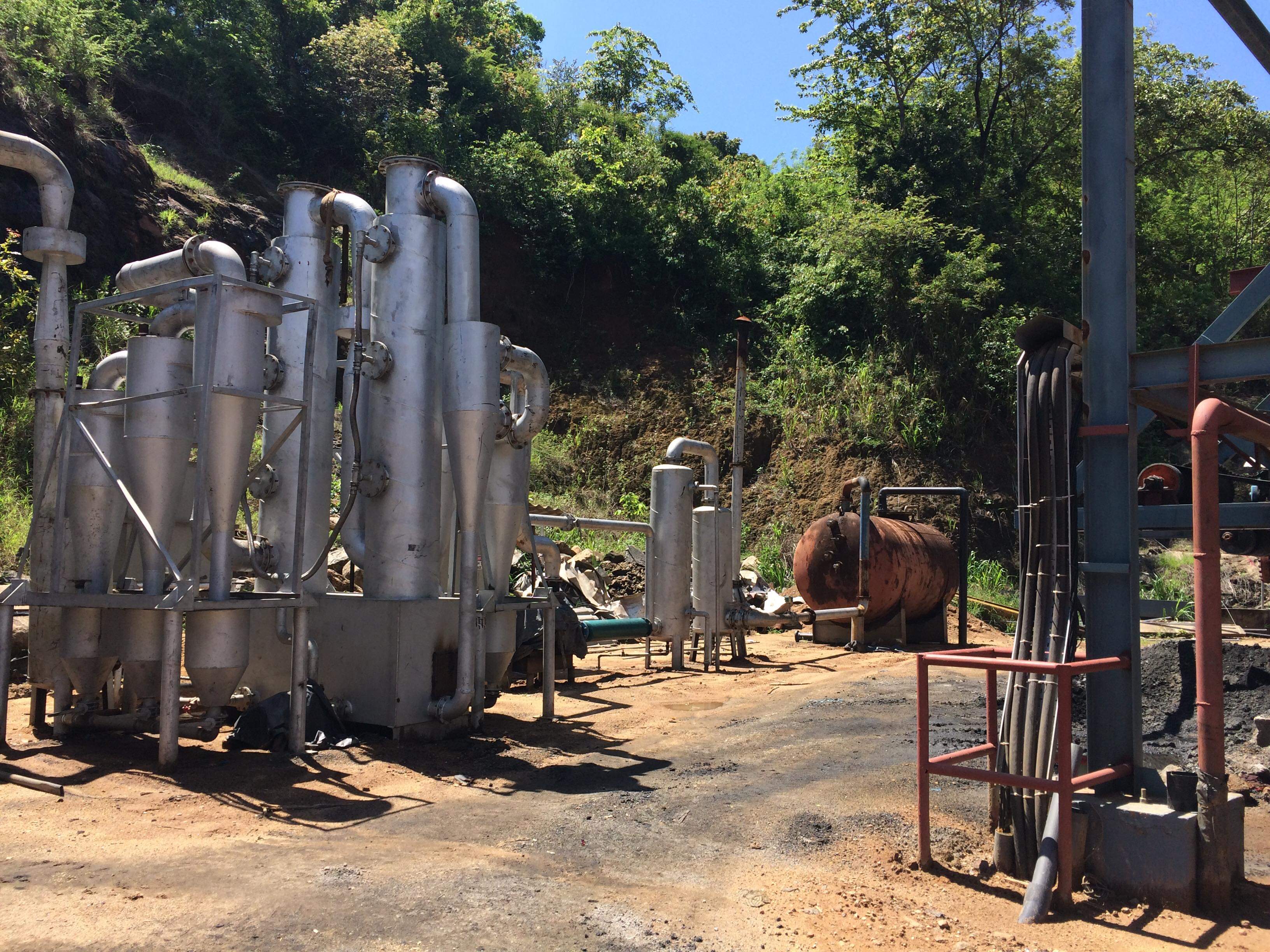

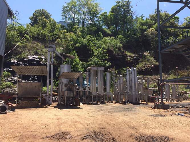

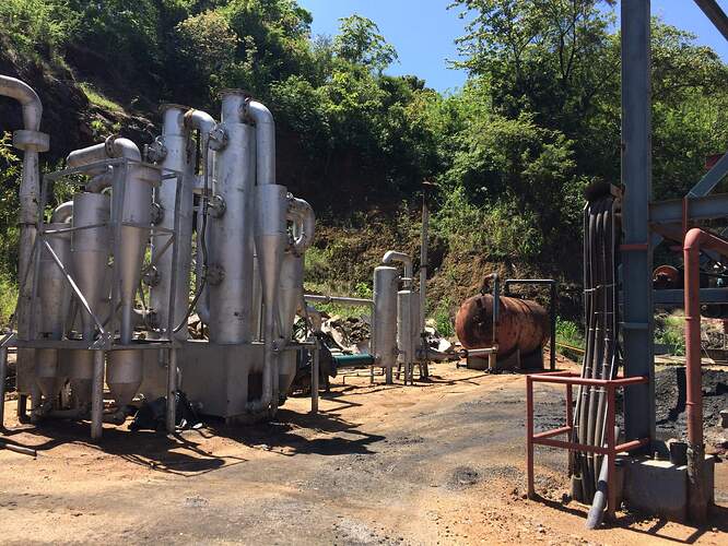

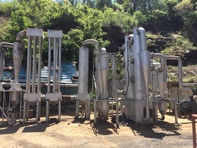

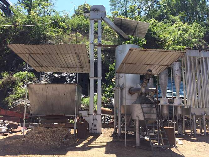

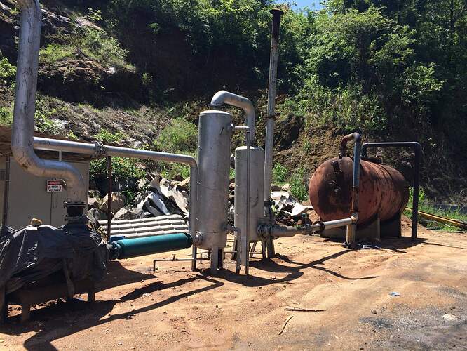

Hi Guys,
I purchased a Dead gassifer plant recently with a 400Kw engine. The system was corroded and demaged we spend a quiet a good time repairing the system. When fired the gassifer produces good smoke and when the smoke is lighted it produces a good blue flame but the happiness doesn’t last long the flame dies 20 mins of operation. Then white smoke comes out of the chimney and the system heat goes way up.
Any advices from you guys are appriciated

The system doesnt have a vibrator to shake the grate. The ash moves to the screw through gravity. But ash never comes out though the screw.
question /
is there a lid on top of the gasifier ?.

holy mother of all filtration systems… I am sure you get really clean gas with that.

Gas is clean but we are getting alot of water, tar and mosture in the gas And we cannot keep the flame constant. I will design a stir device and keep you posted
That filtration system should be taking all of the tar out. it is massive with multiple cyclones.
