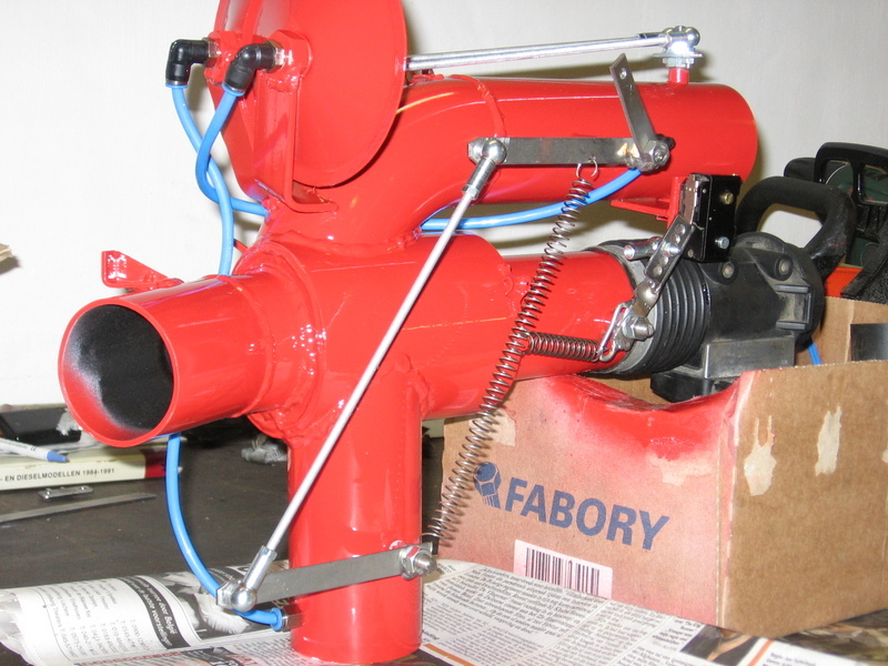

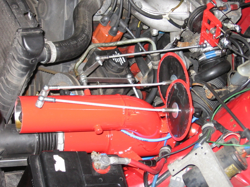

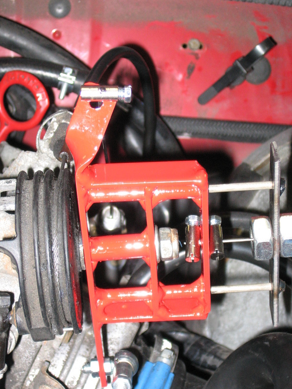

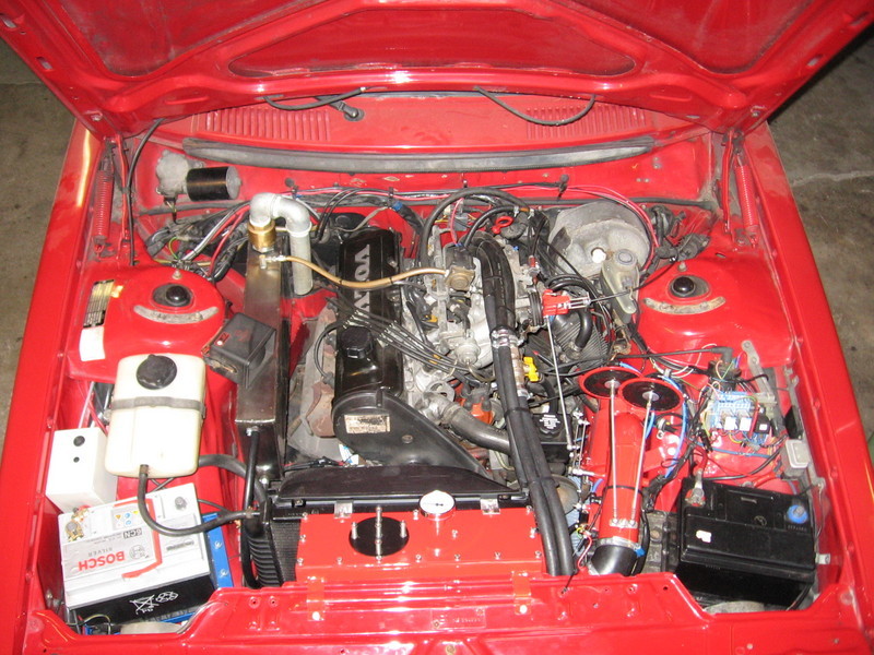

In 2015 some people here made a mechanical mixing device that seems to work very well.

Hello, r_wesseling!
I’ve already looked at it once, but only briefly. It will be necessary to return to this topic, to understand the essence of regulation. Thanks for the reminder!
