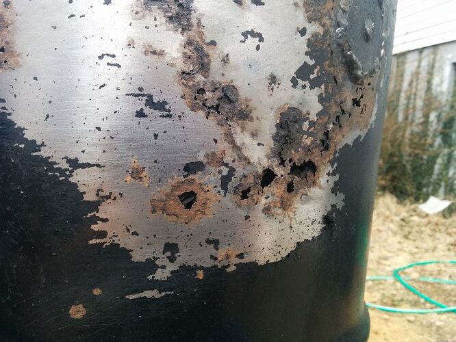

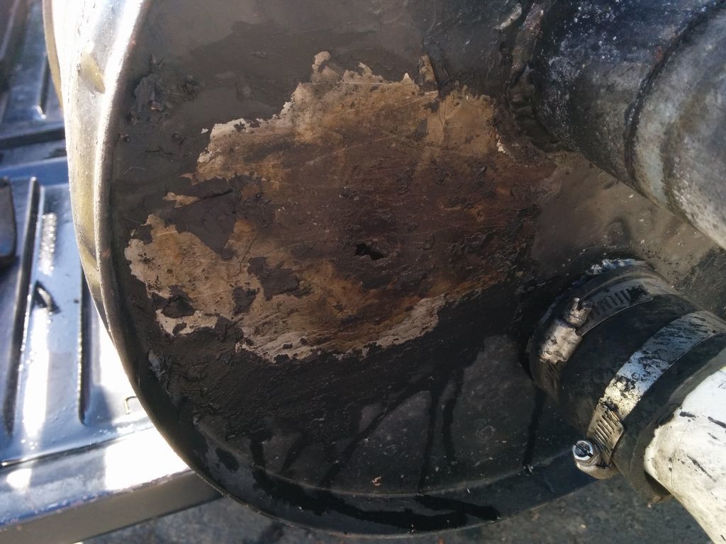

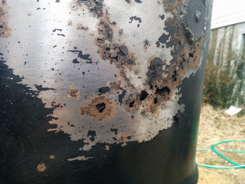

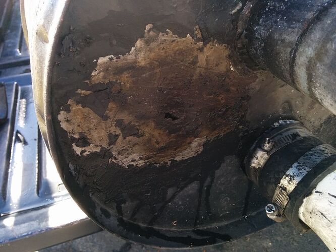

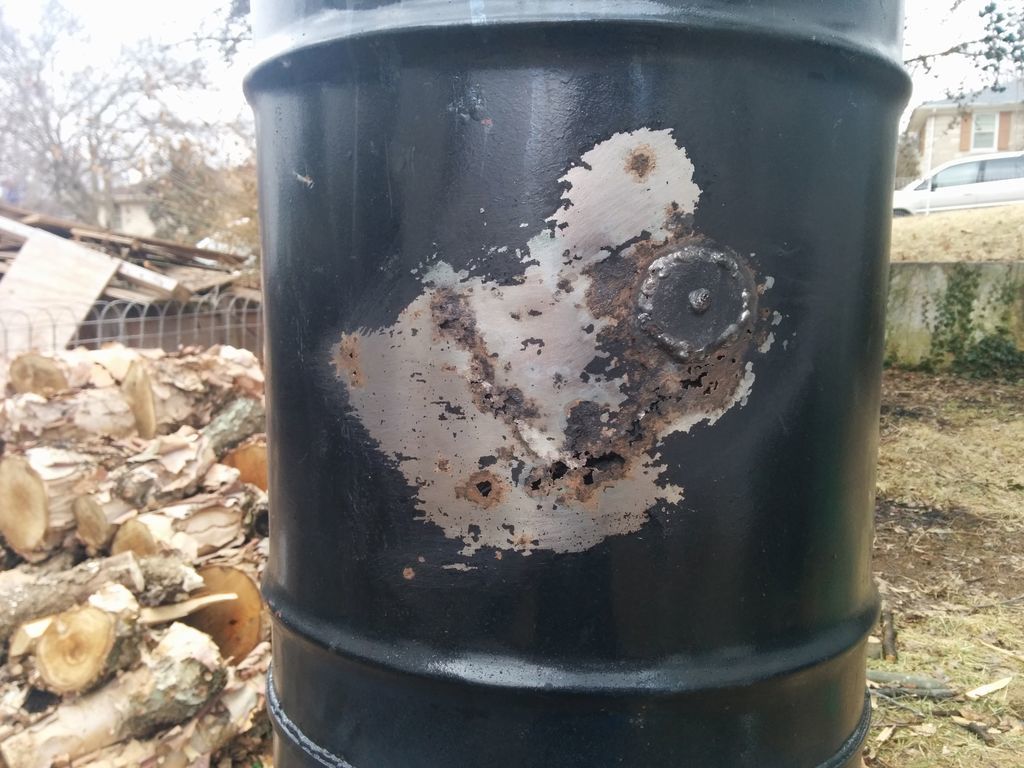

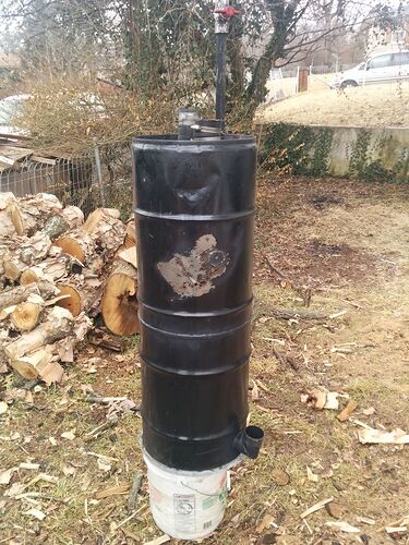

Here are some pictures of my hay filter. You can see the issue…
Cheap paint?
OK, so why is this in the “what not to do”? Because I think we’re about to find out why these thin drums are a very bad idea. They are light, sure, and moderately easy to build. But particularly here, in the always-wet hay filter, I don’t think they will last much more than 18-24 months
What else can be done here? Thicker metal would last longer, but will eventually rust just the same. Still, I would recommend using a water heater over these thin drums.
Pesonally, I’m planning to experiment with plastic. I think the temperatures are fine, corrosion is a non-issue, and it should last indefinitely, if taken care of.

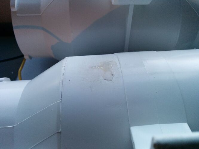

I plan to stack them up and weld them together. Adding fittings will be a challenge, but not impossible. Plastic welding is actually quite easy. Here’s the kit I got:
Plastic welding can be useful on other areas of the gasifier, I’m pretty sure. For instance, instead of taping over those wiring holes on the blowers, I plan to weld them shut, and redrill smaller holes if needed.
Pete, these rusted from the inside out. I scraped off the paint to reveal the holes (it looked pretty good until I did that!)
Chris , Thanks for waving the red flag. Maybe if the inside could have be coated with some type of corrosive resistance material they may have lasted longer . I think I will opt for the plastic or the thicker water heater tanks .
I just checked the date when the thin drums were installed ( mid April 2012 ) and the life was less than two years .

According to my New Micrometer those metal drums are .025 inch .
Also the thin piping was .039 inch .
My hay filter is galvanized inside and out, 12" dust blower pipe. 14 months, 15,000 miles. I pecked on it today, but don’t feel any thin spots.
Sorry Chris. I was just being a smart a**. I actually thought it had caught on fire and burned the paint off. Epoxy paint maybe?

DRY DRY DRY … I still use hay for a filter but it has to be dry !!! If you mix water, woodgas, hay, soot etc etc you get ACID and things corrode quickly. I made the mistake a couple of times of trying to flush a filter with a hose. Sure it got clean but it never dried out after that. It all depends on where you are at. We haven’t been above freezing for months and barely above zero for weeks. I am still walking on 1.5 feet of solid ice here … Go to thicker metal on all components. oil drums are too thin to use here. put a plug in the filter base to drain off any condensate that may collect in it … Well, whatever … With frozen toes, Mike

Mike is right, damp/wet hay will make acids. But this wet filter is more effective than dry hay (just ask Henry Austin)… being a large surface area it wil condense some moisture no matter what you do, so I’m not sure how it could stay “dry” completely. You’d have to have all the moisture condensed prior (only very cold weather can do this). Ironically this is how Henry found out about dry hay - cold weather, no moisture made it to the hay filter, hay plugged with soot.
Steve and Mike, spot on with the location thing… Cold climates need to minimize wet filters because anything wet will freeze. For Wayne and anyone in southern areas, the damp hay works pretty well.
DRY HAY! My hay is anything but dry, I thought that was the whole idea of how the hay filter worked, water worked it’s way up the hay as you drove and kind of rained back down washing the crap down as it went. How would dry hay do any filtering at all? I know on mine I have water in the bottom of both of the hay filters until I pull the plugs. I have 1" hoses on them about 18" long, after a hopper of wood they are full and ready to be drained! That is why I was wondering how water soluable oil like they use with steam engines would work on the walls to keep from rusting and help with cleaning gas. herb

Also it seems the inside of some hot water tanks has a coating that will help with longevity . I now have about three years on some hot water tanks as hay filter and heat exchager and they seem to be holding well.
The very thin ( .025 inch ) drums with only a paint coating doesn’t stand the test of time.
