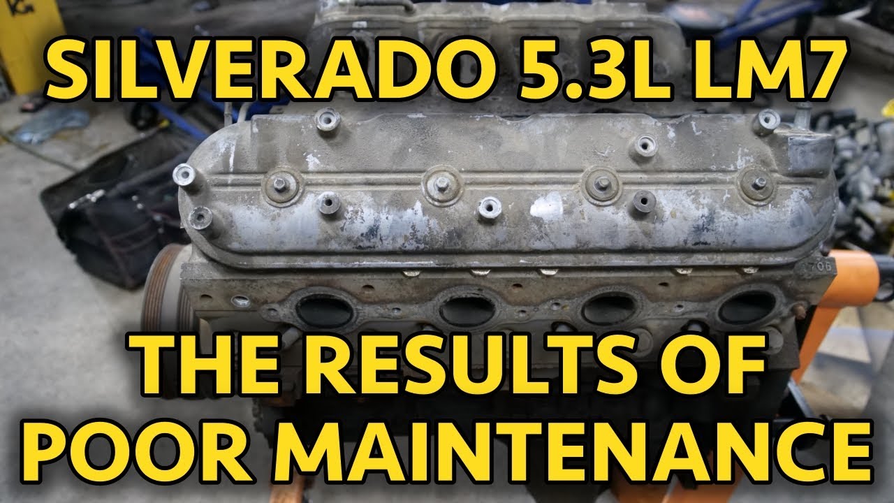

Here is a video of this engine family as a worst case showing the cam-in-block and short timing chain:
Yuk! Anything touched inside will break loose clogging crap. Dangerous to do any covers off repairs on any engine this badly sludged up.
No. This one does not have the end of camshaft advancing-retarding mechanisms, sensor trigger wheel, and sensor. The solenoid valve and actuator will be just more tiny orifices to get clogged up.
His channel has lot of videos of 6.0L and 6.2L too.
