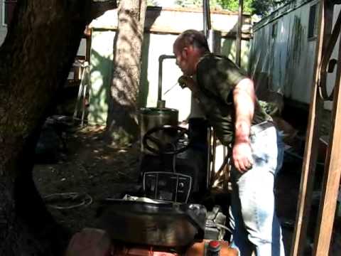

As long as it’s spark ignited and able to pull a vacuum I’m sure it’s possible. Here is a link to see the old Maytag engine running off of woodgas

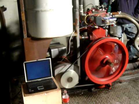

And a old Lister Petter diesel with a spark plug conversion.
That Lister is a stout generator set when they are ran on diesel or vegetable oil. Not sure if they can produce well on woodgas. A hit miss engine should take woodgas well. Older oil well engines where usually ran off of natural gas anyhow.

The Maytag also runs like a hit&miss engine. But in the video, it is firing more regularly than it would have without a load if it was on gasoline.

I don’t think the Lister(oid) is a hit&miss engine.
Pete Stanaitis
As far as I know those old lister motors are low speed high torque diesel motors most peak at about 600 rpm. I looked at getting one for a tractor but never came across one that fit for a reasonable price. They will run forever.

That little Maytag is not a hit and miss. It is a 2 cycle engine. Stop the video when the close up of the engine shows and take a look at the spark plug area. There are no valves at the top end. Then look where he hooks up the woodgas hose. It is at the carb that feeds into the crankcase.
I have one of those old Maytag’s and Pete is correct they normally turn several revs without fire between each fire with no load. For it to fire every time, it must be losing a lot of power. Also, those are two stroke, so if he doesn’t put some oil mist in there, his experiments won’t be going on for long.
