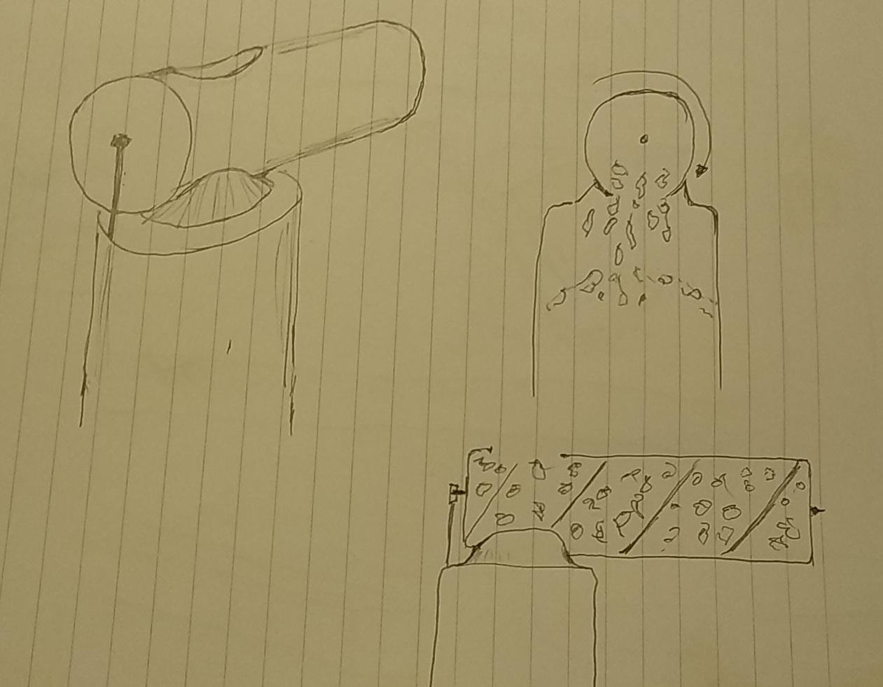

Hi Jakob, I’m also thinking about automatic refueling, I have some ideas maybe one, … a rotating cylinder that fits snugly on the opening, inside a shallow helical spiral welded to the cylinder that moves the fuel. Filling is done by pouring fuel through the opening and turning the cylinder to the left, the spiral moves it forward, filling it again and turning it, ..
Discharge while driving, turn the cylinder to the right, the fuel is poured into the reactor and then forward to close the opening in the reactor :thinking:
