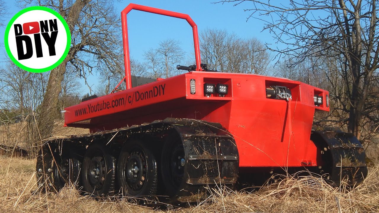

Wet your track whistle with these builds Tom, exactly why I plan to keep around some extra conveyor belt from work, tracks make everything better :grin:
Is this where you were going with the first run V-Twin engine Marcus?
Was meant to be a link to the full playlist, not sure why it posted that way but yes haha
That’s the build I was talking about. The tracks are real similar to Jan’s. That was a ton of work.
Super repetitious that’s for sure, but what a cool way to diy a set of tracks for whatever needs you have. I keep contemplating a half track conversion and charcoal gassifier for my riding mower so I can push clear the snow in winter in the driveway

I’m still loving that thing Jan. If I live to 80 I may get one done. I may start building a set of tracks in my spare time.
