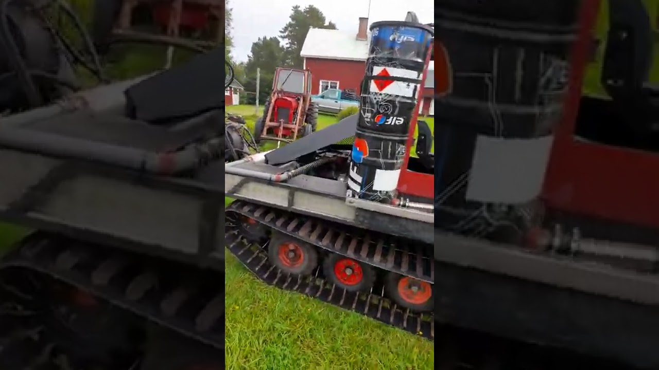

No, I’m rarely above 2000rpm, and I’m loading and unloading at about 1500-1700rpm for longer periods of time.
I’ve tested at idle about 800-1000rpm, for 30-40 minutes, with 85mm, it went very well, but that’s the only thing I’ve driven

I was out and drove a bit with the iller on gengas today, there is no big difference between gengas or petrol, strangely enough, could be due to the 85mm restriction and the fact that the filter does not give any resistance yet.
Tried to run the crane and it also seems to work, I usually have higher revs than I have now in the forest, but think it works well.

Hi Steve, I think it’s around 1500 rpm after the instrument, could be the hydrual pump you hear.

How about heat? You mentioned earlier you may be a bit low on cooling area. Sitting stationary there’s no breeze cooling the pipes. Shouldn’t be too much work adding to the pipes if necessary though.

I’m starting to regret not taking this one to Chevan instead, think this one is better, but like I said, I haven’t tested much yet.
However, I think it’s strange that I don’t lose that much.

Thanks, but now the next question arises, why does this seem to lose so little compared to the one I have on the Chevan?
What is the difference?
Jan, litle differences in engine characteristics mean the world of a difference in the world of woodgas it seems. Our American friends have a saying, “there is no replacement for displacement”. But l have learned with woodgas thats not nessesery the case. Those are quite low compression engines for one.
When l increased the compression ratio on my Škoda from 8 or 9 stock to about 11 or 12, l gained probably about a third more power on woodgas. An incredible difference.
I think the compression is around 9 kg on both the v4 and the Chevan, but I have slightly different measurements on the unit for the v4, and then it probably breathes much easier.

Jan, this equipment fits your machine nicely, congratulations, the real power of the engine will show itself when the load is fully loaded and when driving uphill, but it is very good that it works well for you even with a light load, when working with a lift, usually not much power is needed, maybe 5-10 HP… …
Jan perhaps the engine feels the same strength because the V4 was overbuilt for the machine to prevent wearing it out? If you have an excess of power but little demand you never need the full strength.
