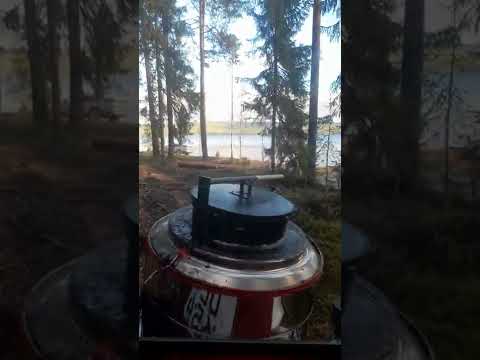

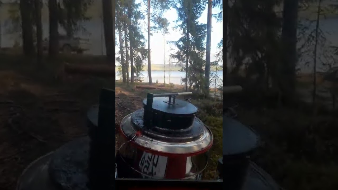

It wasn’t the wood I was thinking about in the middle of the forest, it was that I didn’t have enough electricity for a bigger spot, as Cody suggested.
I have firewood for Illern at home, but I didn’t take more than 2 sacks out to the forest, and Illern ate a little more before I had finished driving.
Don’t know if I showed these, but it was before the Illern broke again.
