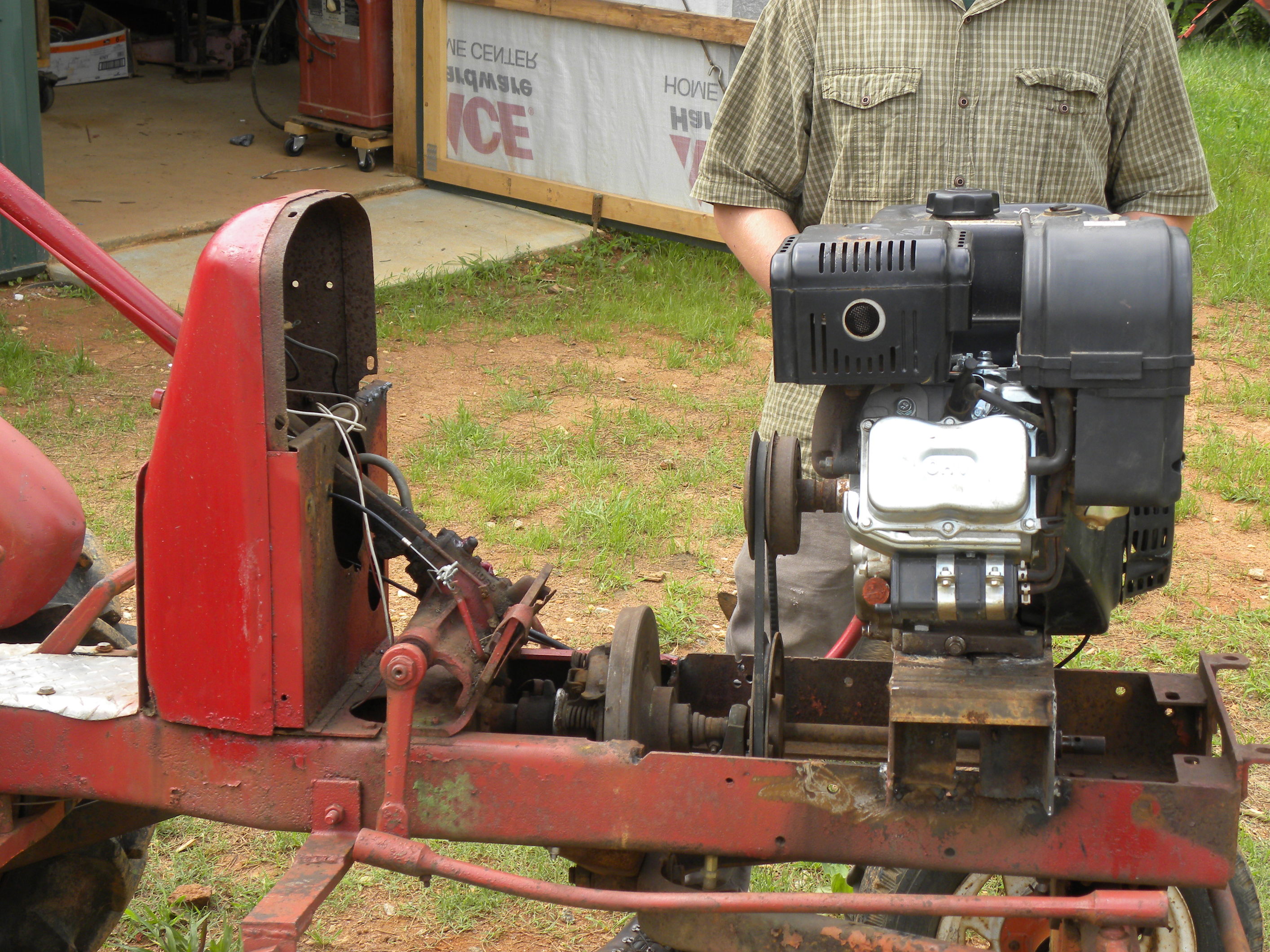

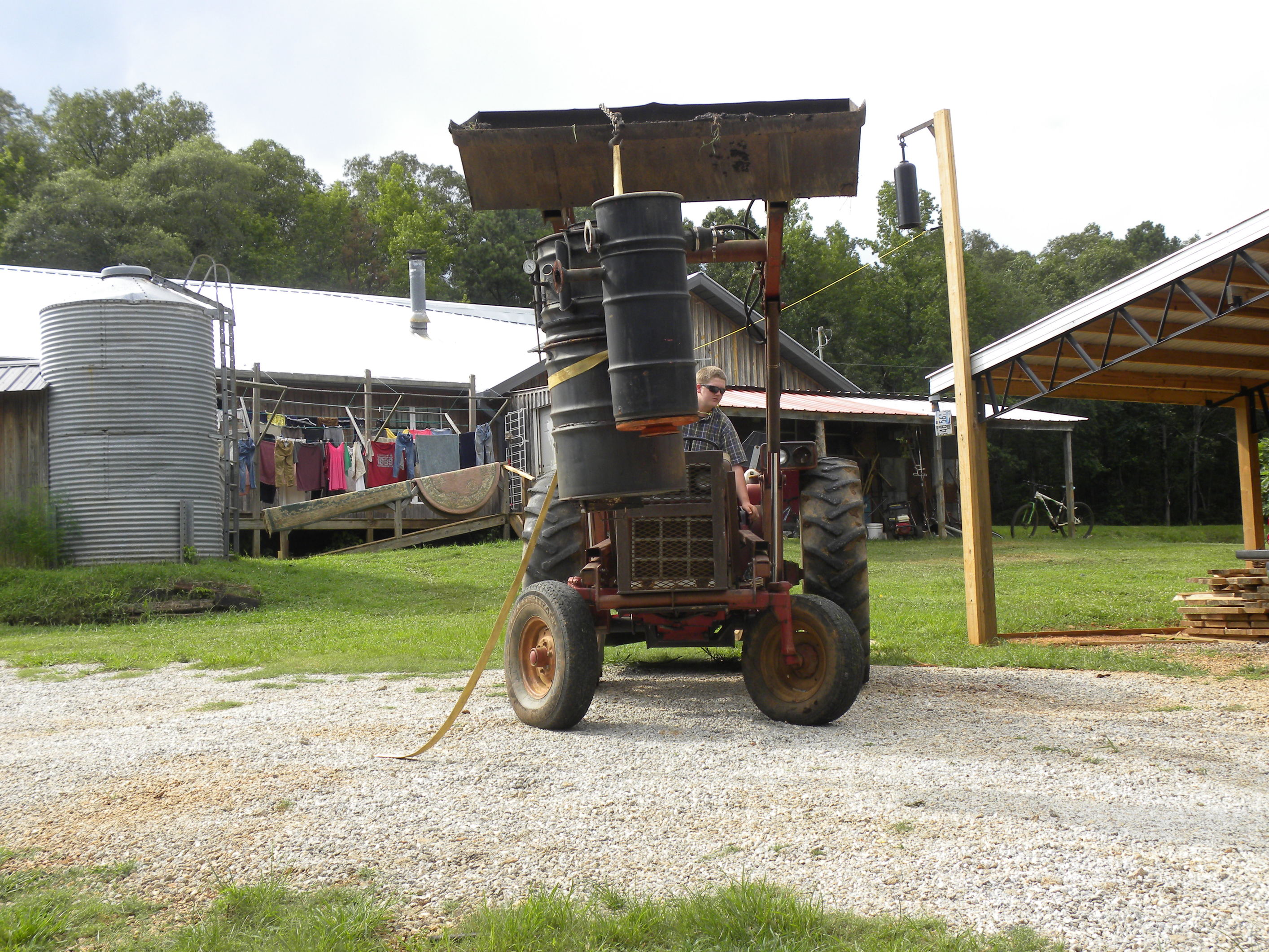

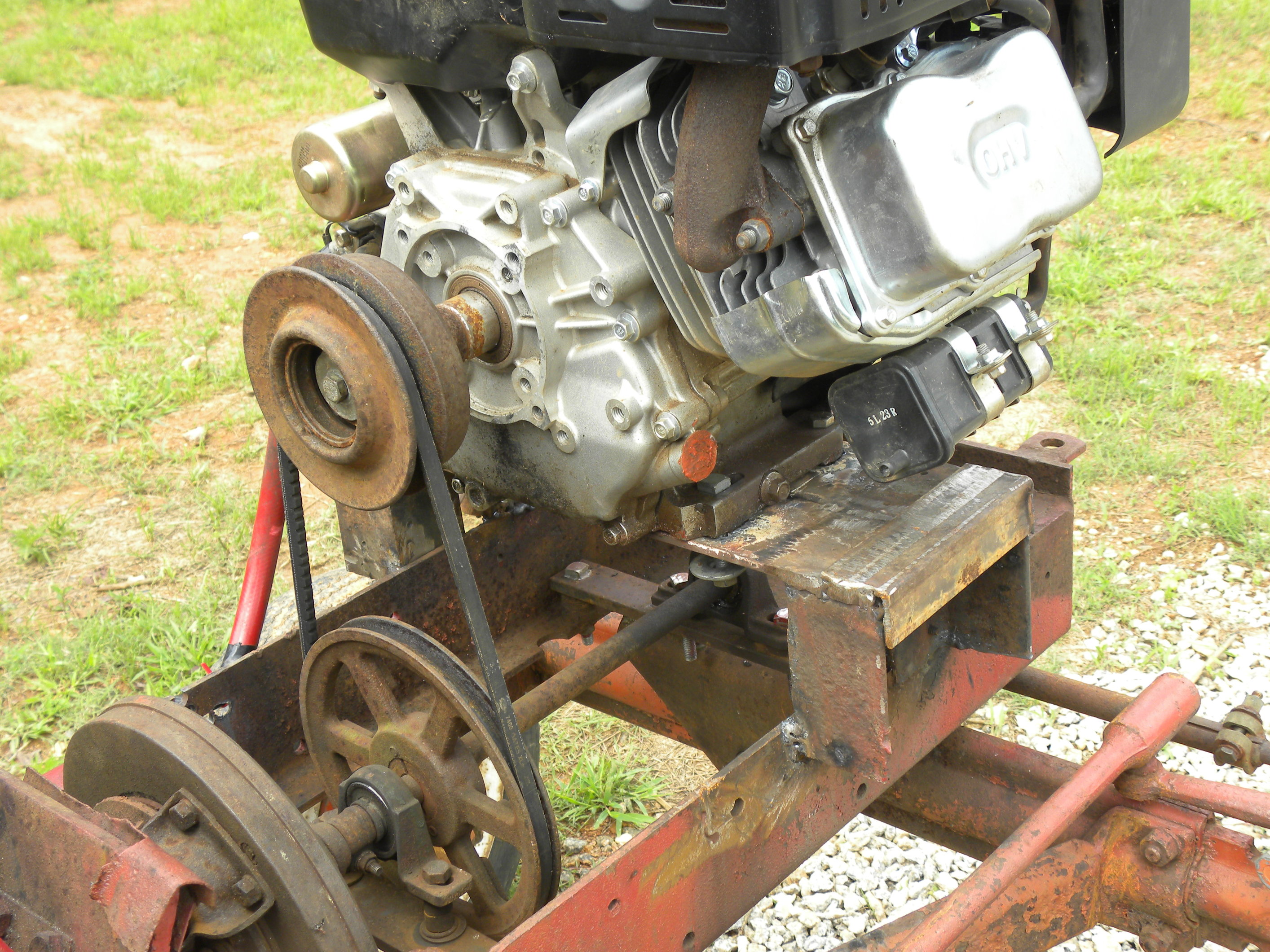

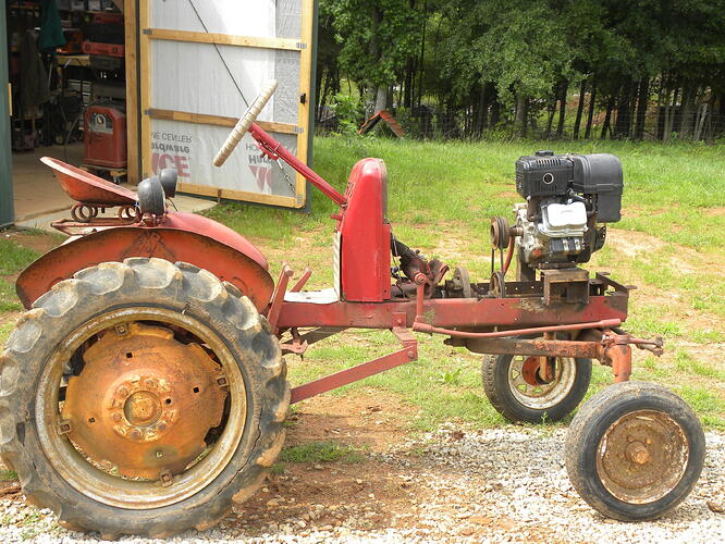

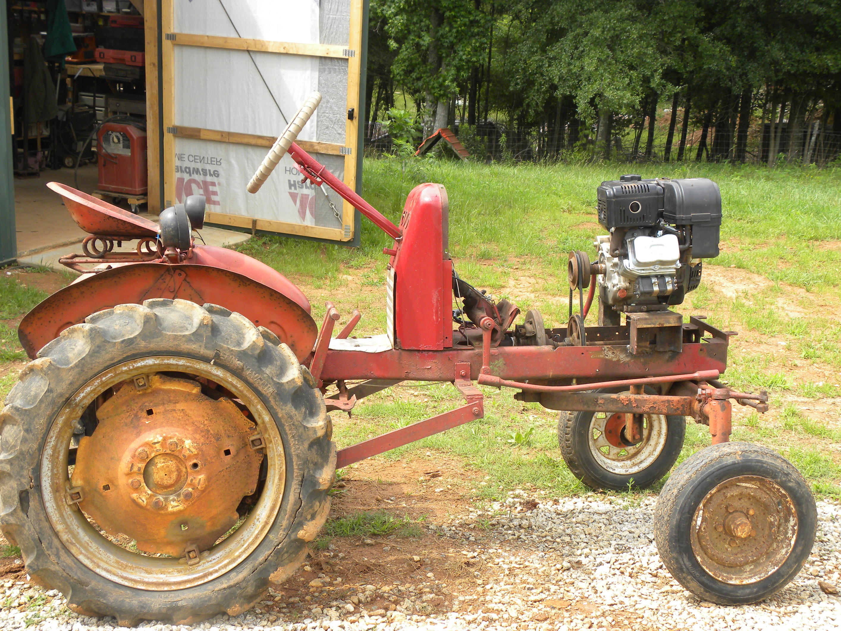

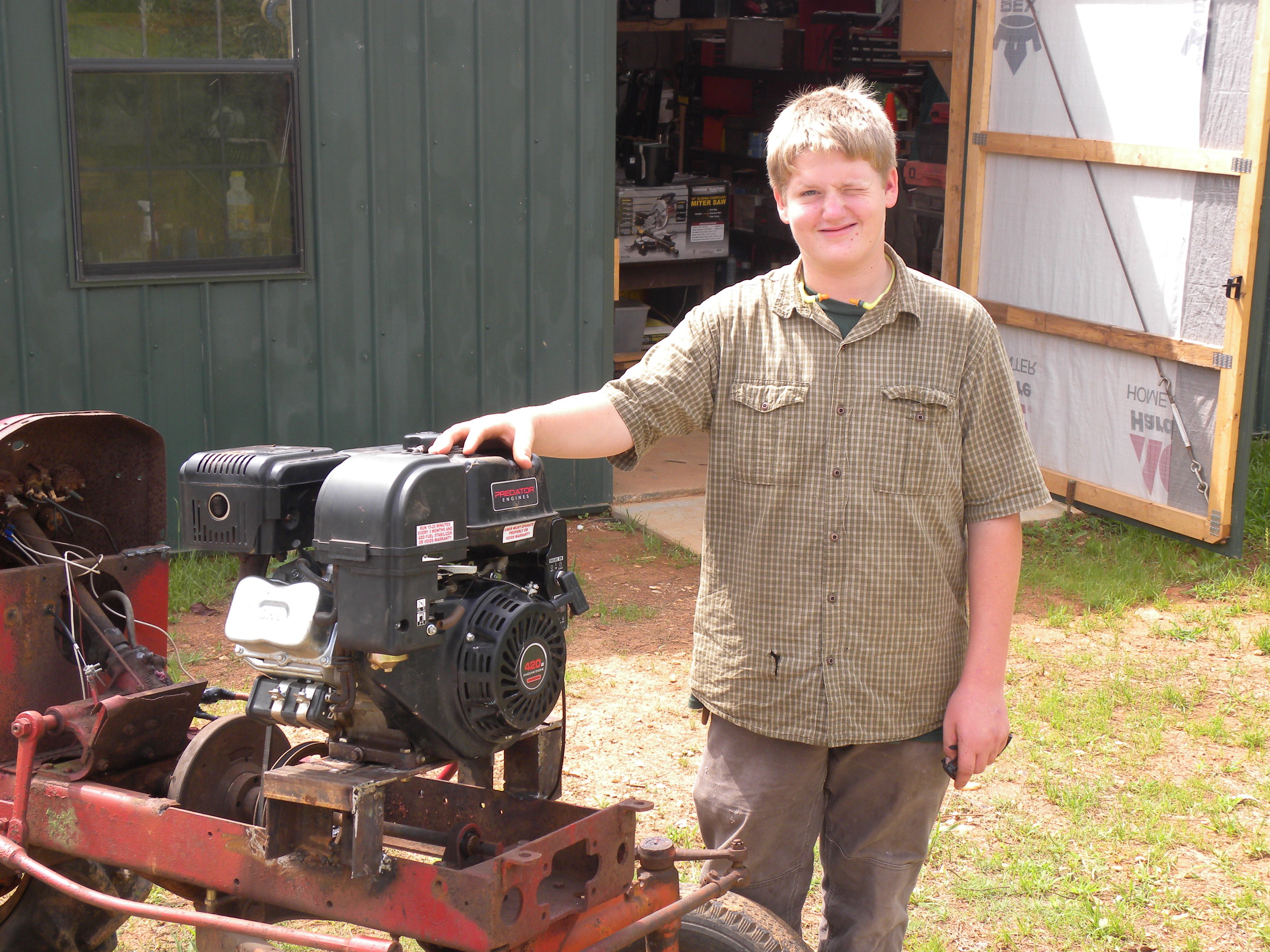

Jakob started getting his old Earth Master going yesterday. He pulled it out of a scrap yard about a year ago. He got an engine mounted and got it running. He was driving around yesterday. When he gets all the kinks out and fixed up some he plans to put it on charcoal. Maybe try to build one of the smaller wood systems or try out this thing of Larry’s if we can make sure we don’t have too much tar.

Looks like your kid has a good start on that tractor project. Just keep an eye open when he starts I am thinking you might have a wheele machine there and might need to add some front end weight. The old motor probably weighted alot more than that modern one.

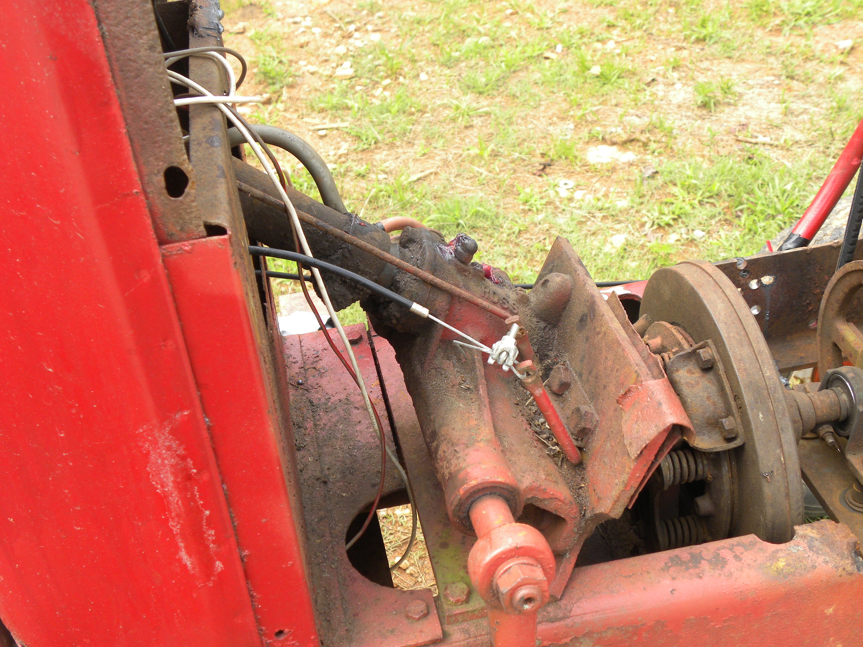

Edit: turns out it was not the tractor going by the house. It was his great grandmother’s lawn mower he was fixing for her. He did get a little done to the tractor though, Tidying up loose ends and such. New throttle cable.

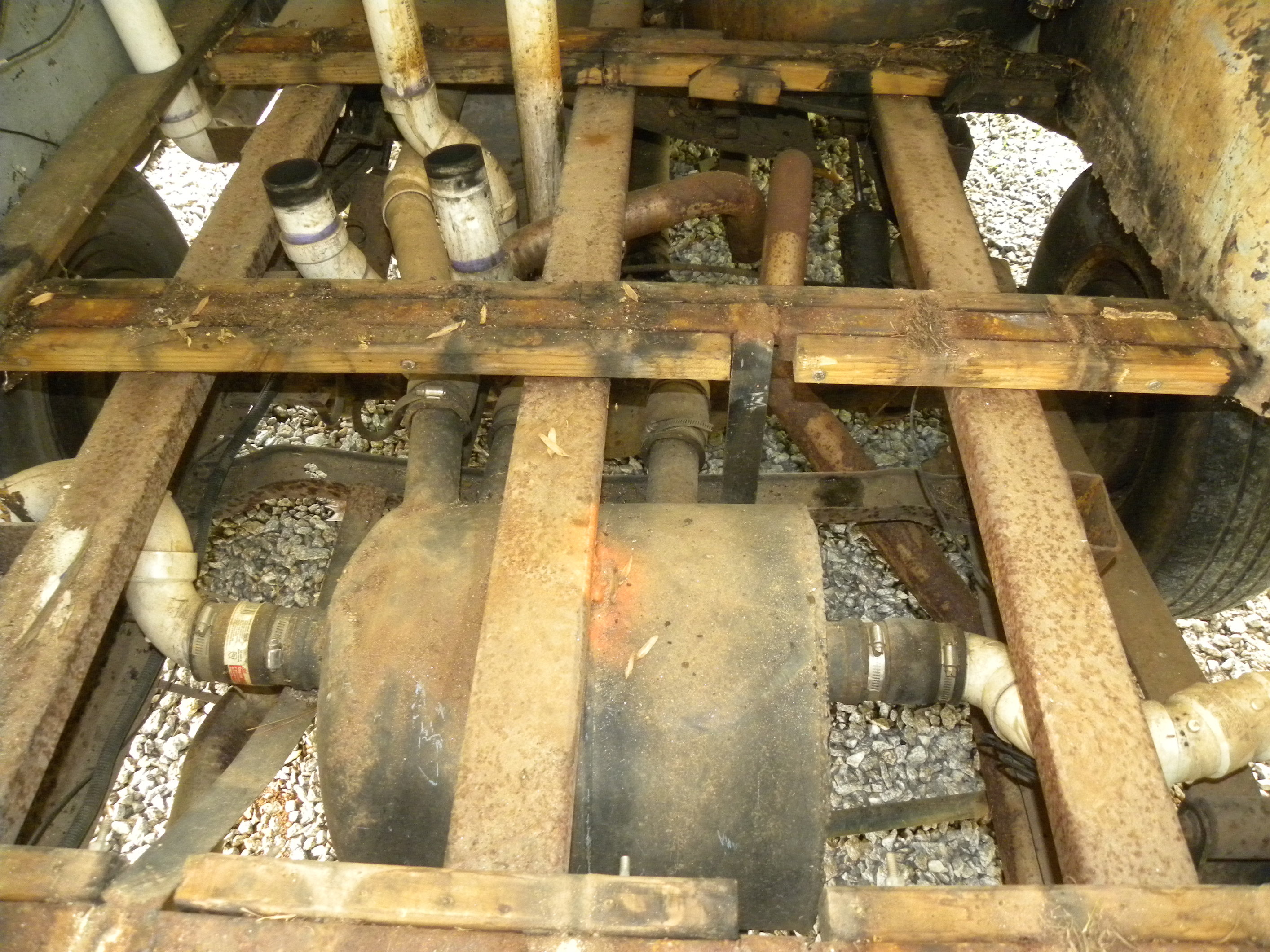

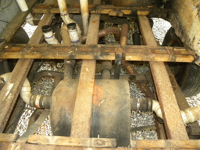

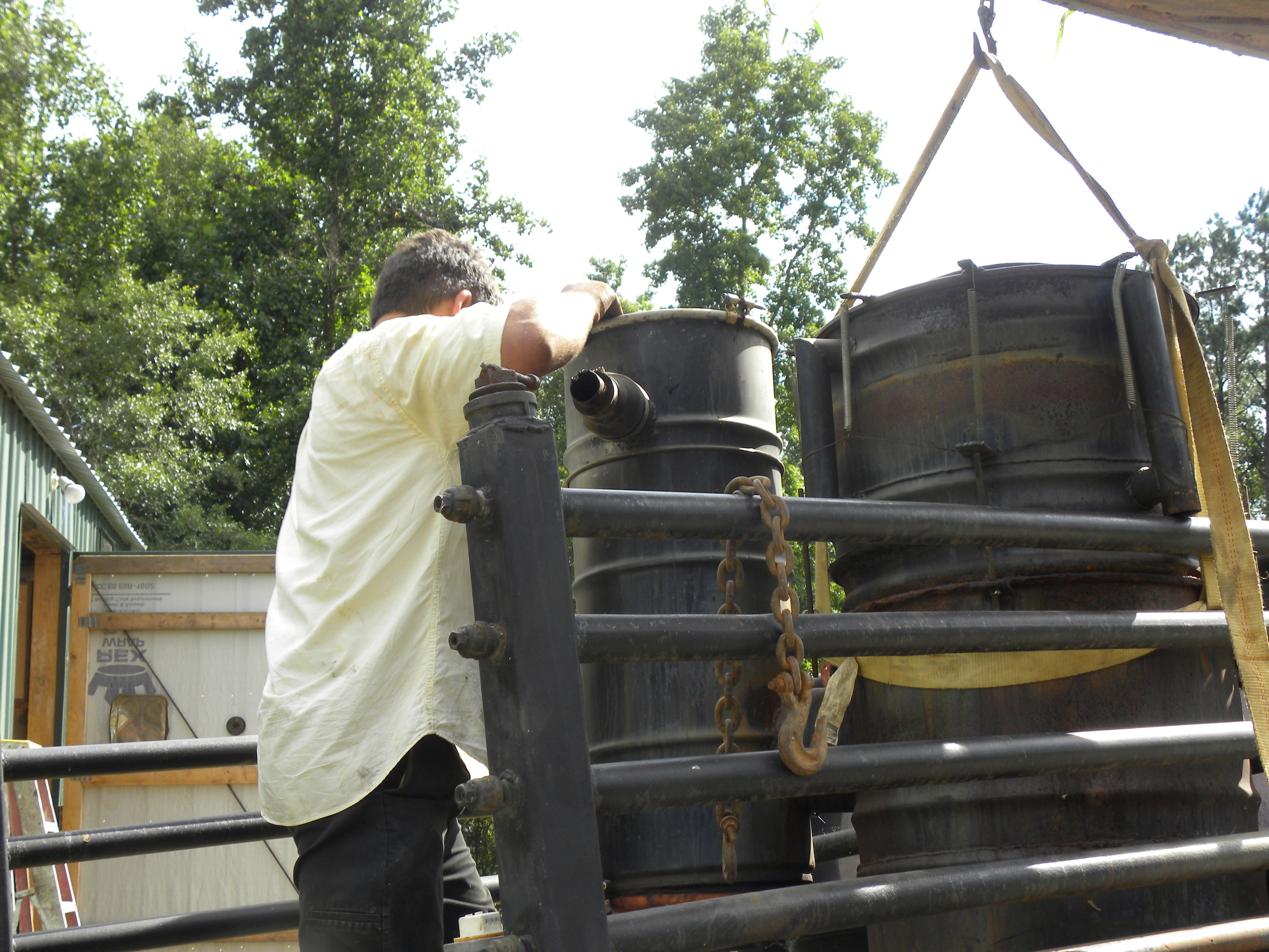

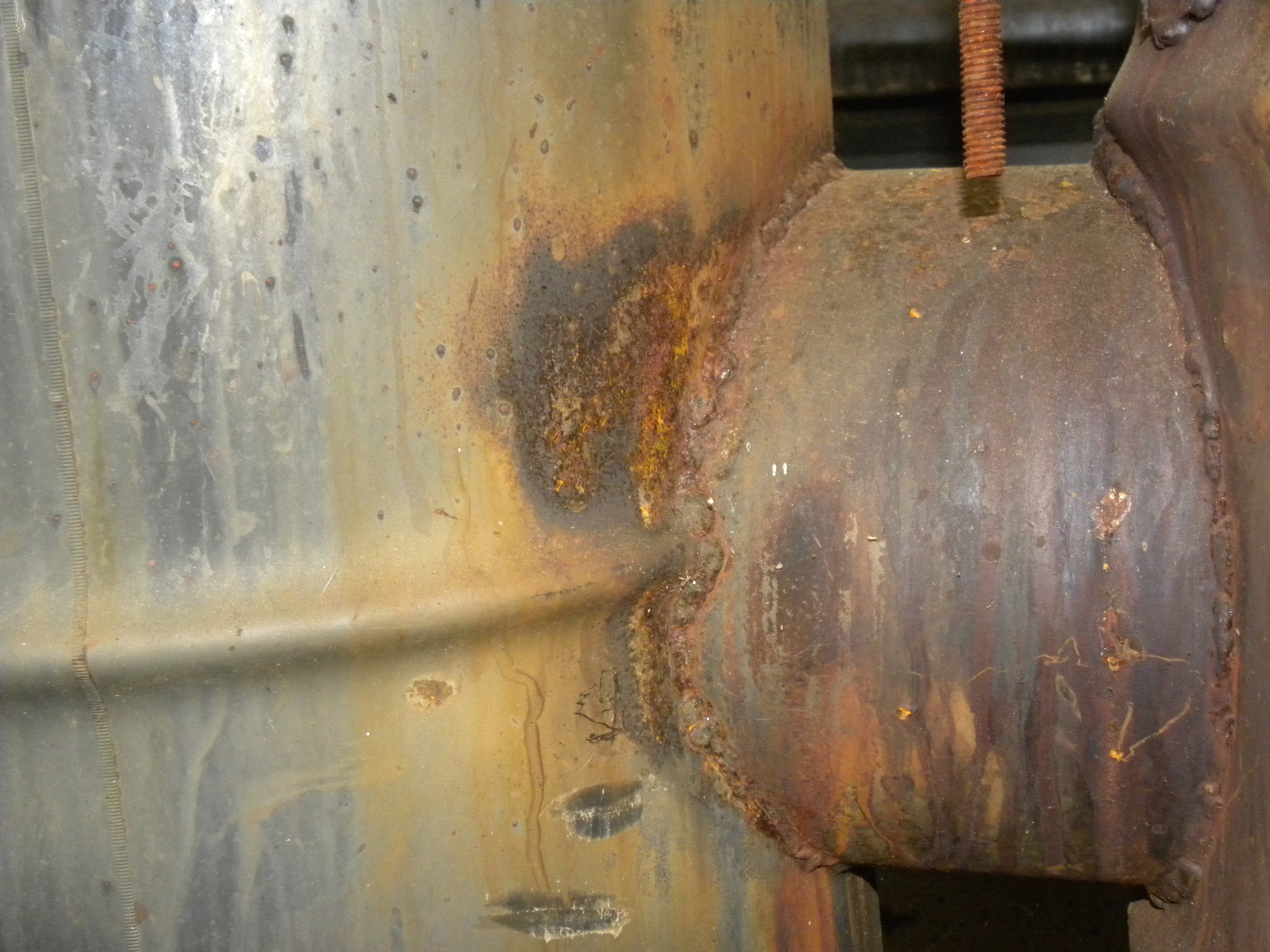

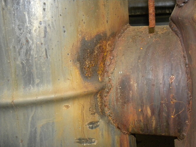

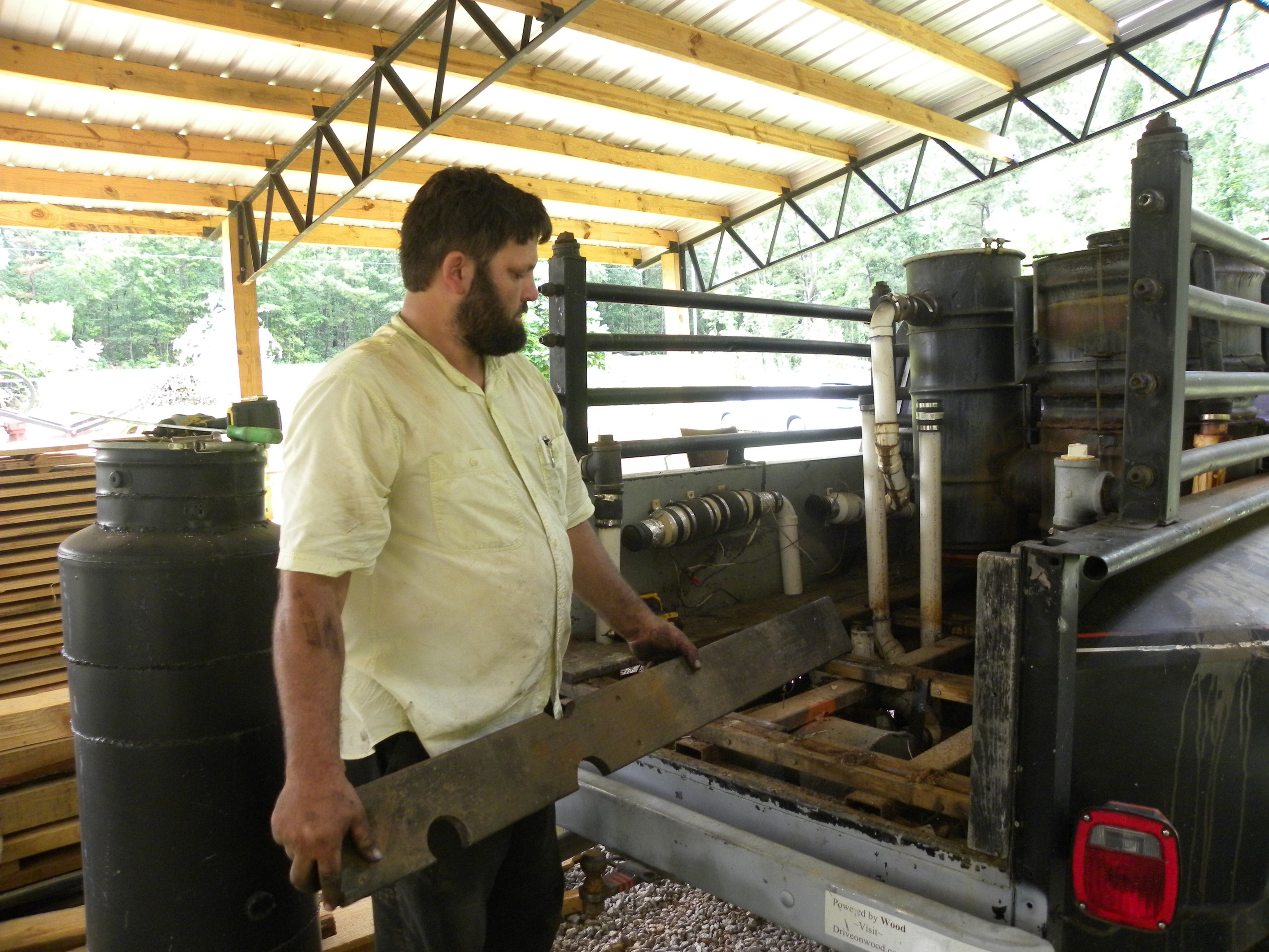

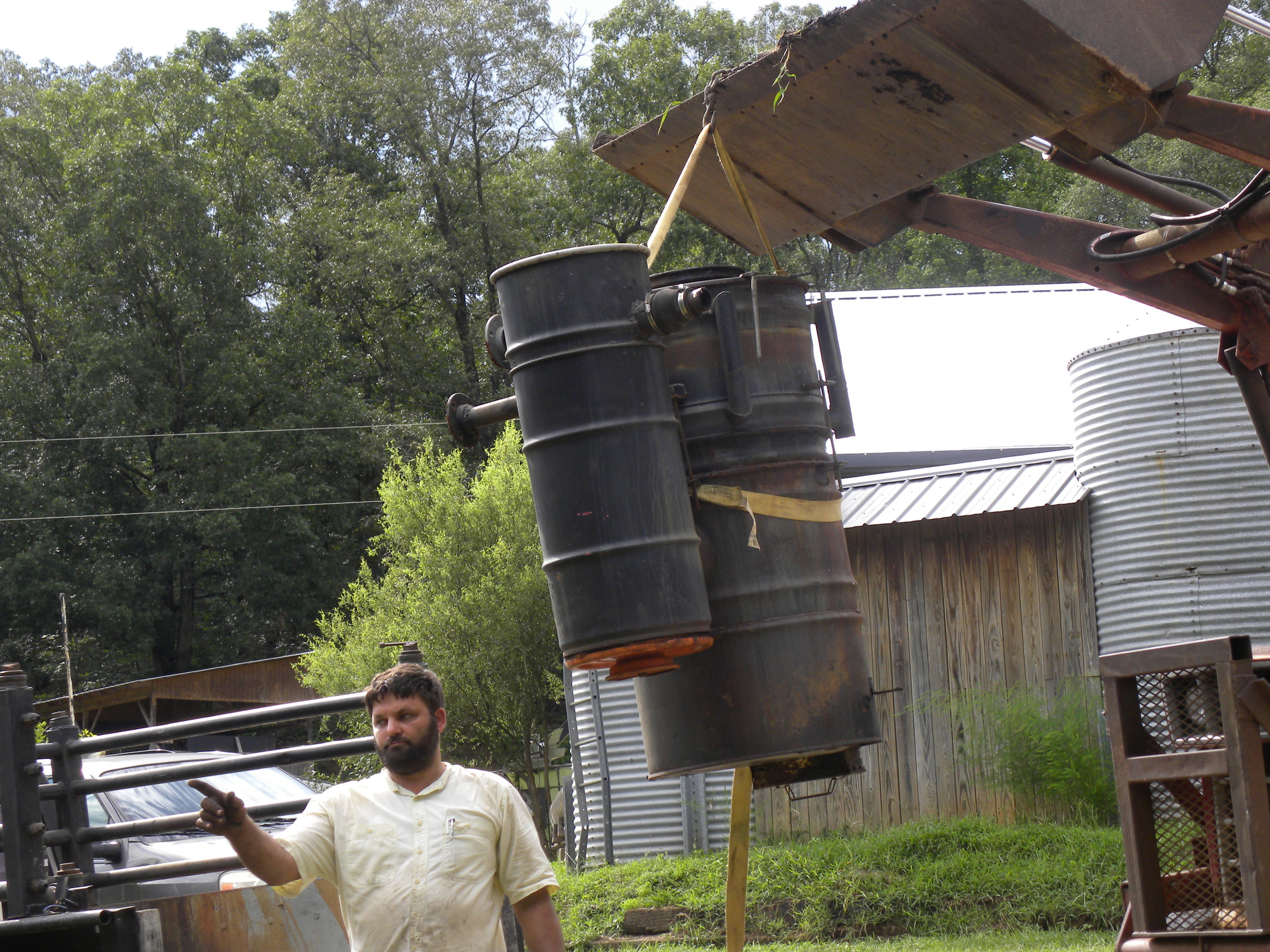

These pics are of our removing the gasifier from the truck today. I have some air leaks that need fixed. Also got it a little hot last time I drove it 100% wood. Not sure what I will find. May need some diagnostic help when I get it apart. In any case…one more thing right…

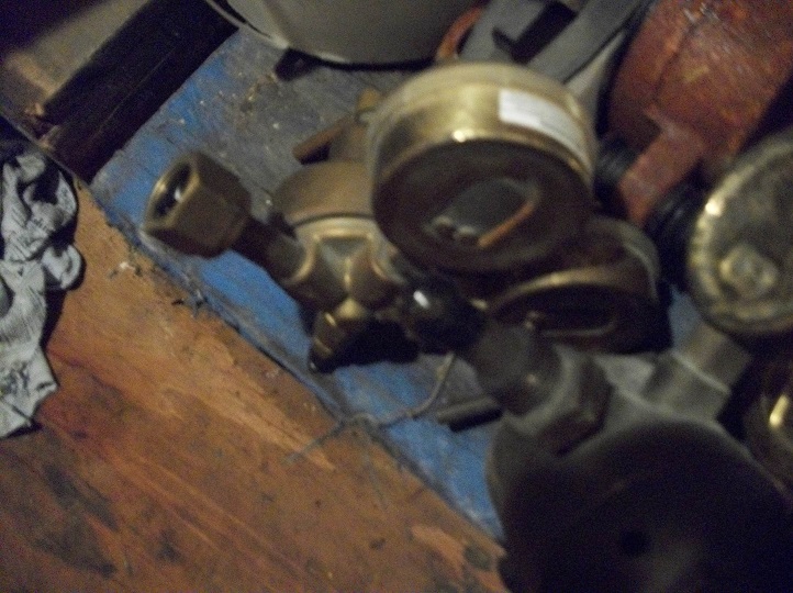

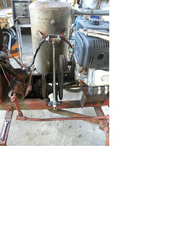

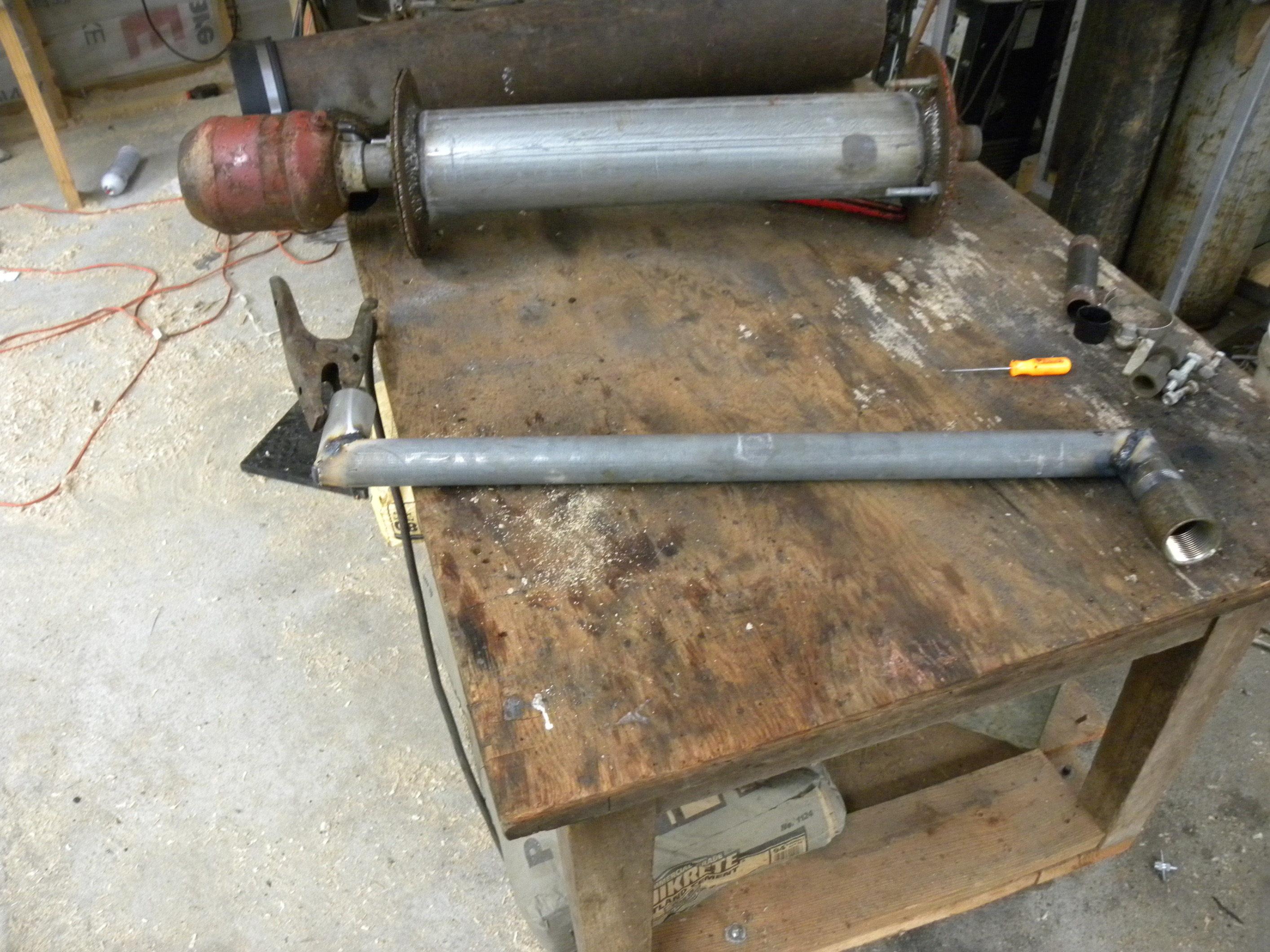

Jakob keeps bugging me to post some pictures. He has been working on his tractor, but I haven’;t had time to post them. Try to get them up soon, I think he has finished his cyclone, ash dump, filter, nozzle, and was welding the door to the hopper when I came home tonight. Here are a couple I have here now. I’ll try to get a few more up soon. We are having trouble finding the fittings we need to use our argon gauge on a co2 bottle. We are out of argon so he is stick welding everything. He’s using more grinding wheels than would be nice. But He’s getting there.

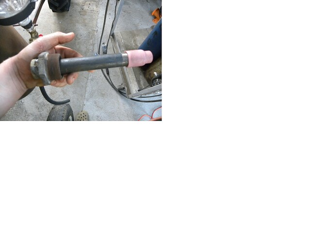

It is about time ya got those pixs posted, I was running out of patience!! hahaha But I understand, this time of year there is everything that needs to be done first, I’ve been painting all day, just in time for some cool weather tonight. I don’t know what an argon fitting looks like, but I saw a LH thread fitting on a propane tank regulator…might work. I guess it is about 1/4" NPT on one side, and the thing yanno is LH thread, might have some kind of porous metal filter material in the barrel of the fitting. The fitting might be either way female or male?..maybe this pix will match what your saying?

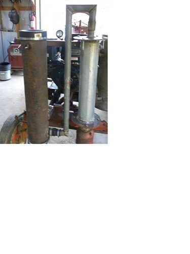

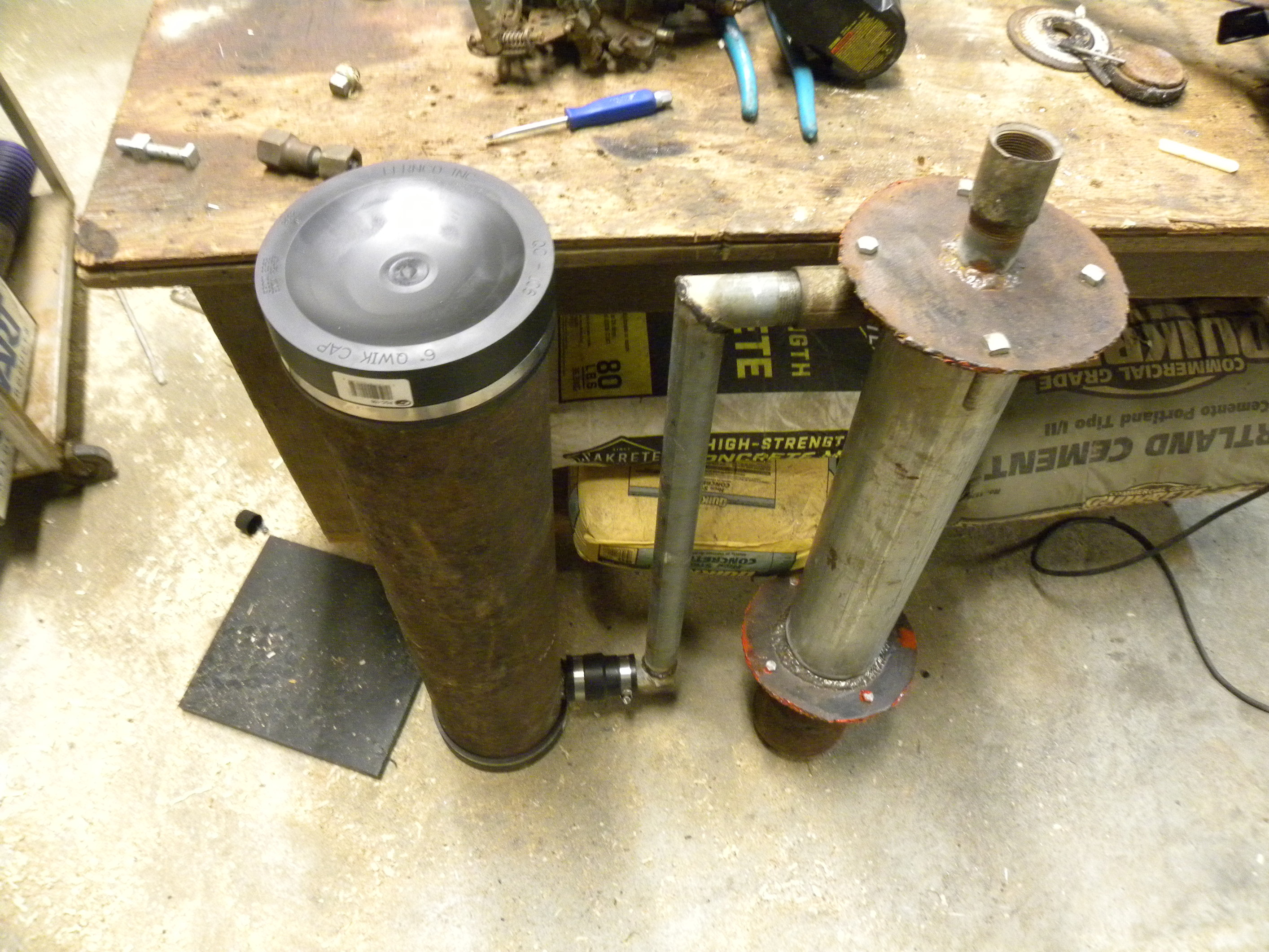

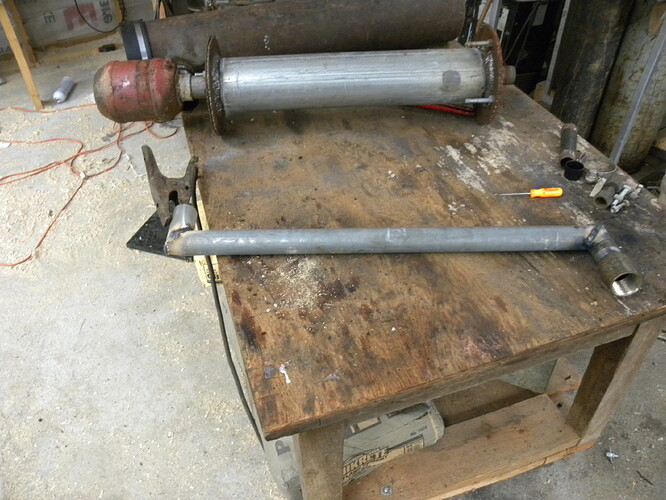

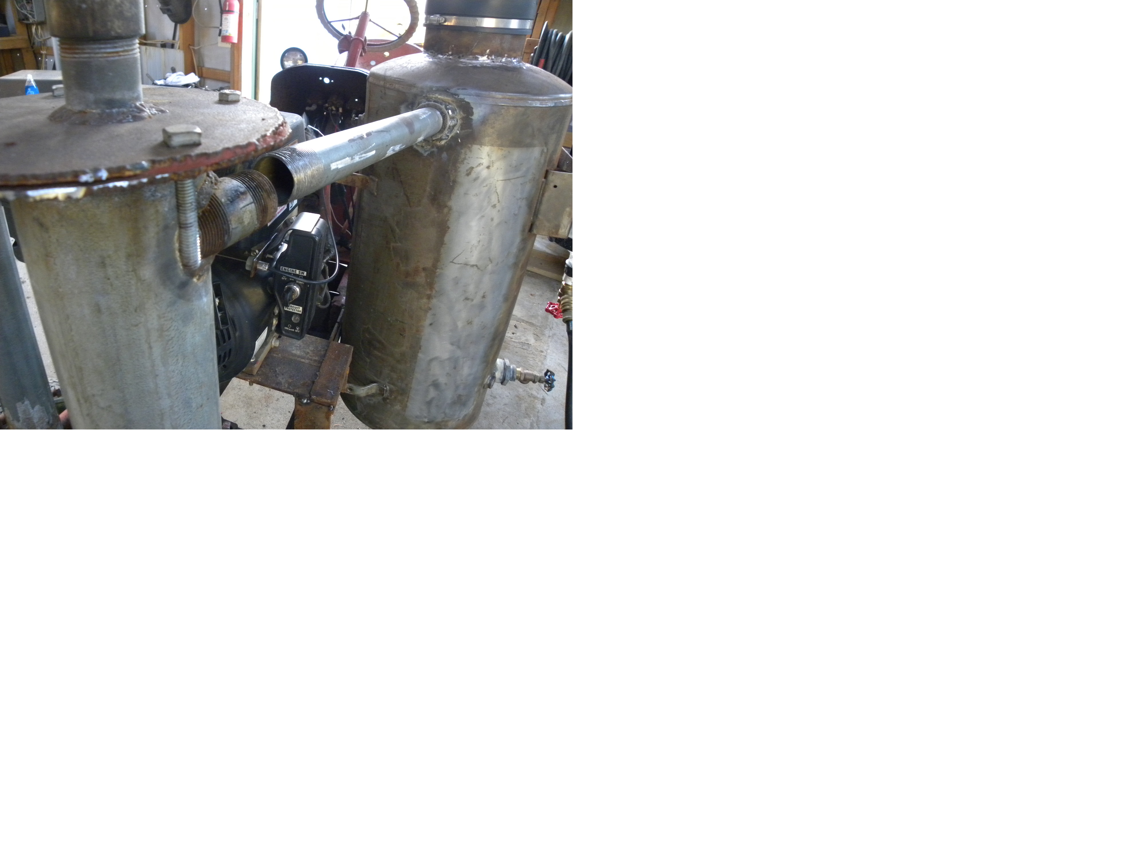

Hello all, Jakob here. Here are a few more pictures of the last few day’s work. I have a question for you darkside guys. In the top picture you can see the pipes between the hopper and the cyclone. Would it be too hot to use a rubber coupling at that point?
Hi Jakob, that is a charcoal gasifier, right? If you can find some high temp radiator hose I think that might work. With a full tank of charcoal the gas loses heat pretty fast and by the time it gets to the top it should be below 150 degrees and radiator hose can stand 200 degrees easy.
the rubber coupling should be fine. Maybe search out silicone if its available it has a higher temp rating. The exit temperature of the gas should remain low if there is enough charcoal over the reaction zone to convert the co2 into co. The best way to know if you are out of reactable charcoal in the hopper is when that exit temperature spikes. Its a toss up if your engine stalls at that point. I installed a temperature dial there myself as an indication of when I’m reaching “empty”. All I use is abs plumbing fixtures and sump pump hose so they would fail before your rubber coupling so you’re safe… Hope that helps ,the build looks great!
David Baillie
I agree with the above. The disadvantage of silicone hose is that small cuts can become big cuts.
