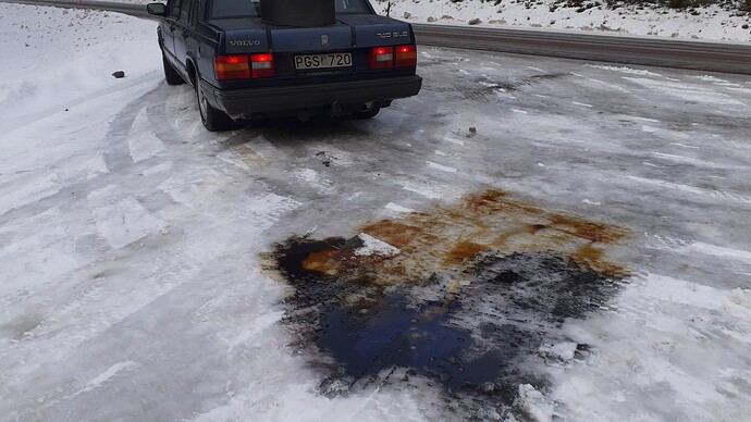

Went into town to buy some brake related stuff for the Mazda. Pretty cold until today. Suddenly melting temps. Just in case there’s another cold snap I try to remeber to pee right before I reach home again.
Read on Wayne’s 95 Dakota yesterday how he arranged his remote pee control. I still have to get out of the car.
I often wonder what people think when driving past and see a jet black puddle and a dirty brownish puddle next to it. Did bigfoot have taco bell?
We all got in trouble at Argos for doing this on the country road. Now we have a special barrel to put it in. Indiana is not Sasquatch country we could not blame it on him.
I remember last summer when Jakob North did his historical drive across the USA up through the Northwest and back across the northern part of the USA. We stopped on top of Snoqualmie Pass and his truck did a big Big Foot pee , I was surprised that it left very little mark in the gravel on the side of the I-90 freeway. Non polluting organic weed killer.
Better then what the State spreads on our road sides to control the weeds. JO you are doing a good service for weed control. SWEM.
