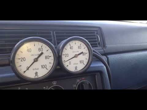

@Tone talks about penance and vanity…what the heck…here’s another couple videos ![]()
I was surpriced by a sudden speed bump and happened to shut the camera down, hence two vidoes.
Oh, and @Jan, you asked about any differences with a larger restriction. Nothing obvious after putting down about 450 miles and having a new ash cone established. Maybe it runs just a little bit cooler. When properly warmed up the temp exiting the heat exchanger hovers between 200-270C depending on load.
