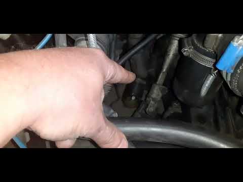

When you least expect it, first time for everything and all the rest of the sayings. Please watch the video and tell me if anyone had this happen before?

I think when the back fire happen your tennis ball valve may not have closed air tight and let just enough oxygen in to maintain a flame .
Edit ; I think a flame could be maintained in that area even if there were no soot and moist. Where the fresh air and gas meet after the ignition from the back fire .

Interesting the flame was able to sustain while the car kept running, I would have thought the gas would have burned up and choked the engine out

I think if there had been a bigger leak it would have burned all or most of the gas then choking the motor out .
I think if the motor had been killed 1-2 seconds there would have been no issue and the flame would die .
The amount of gas that will burn is equal to the amount of air leaking in .
Thank’s much for the input, Wayne. Nothing beats real world experience. Makes perfect sense now that I think about it.
I suspect the broken, dried out tennis ball with rather weak springs probably didn’t seal 100% until under heavy vacuum. Also, the backfire flame didn’t necessarily need to have reached all the way down, but fire traveling backwards towards the air leak once it was lit.
Anyway, no harm done. The brand new tennis ball and piece of plastic already delivered another 20 miles worth of woodgas. No puffs! ![]()
That was very interesting JO. Could have been much worse because that plastic pipe will burn very hot. Could have set a lot of other things on fire had it fully ignited rather than just melted through like that. I had not understood about the tennis ball valves before.

I don’t want to diminish the fire hazard, but I think as soon as I shut the engine down, the gasifier continued to produce a slight positive pressure, all the oxygen was pushed out and the fire was put out. Maybe different outcome if the plastic got hot enough to start burning on the outside ![]()

Interesting for sure. Althugh woodgas backfires do pack a punch. I have blown up filter cases before from backfires, when l had the filter close to the engine
