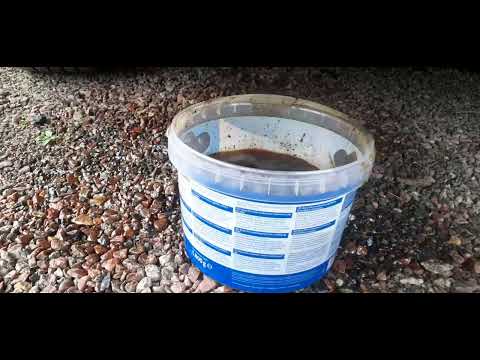

To @Jan, @Tone and @Pelletpower who were involved in the condensation discussion the other day - and to anyone else interested.
The distance Jan covered during his test was 50 km. I made a small detour to get as close as possible and ended up at 52 km. Close enough.
The only difference is I drove open road speeds at 80-90 km/h. One 10 min stop for an errand included also.
As far as I can tell, the alu roof tin I wrapped around the hopper has made no difference to the amount of juice collected. Maybe stationary or driving very slowly would cause some chimney effect inside the ribs, but that will require a separate test.

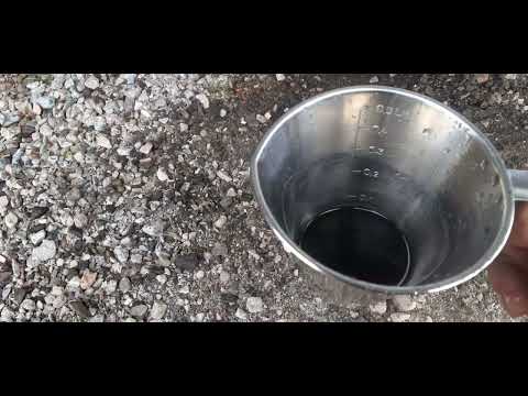

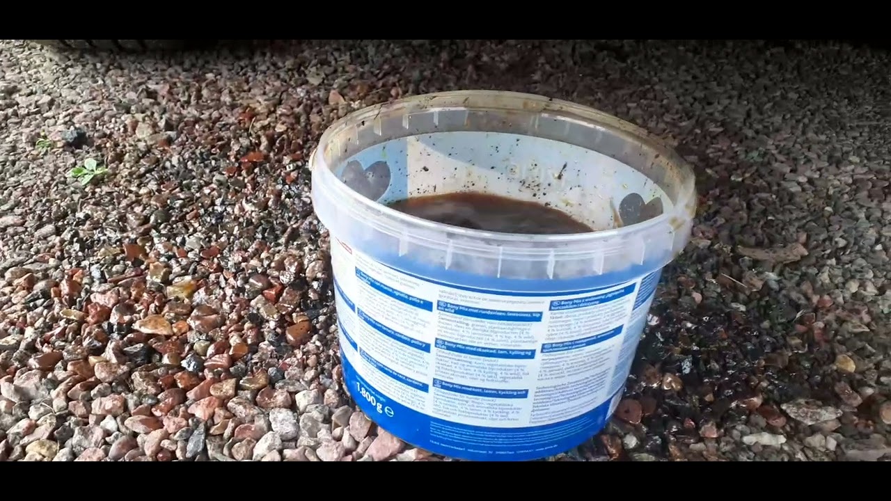

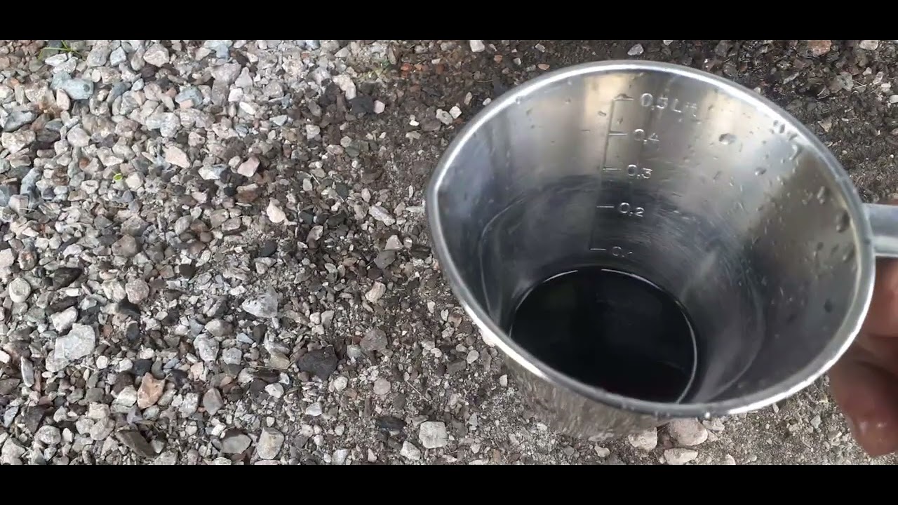

I made a video of draining condensation, but for some reason it was devided into two. Maybe I accidentally touched the screen of the phone or something, but fortunately I didn’t loose anything.
The result was the following:
Front trap : rear tank : hopper tank
1dl : 1.5dl : 2l
Converted to imperial that would be somthing like
1/2cup : 3/4cup : 1/2gallon

Thanks JO, Tone made it clear he did the fins for stationary. As you are driving with a serious speed cooling is already enough. And a lot, the same as after the gasifier. My condensation pot is still standing on the bench in the shop and looks the same as a few weeks ago. It doesnt look like there is any tar in it. That would separate, wouldnt it? Thanks, now I get an idea how much condensation takes place.
