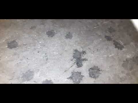

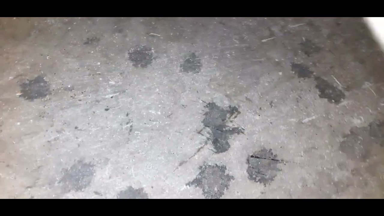

For the past week or so I’ve been using the Mazda truck for all my driving. Reason - a hot leak in the Volvo gasifier. It still runs ok, but temps are climbing super fast. Rail temps that I’ve only seen a couple times running full speed on longer trips, I suddenly hit right after lightup in just a few hundred yards. This leads me to believe the leak is in the heatexchanger - close to the guage.
Yesterday I taped my phone on a stick and stuck it into the gasifier cleanout door. I plugged the nozzles and with a tight fitting I blew compressed air into the air inlet. I expected to see a cloud of dust - but nothing.
After sleeping on it I tried a different approach today. I lit a cigarette at the air inlet, cranked the engine up on gasoline and let it breathe through the gasifier. Smoke didn’t appear where I suspected it to. I still think at 10 o’clock in the heatex, air have burned the soot off of the fins close by. At 2.30 smoke does appear, but that’s from the nozzles. They weren’t plugged this time. They should have been.

It looks like on the heat exchanger inlet between ten o’clock and twelve that there is a crack but it is probably only a bit of a sootcake that fell off.
Haha! No, no smoking. That was just old butts from visitors I found in a jar on the porch ![]()
Yes, brobably a flake. But still, in that area the soot seems to have been burned off - air present ![]()
I would mix up some liquid soap and water with a spray bottle, and blow air through the inlet. Spray on any suspected welds.
