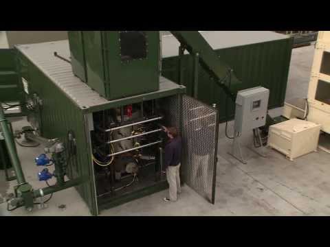

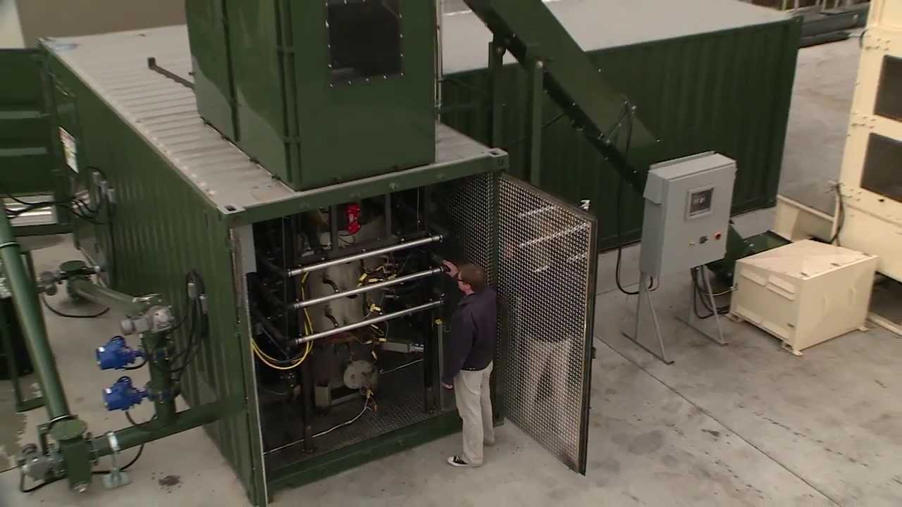

In reference to the different nozzle heights this gasifier has 5 or 6 different heights where the air is injected into the burn tube . It will switch nozzle heights based on the amount of negative pressure.
It also has an open top design.

Thanks for the video Wayne. Very interesting. Many ways to skin a cat.
Personally I try stay away from “gizmos” as much as I can though. Every apparatus I can do without means one problem less to deal with.
