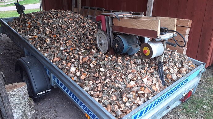

Don, I’ve been pretty busy filling up the freezers before winter and collecting firewood for springtime cutting and splitting. Also, taking care of the by-product - lots of limbwood for chunking. This is the latest batch from the other day. I’d better give Walter a call to come help me shovel ![]()

I try to be content with such things as I have, as the Bible says to be. But I have to admit that every time I see JO’s rebak sitting on top of that trailer loaded with perfectly symmetrical chunks of limb wood, and knowing how fast that machine made them, I have to fight off the green-eyed monster.

Oh, that’s what you call them ![]()
All of its brothers, sisters and cousins hunted me when I first layed eyes on the huge, sunny Alabama woodpiles of Wayne’s
It’s the no1 reason joined DOW ![]()
