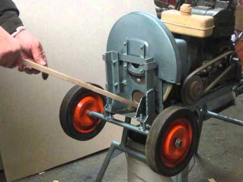

I got one of them. Cool little engine. Made by continental. Mine has a bad voltage regulator. I found this picture on the web. I like how they adapted a Briggs and Stratton recoil starter onto the rope wrap.
So… Because it is an antique engine, and it does not have electric start, and this is your first gas producer, eugene, I would say this is a poor choice to start with. I think if I had to do this, I would run it on gasoline and see if I could switch it over to Wood gas as it’s running. I have never been very successful doing that. Trying to start something with a rope wrap is incredibly annoying. Eugene will have many other variables to concentrate on. I think I would adapt some sort of electric starting motor to the engine if I was to run it on wood gas or charcoal gas.
I certainly don’t think it’s impossible, and I am not saying to don’t do it. But there are lots of other choices out there.
I guess you would want to retrofit one of those belt driven Starter Generators to it, wouldn’t you?
