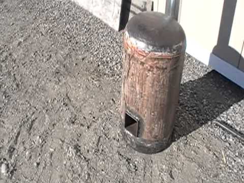

Rocket stove heater for my small steel insulated panel shed. got a couple hours into it… hope to have it done by Saturday night so I can trial fire it with my son…

Love the Rocket stove concept but hanen’t made one yet. Is the L tube your fire tube and riser or the firetube and wood feed? Looks good

Please keep us informed with your rocket heater progress. That looks interesting. Is that 4 inch square tubing and the top of a propane tank? Do you insulate the riser stack? Chimney down low to outdoors?
Don M
part of a 100 lb propane bottle, 4" square tube and flat plate.
the L tube is the feed and riser and will be a J tube once it’s totally finished.
The L tube is insulated with ceramic wool insulation on all sides.
I will be adding a vertical feed tube that will have a door on the bottom for starting and cleaning… just wanted to fire it up as is and see what it does…

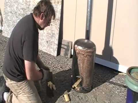

rocket stove sitting outside with a 60" long chimney pipe
I love my rocket stove.
vertical feed port added
burning it again today…i was having trouble making it work because i kept lighting too close to the feed tube. figured it out… gotta get the stove chimney inside really hot before starting to let the fire move forward to the vertical feed tube. we live we learn.
I read somewhere that a crumpled newspaper loosely poked in as far as possible and lit on fire should create the draft needed to start up.
