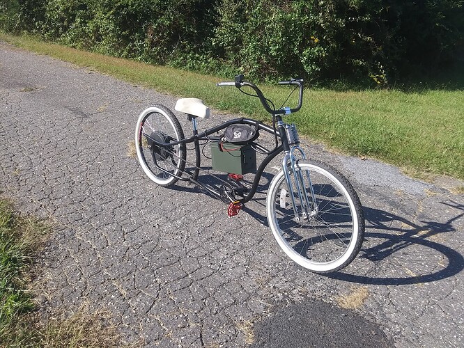

Bike is now rideable. No brake cables installed yet so I’m still using the Flintstones Brake System with my Dunlop rubber boots. Just going up and down my driveway right now.
There really isn’t a satisfying way to mount this battery I built in the tubes of the bike. I might take this apart and just build a super nice 12v battery out of them.
I really want to build a sidecar with a Ural-like trunk for storing batteries and tools. I’d need to upgrade from a 750w to a 1500w to make up for the weight gain I think or my legs would get pretty tired.
Goes uphill like a champ if I hold the throttle down and pedal like a madman. It’s a fixed gear using a 6 speed freewheel cog though, set to the smallest cog for chain alignment.
I am never satisfied with this motor and I think I should order one of the Cyclone motors that go into the bottom bracket itself and buy a Sturmey Archer 3 speed fat bike wheel. Leave underdrive and overdrive for just pedalling and run ebike on the 1:1 gear for strength.

I think for my own luck this bike tops out at 30 or 35mph. It’s one of the cheaper kits that I bought December 2019.
I might take this motor off and assemble it on a mountain bike and sell it. Change it out for a mid drive motor with a Sturmey Archer 3 speed internal gear hub.
I was given advice that the headway cells I’m using are the explodey kind and I should get different cells. Might buy a few of the cheap hoverboard batteries and daisy chain them in parallel to get some amphours I like. 39 dollars a pack and they already come with connectors and balance boards!

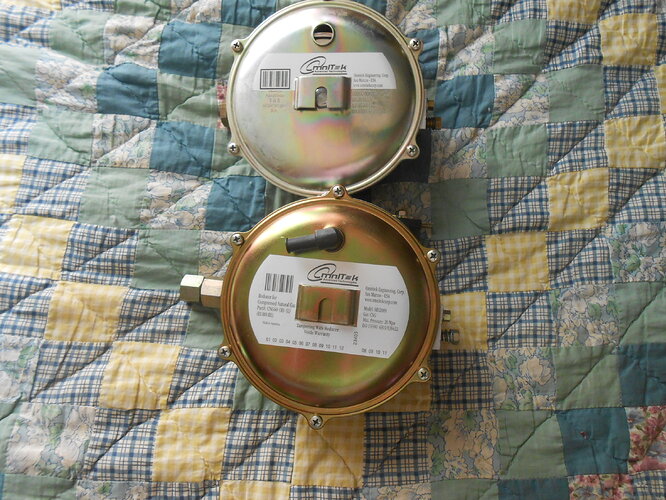

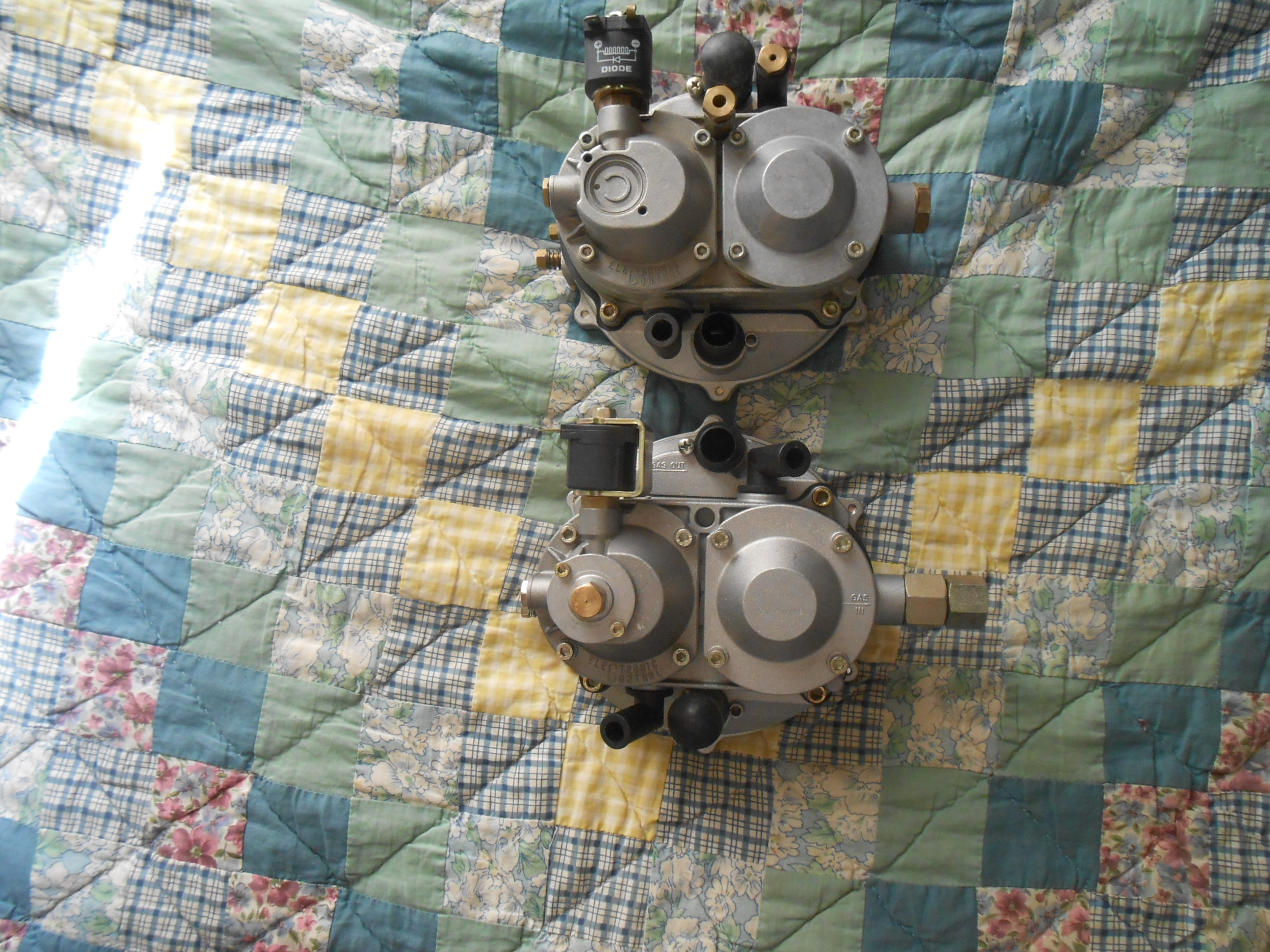

seems like the right propane regulator if I ever get it installed . Was first sent CNG regulator and then was sent LPG regulator
Ordered 4 hoverboard batteries off of eBay. They’re 4.4ah each, I’m hooking them up in Parallel, so I’ll in theory have a little over 17ah so maybe 17 miles of distance at worst. It recharges when braking and coasting so some of that loss is made back up.
Also had to order an 8 foot long brake cable and housing for the rear brake. This bike is pretty dang long. Still need to get a front wheel that can mount a disc brake, my springer front end has hangers made for them.
I want to make a false Harley Split Tank to store the batteries, and a false oil tank to put my controller into. Dad’s gonna show me his old indian tricks for fiberglass making, he used to work on corvettes a lot. The old Confederate Corvette Club seemed to like his handiwork according to all the show trophies he collected.

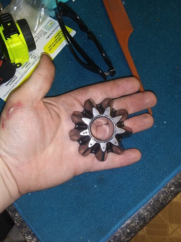

If I went for the Swedish reactor I would just need a single nozzle going in the side and use a removable grate, run the gas over to the other side with some cooling pipes in parallel where my filter box would be. I’ve considered recycling my filter from the Mazda because it’s low profile and the flow would be great. Doubling as a drop box and sack filter. Nozzle would need to be very beefed up, I could do EGR or water drip but I want the security of knowing the nozzle wont burn up suddenly. I have those wrist pins and I could double over that using some worn out bevel gears to give a wide surface and heat sink.
The big faced back end of the bevel gear would be almost like a mini Pedrick plate, and give me indication of it being too hot in that area. I’ll weld in a plate opposite of the nozzle in case the jet blasts to the other side.
