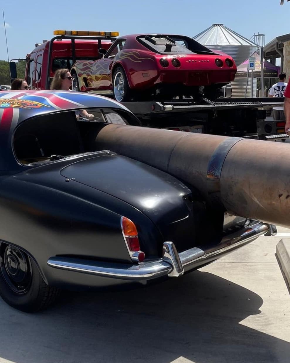

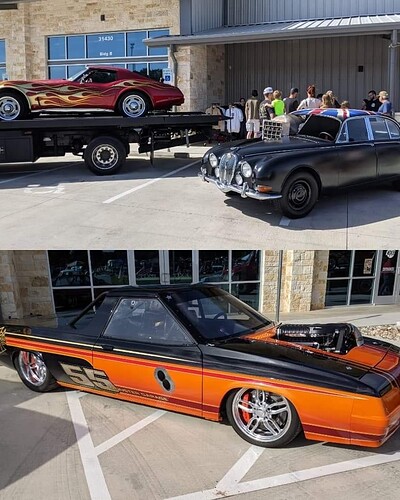

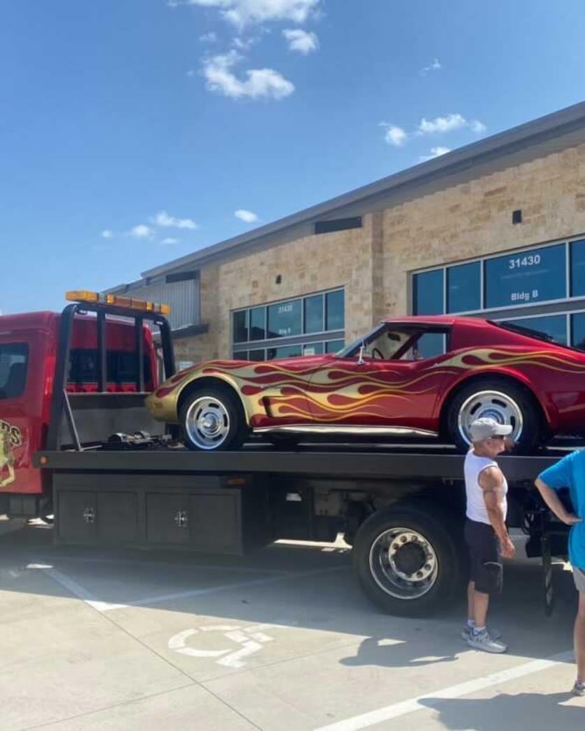

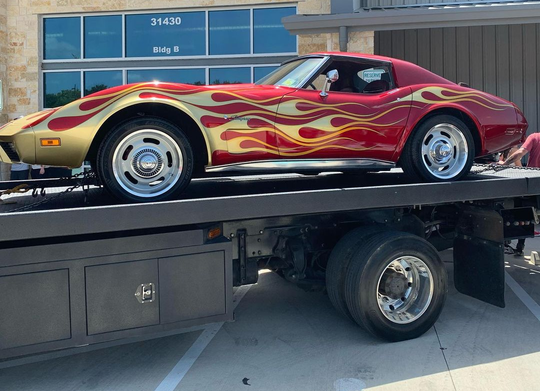

Here’s some pics of the car show earlier today in Austin TX.
