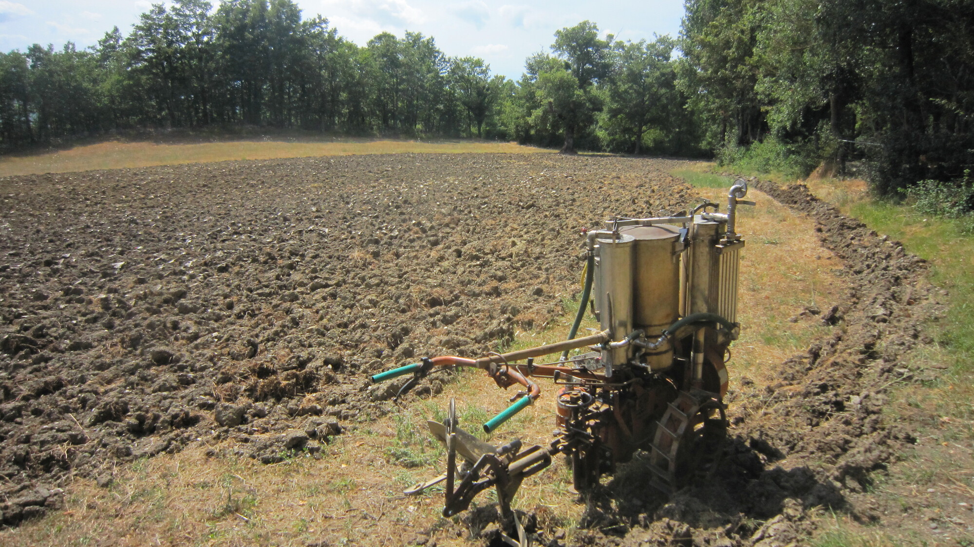

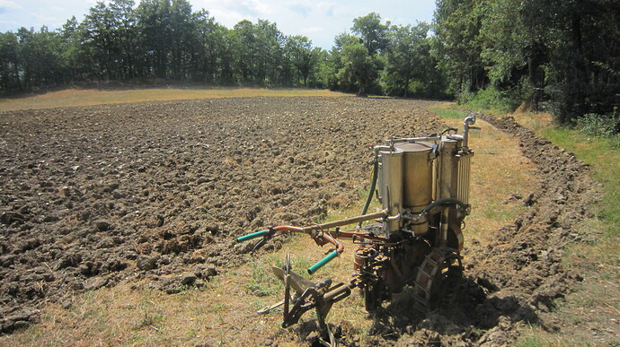

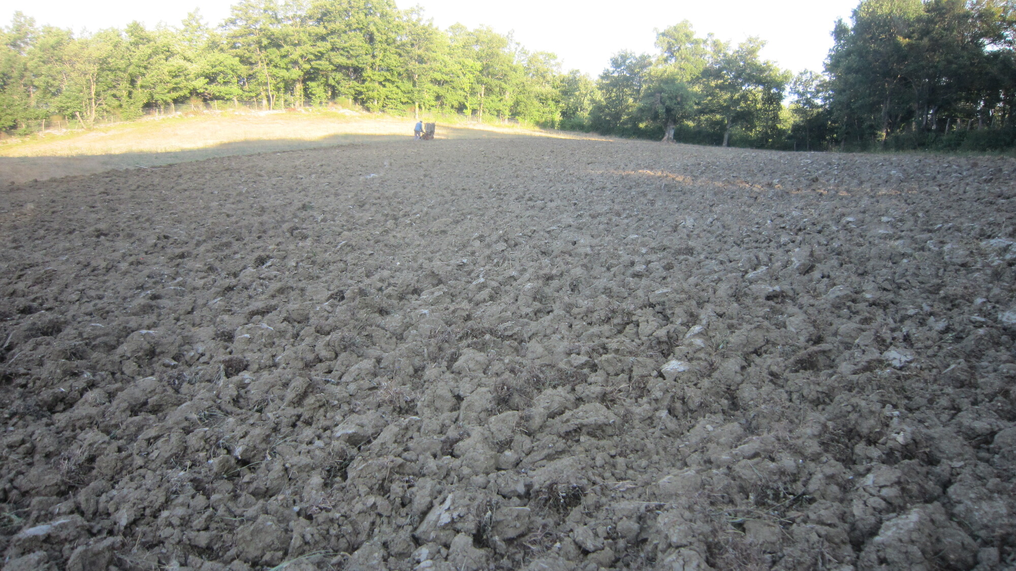

plowing the field with motorcultivator on chargas

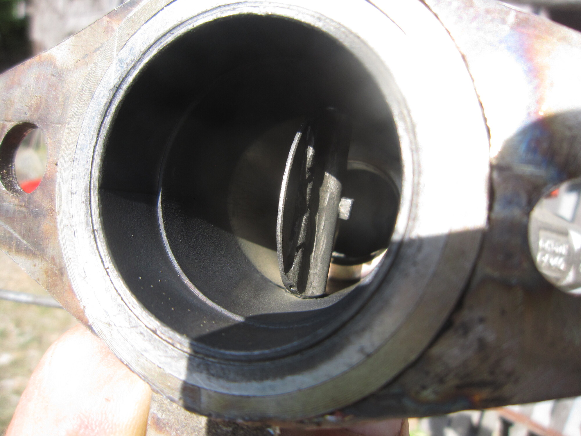

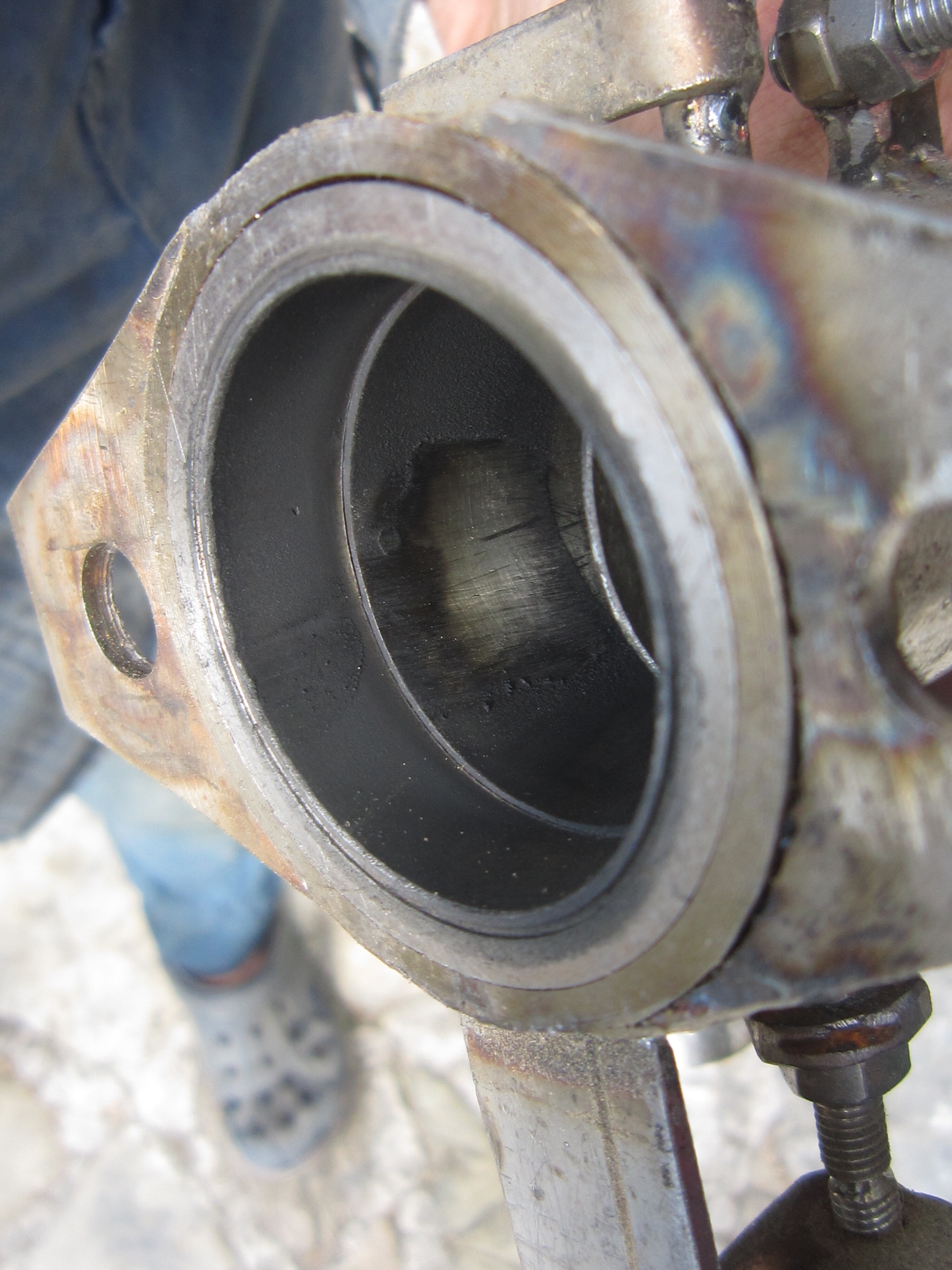

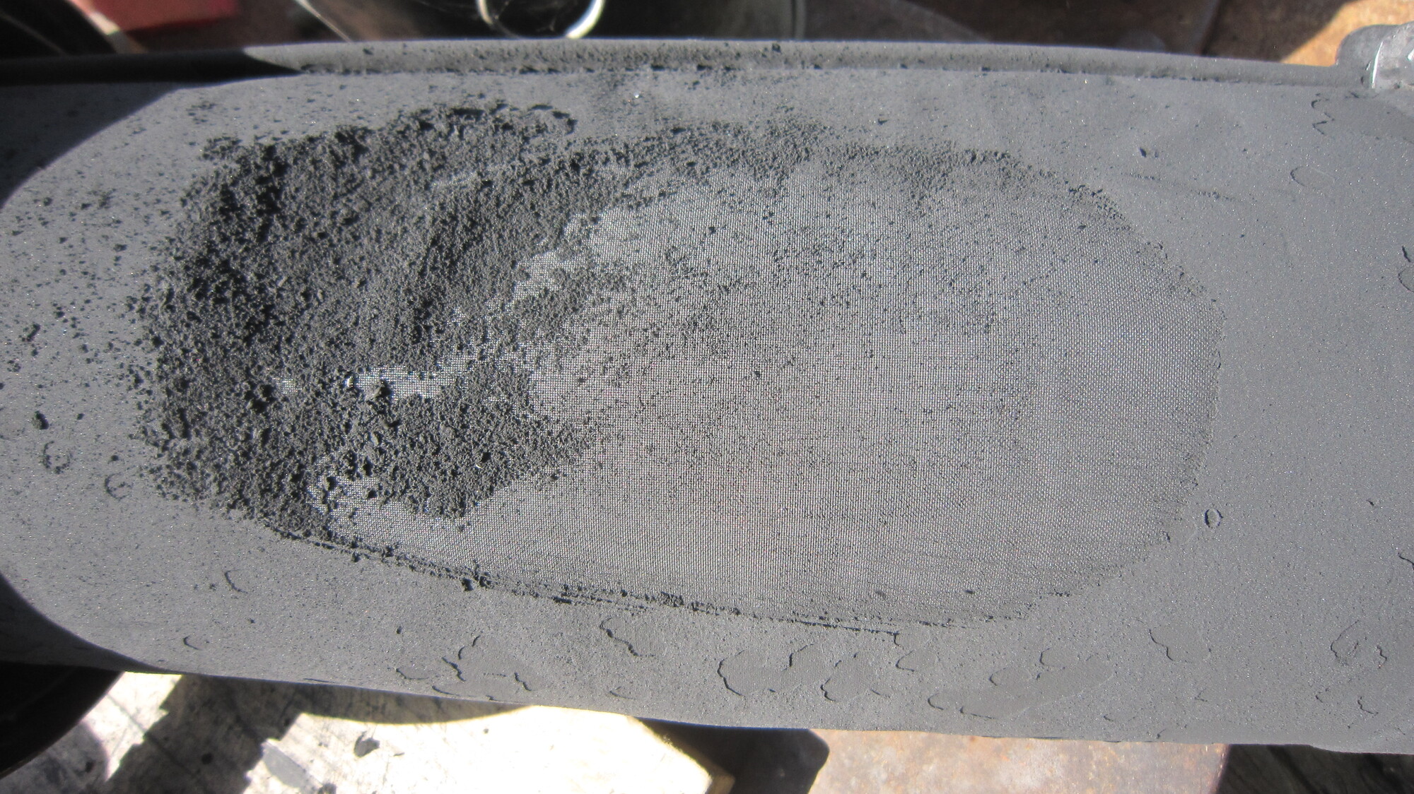

throttle after about 40 working hours

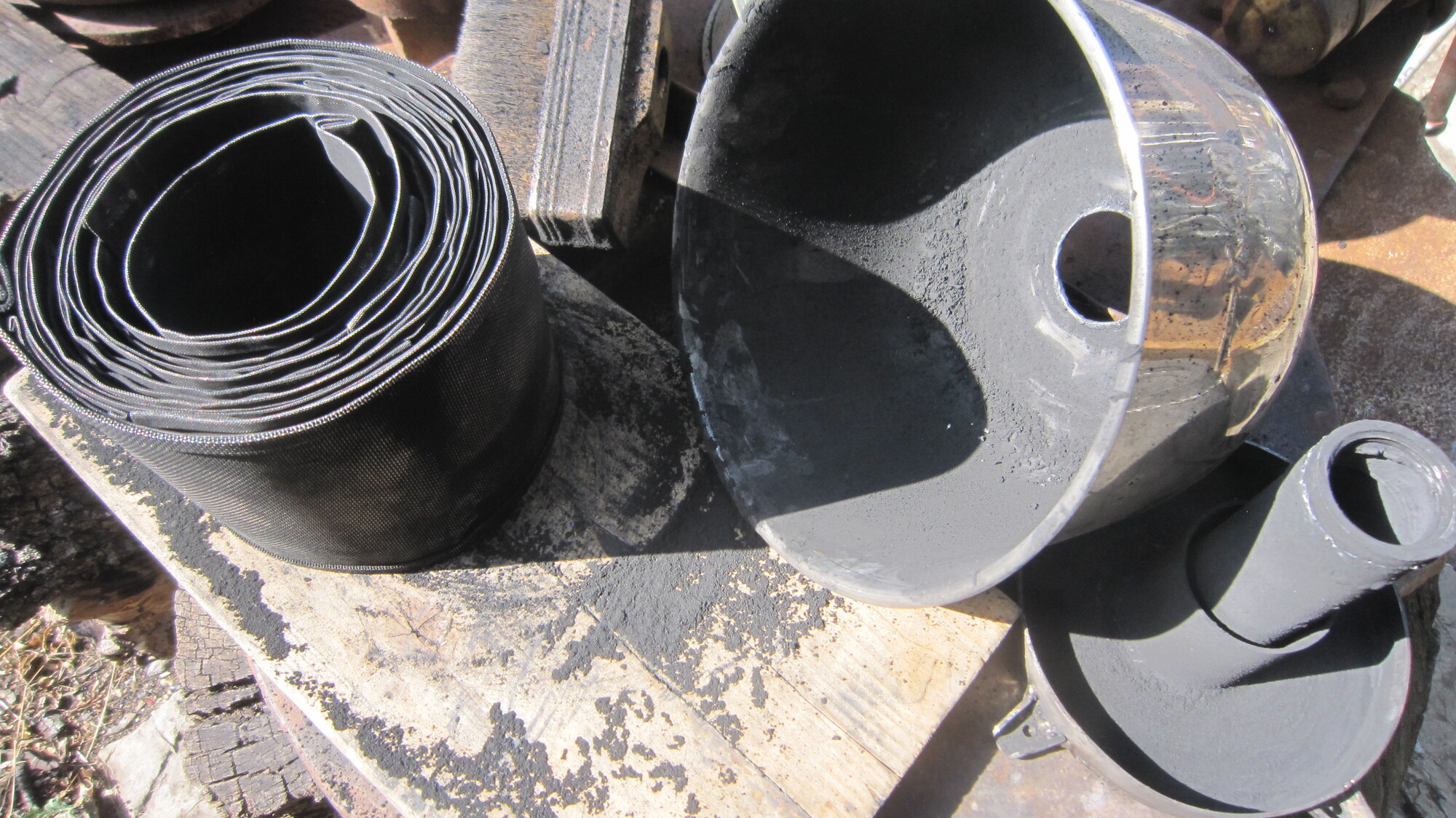

some oily black residues …from the oil bath filter…

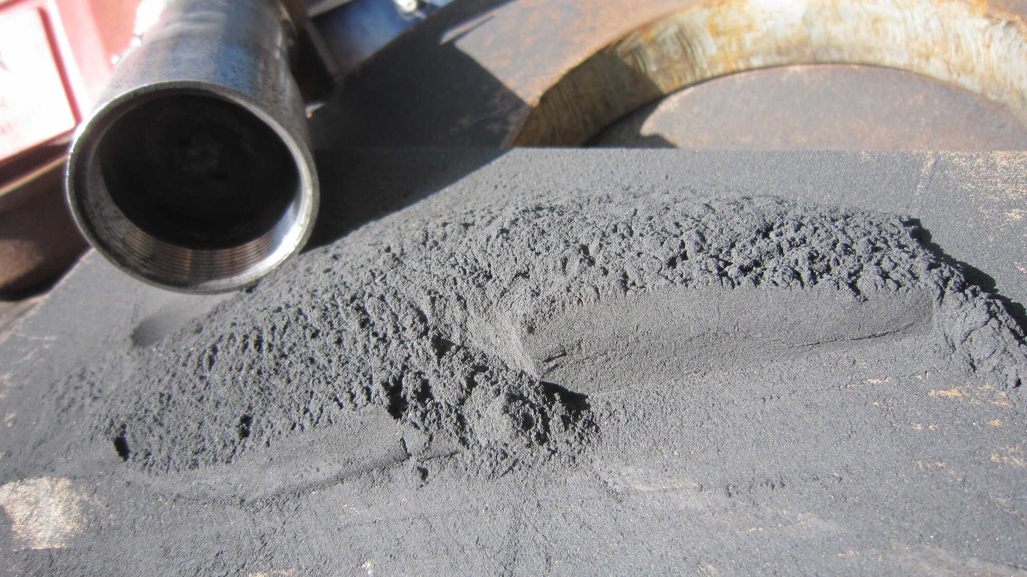

cyclon after 7 hours…

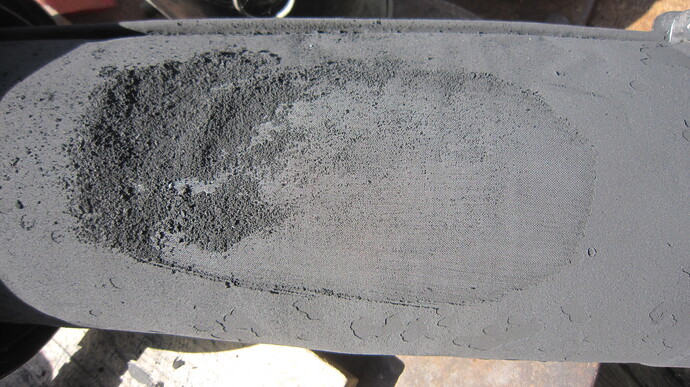

triplo mesh filter after 7 hours…
and dust trap

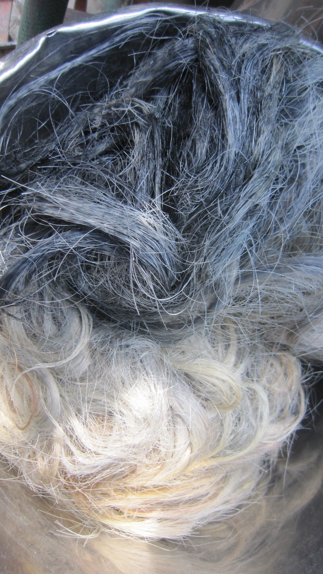

hair filter upper part
hair filter, the bottom part is the black one, very dirty,

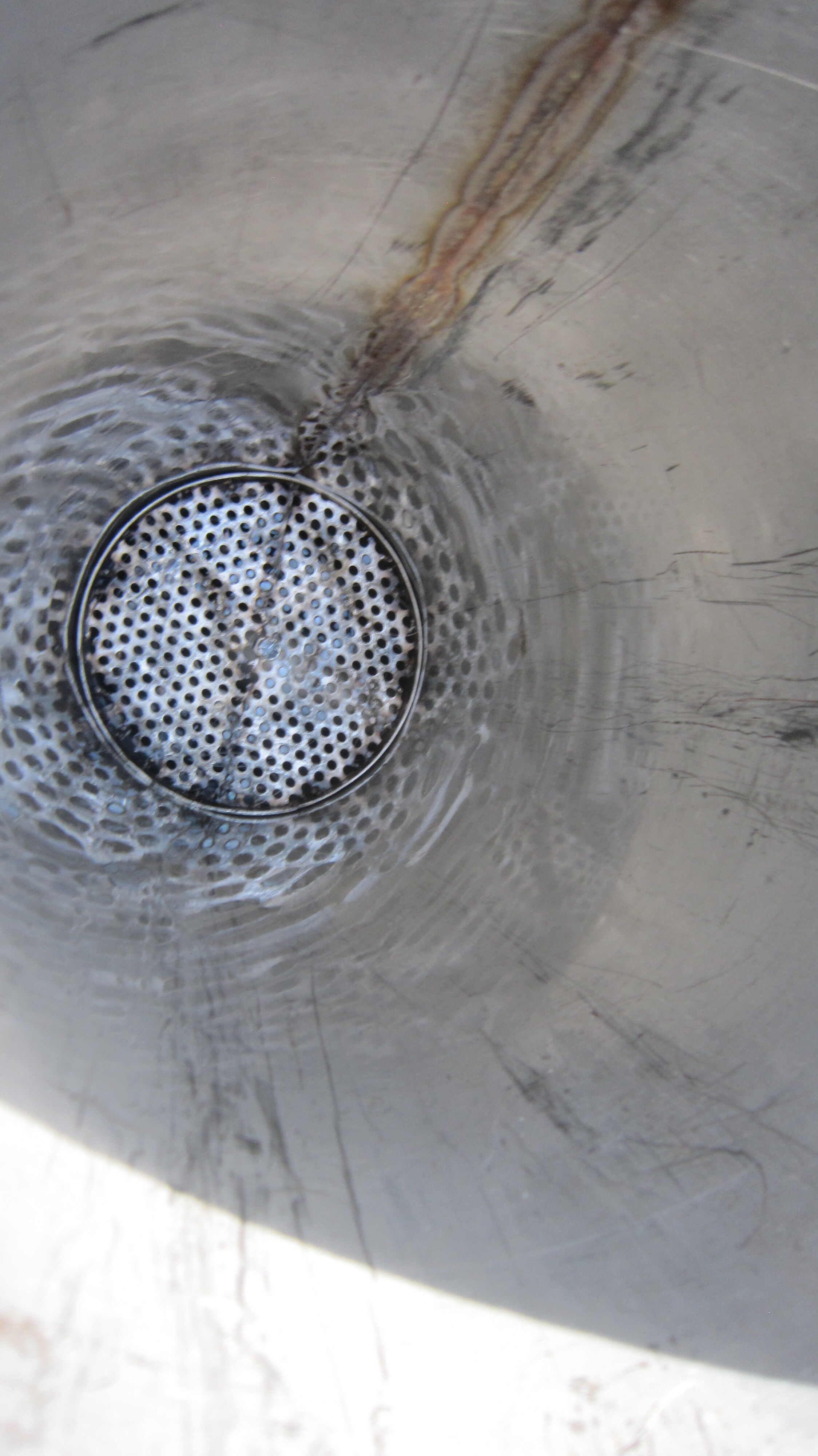

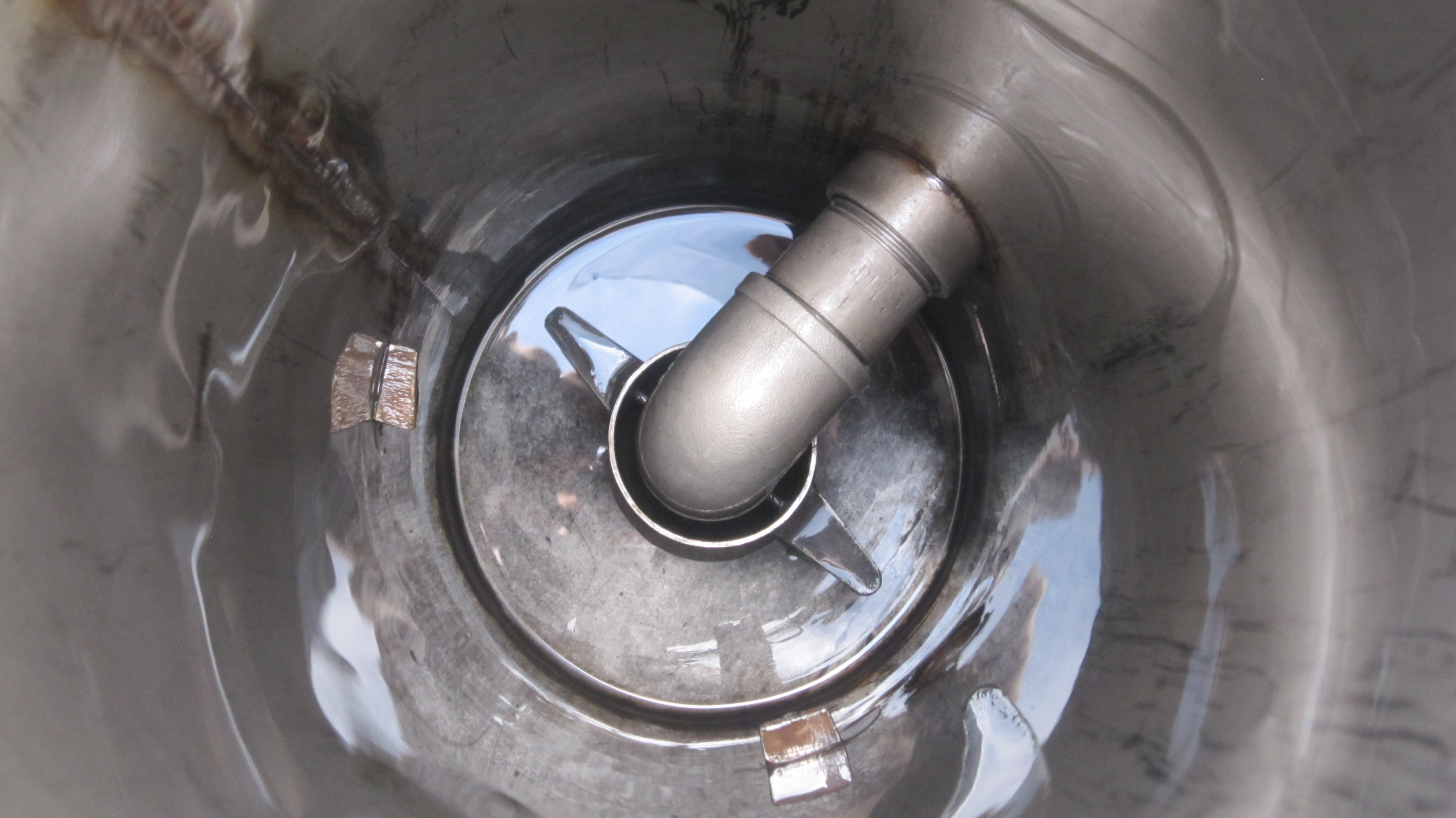

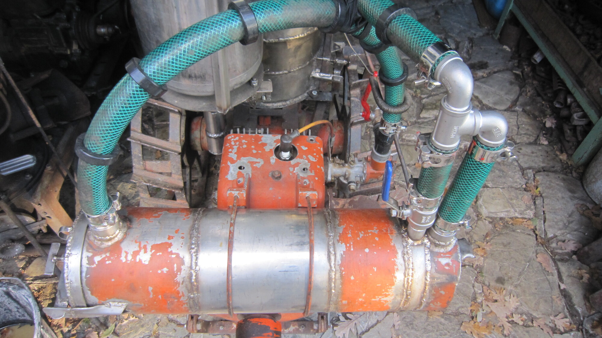

bottom of the filter, under the sheet with the holes is the water chamber

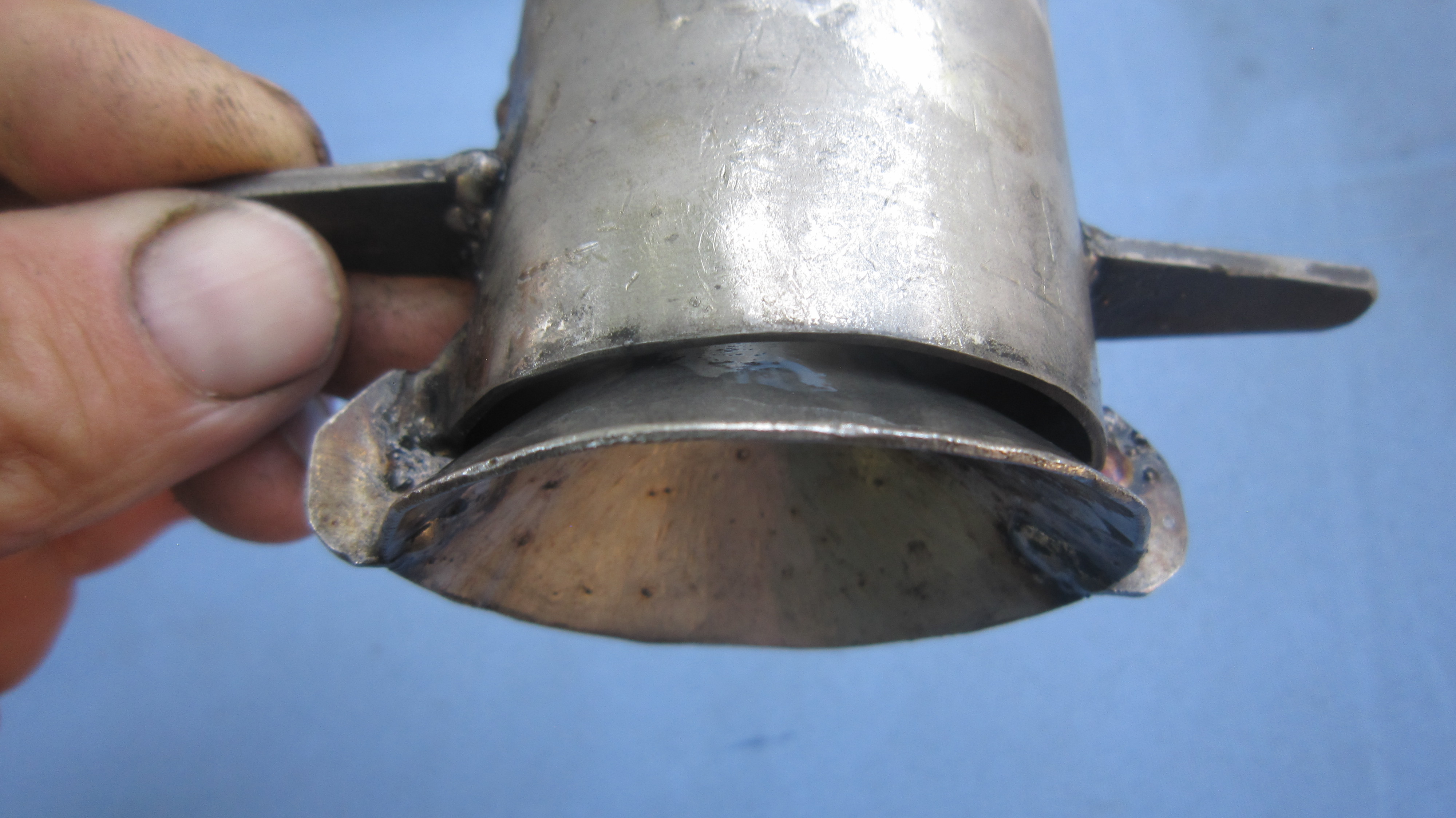

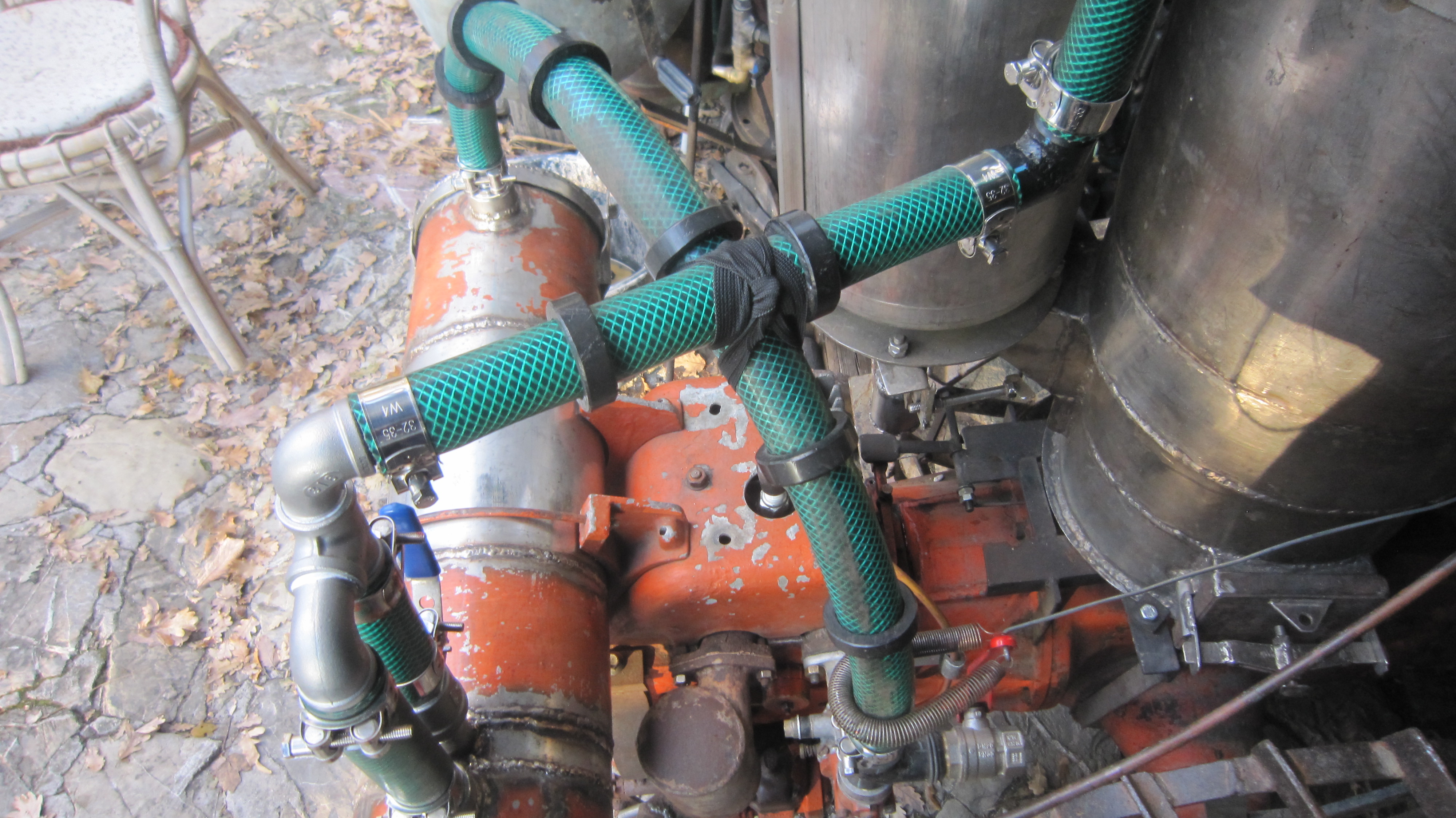

gas reverser and bubbler…
a bubbler with holes makes continuous nice round bubbles…this can be less effective, because in the bubble the dust travels indisturbed…therefore we choosed the reverser for more chaotic insted of regular bubbles…today we added some fine mesh in the gas path for make it more chaotic …breaks the bubbles more often, dust should become more wet…resistance tested with blowing in the tubing system with the mouth, seems not much resistance

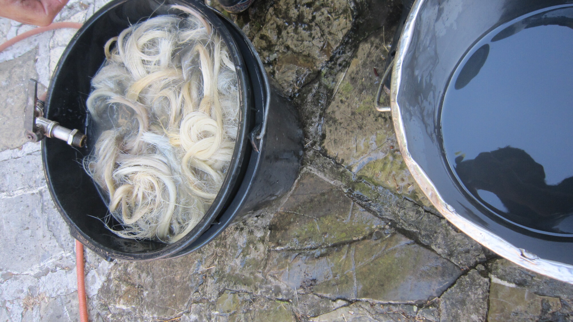

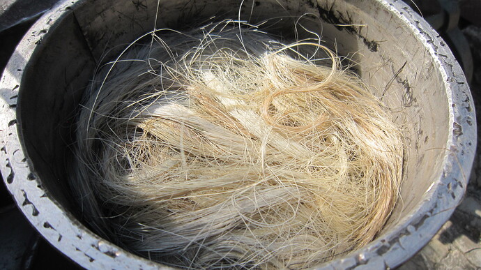

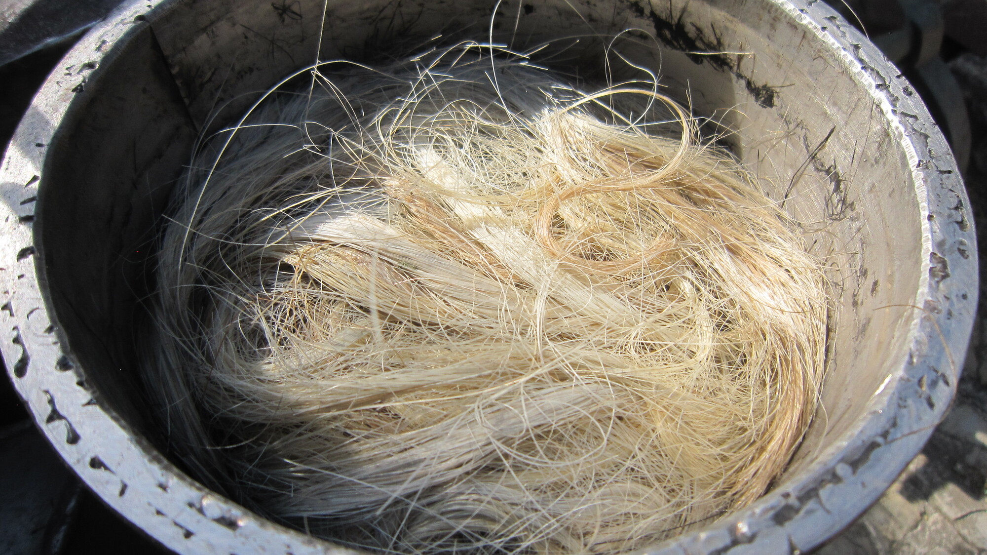

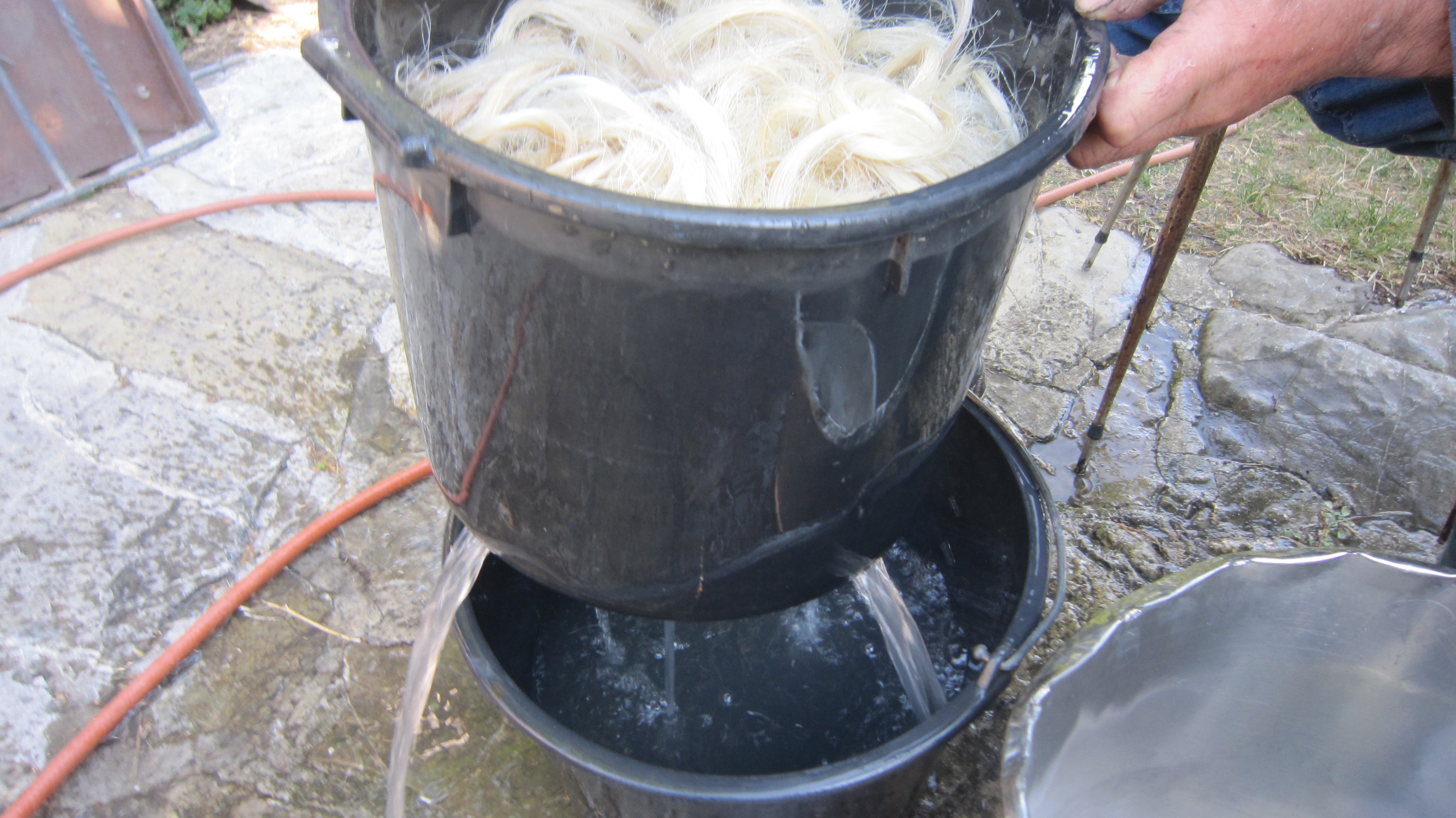

filterwashing…from time to time maybee useful to wash the filter completely, also because i dont know how the hair reacts when staying long with all the dust…
horse hair from my sight seems ideal for this system with daily wash in the filter housing, because it sacks not down when have contact with water, the hair is really pressed in the filter…whith the umidity the dust can clogg together and is stopped there…when i used dry hair system- horse hair or sheep wool-, it keeps not back completely the dust
washing macchine bucket in bucket

the most important especially with charcoal is the control of the big amount of dry dust in the system, a problem what in woodgasifiers exist less because of the higher umidity, i think…

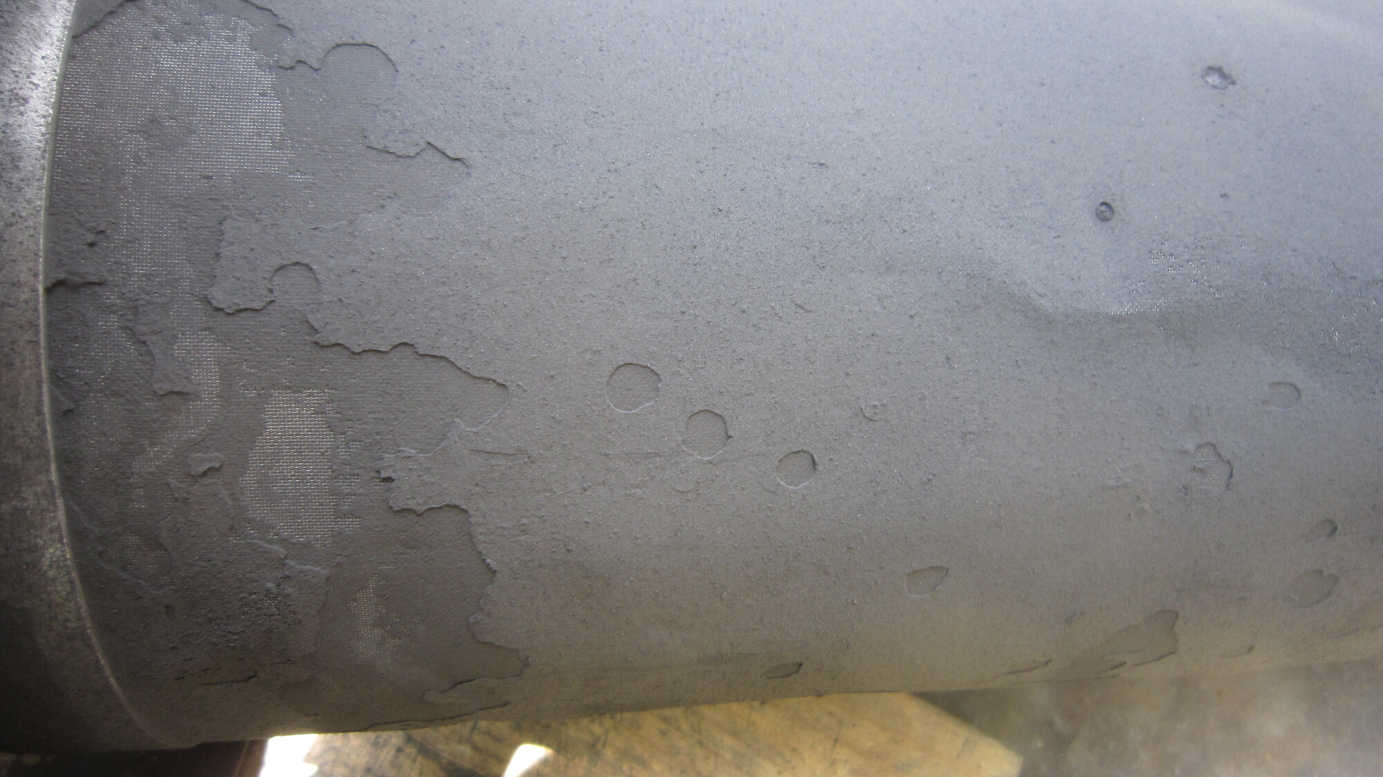

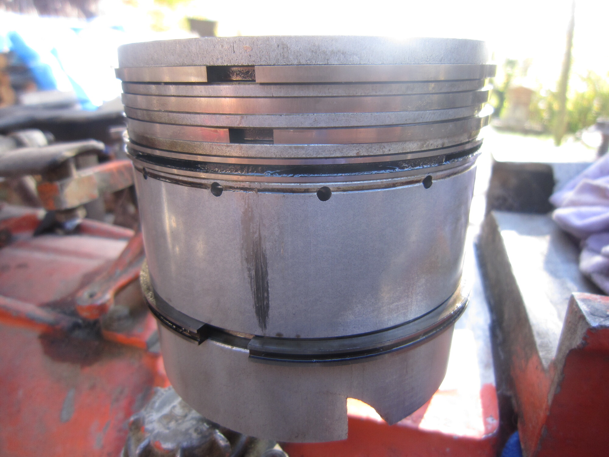

recently we opened the motor of the fim motorcultivator, for grinding the valves…so it was also interesting to see if there is some rust in the combustion chamber because of umidity from wet filter medium…ther was nothing, all looks fine

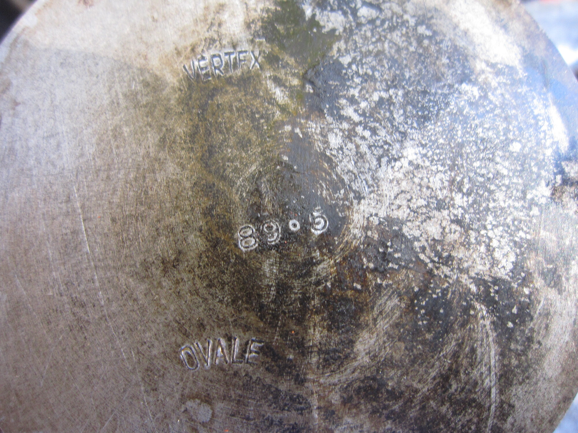

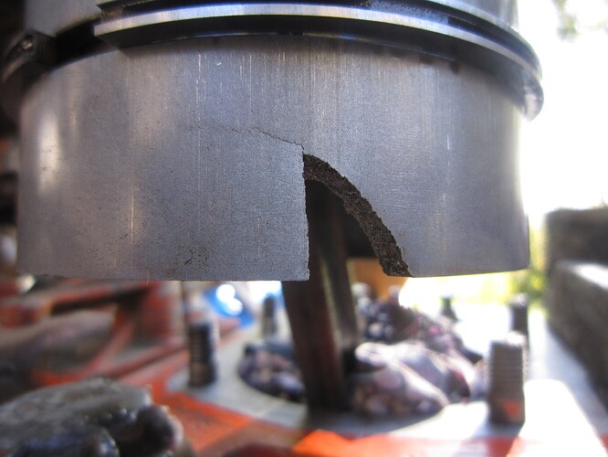

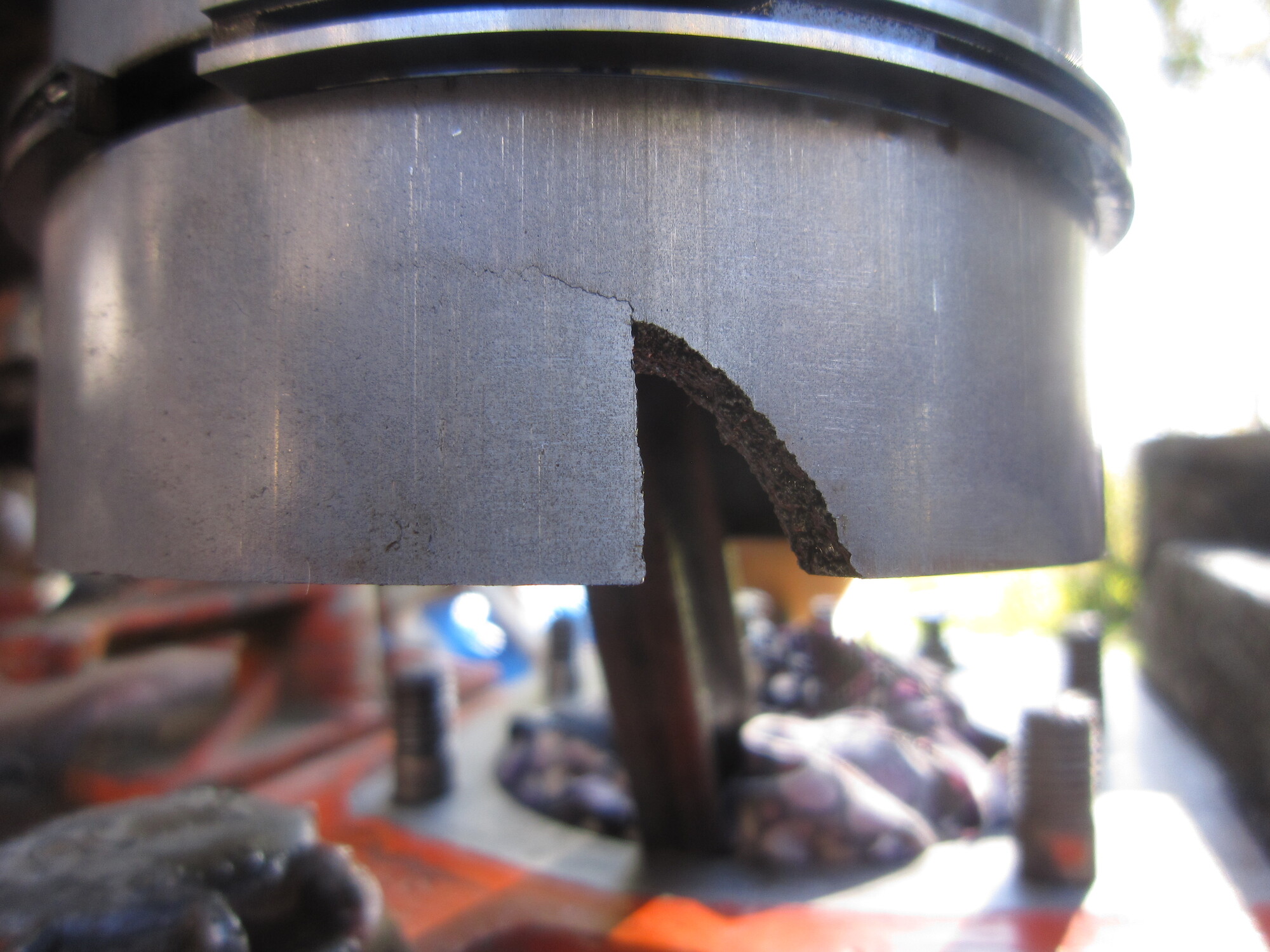

the piston seems threated bad from some recent master mechanics( from him are more traces on the macchine)
a lot of piston rings on the old motors…

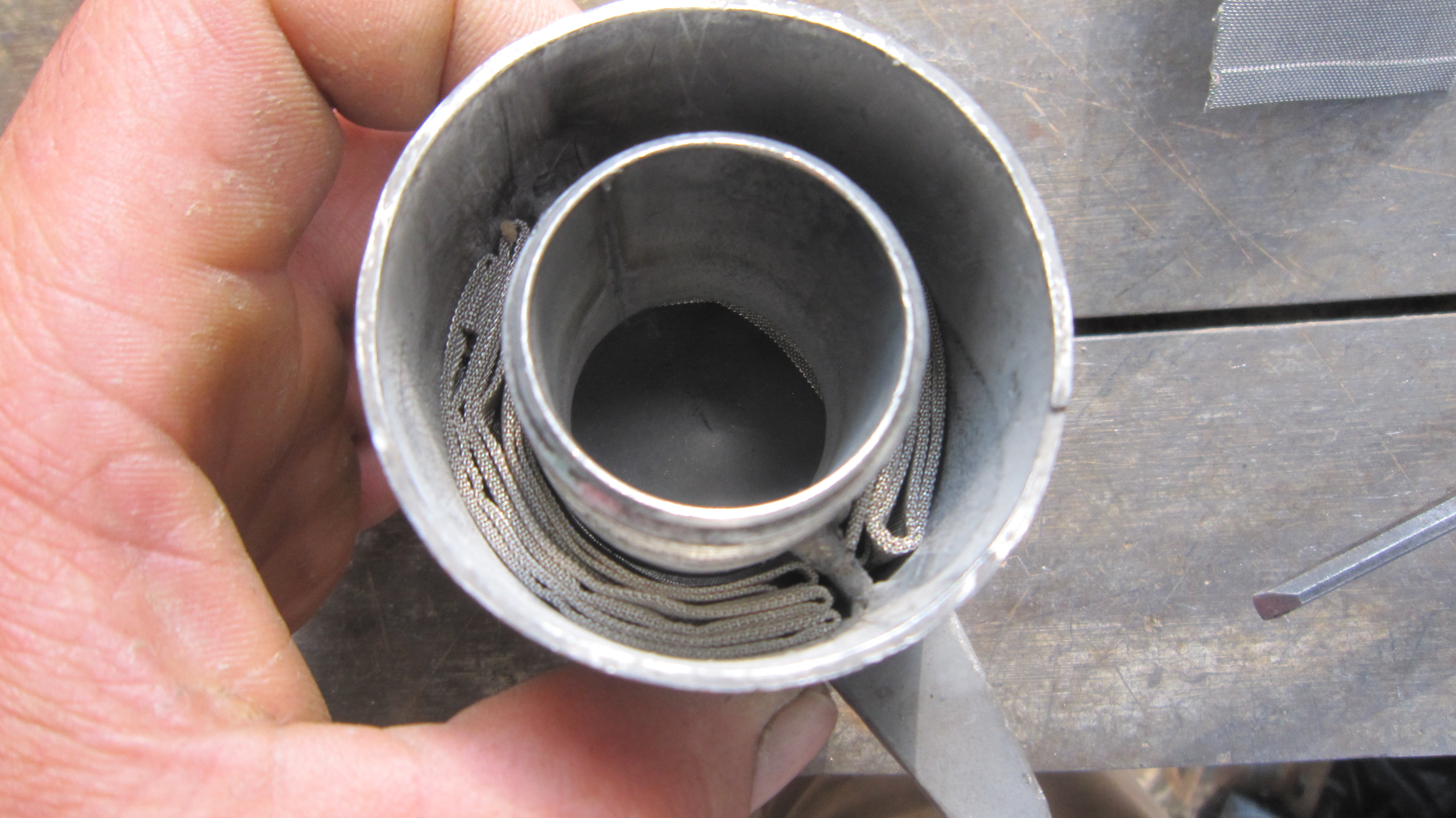

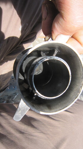

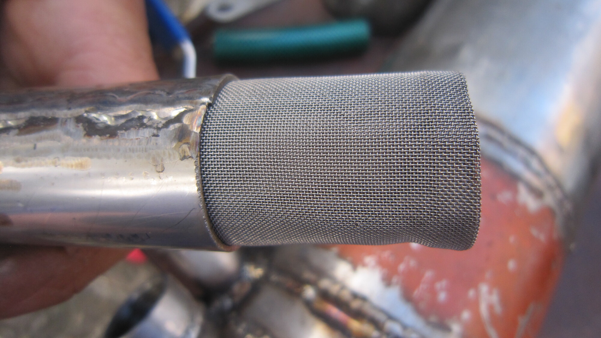

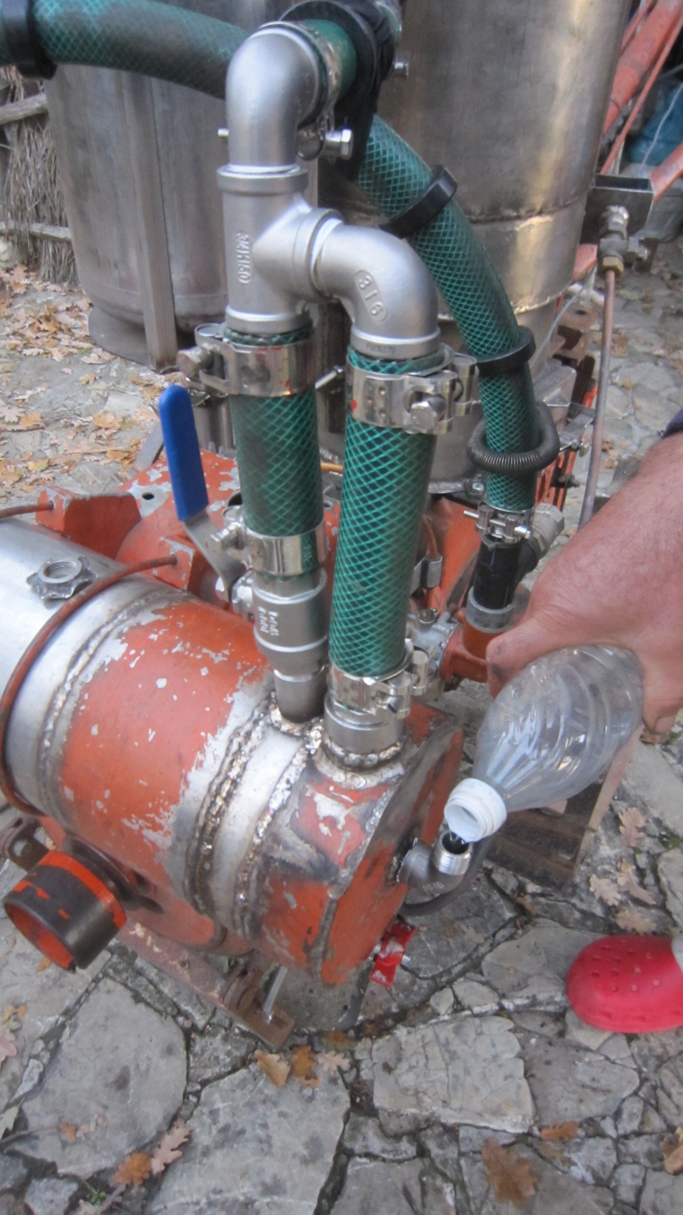

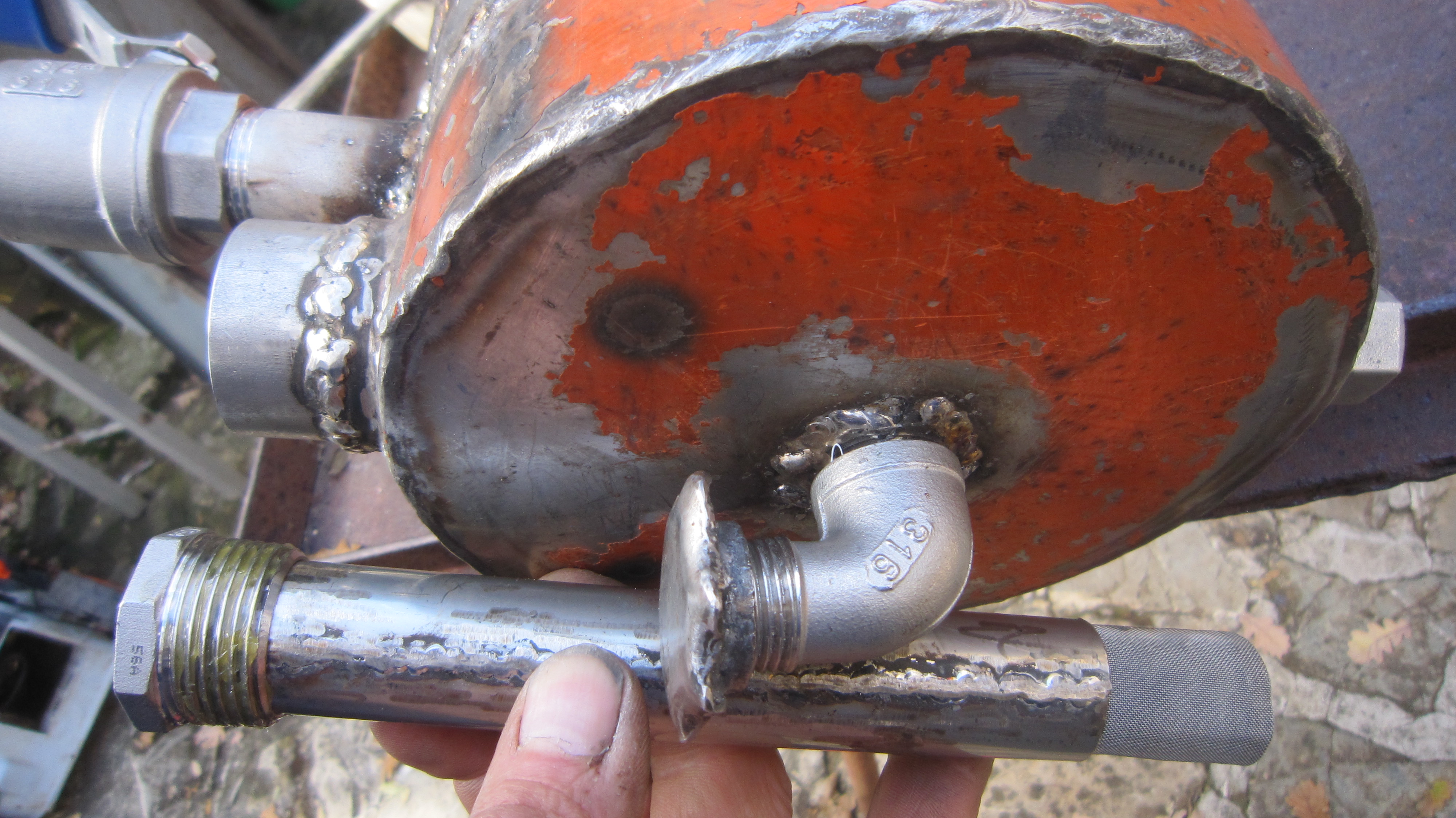

we have modyfied now the filter …added a water bubbler chamber and a start bypass…
here the pipe where the gas enters in the water chamber
a roll of fine net acts as bubble breaker , so big bubbles with dust in it cannot pass through, and also the finest bubbles get braked while passing through the roll of fine net
the net on the foto seems more coarse as it is in reallity , because the foto is taken from very near
