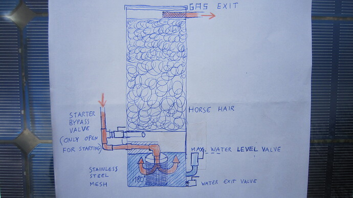

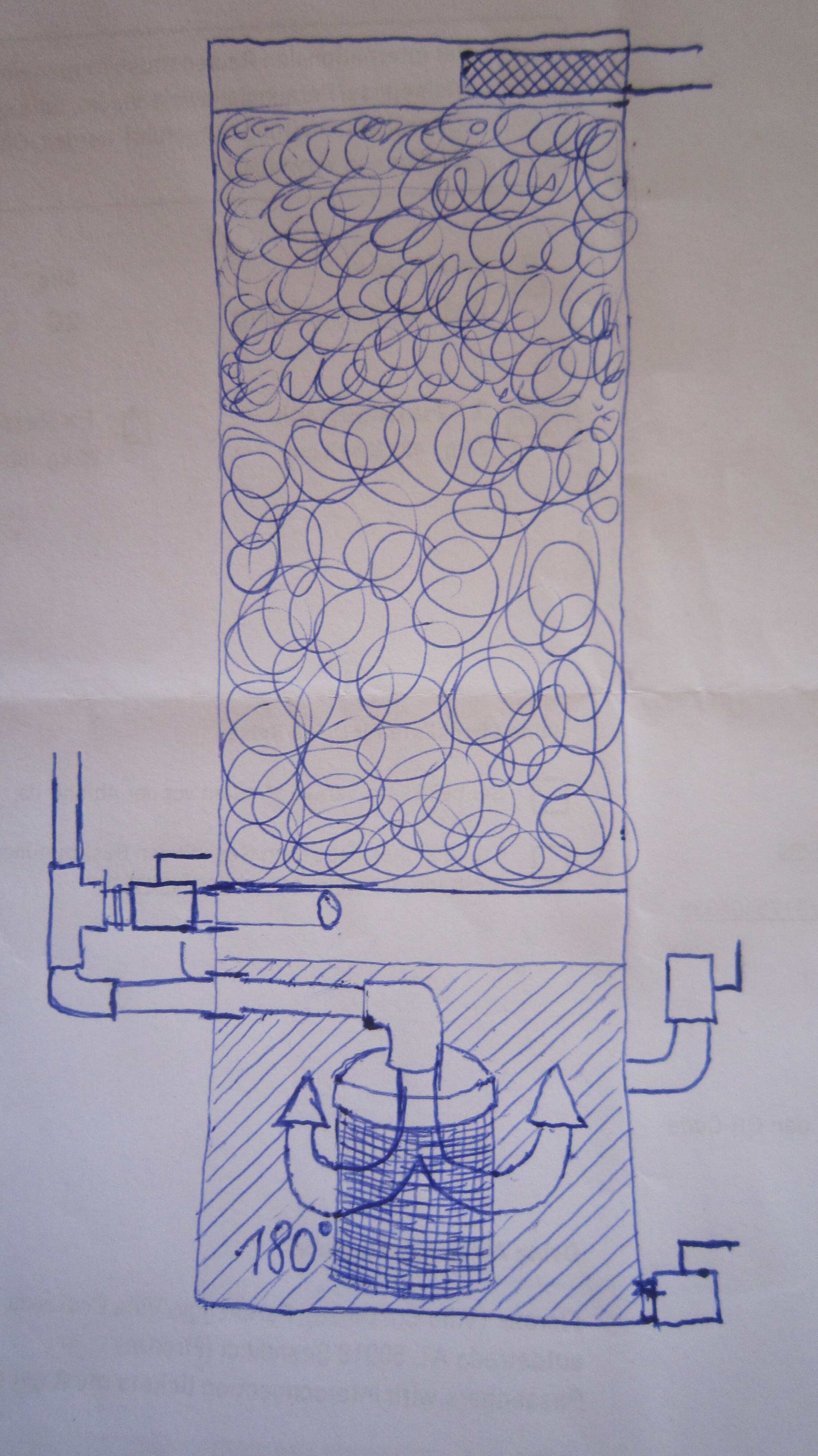

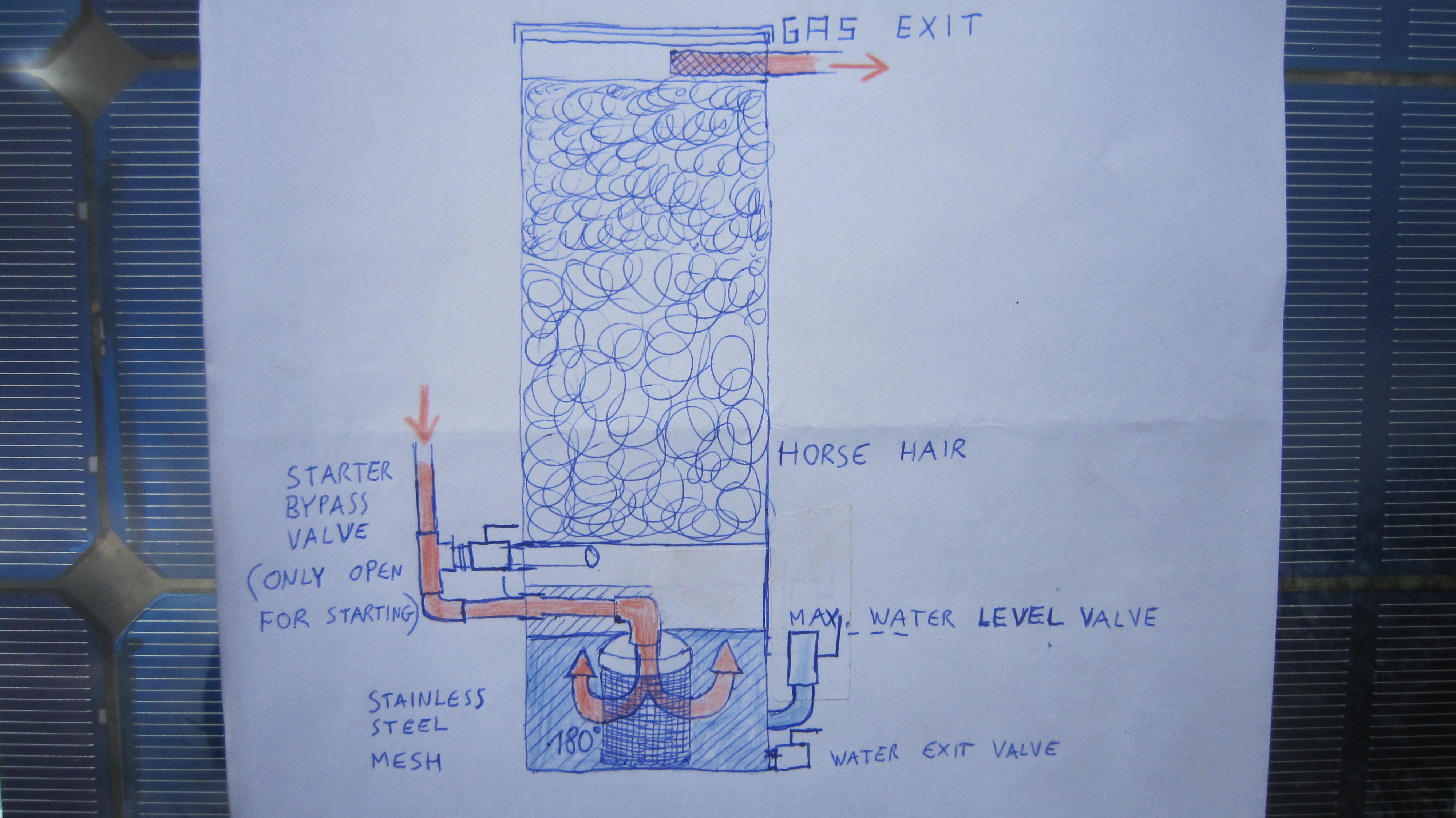

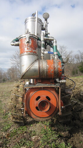

a design from my son of a ideal gas washer, vertical with starter bypass and bubble breaker nets
the water level is designed wrong, must be under the horizontal gas intake pipe, otherwise the pipe is full of water that makes more resistance

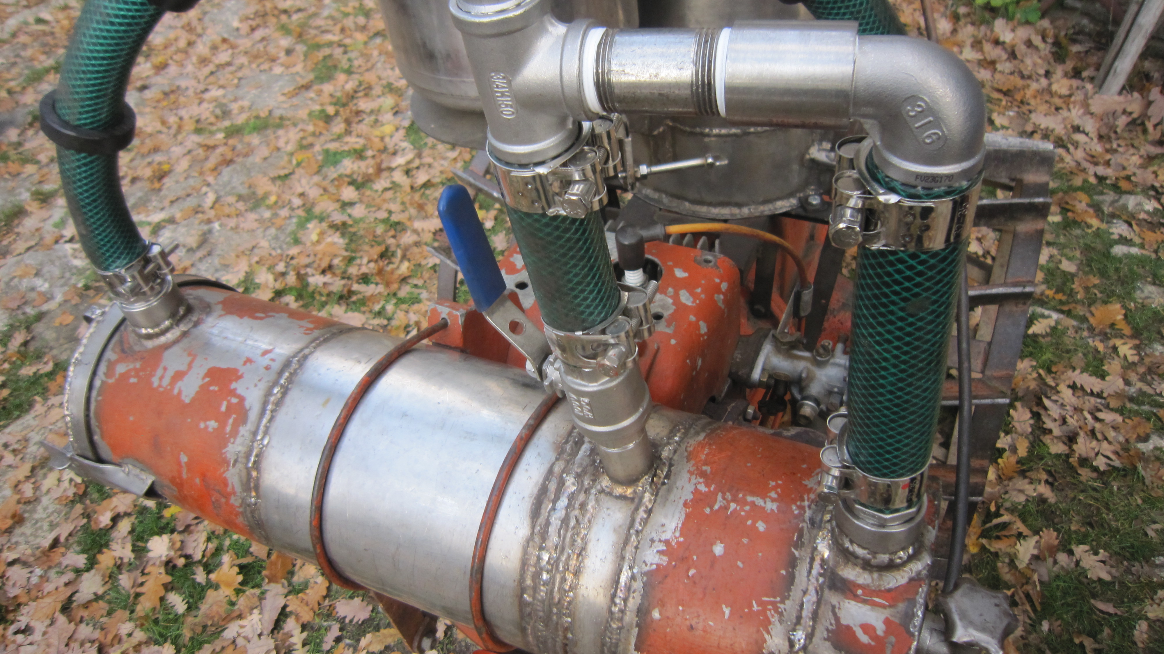

today afternoon a test run, but the water chamber is too small, i must modyfie it downwards.
the vertical position is best, when there is space
today afternoon a test run, but the water chamber is too small, i must modyfie it downwards…better is always a vertical filter, when there is space

oil bubbler i try to avoid because it makes a mess in the horse hair filter, i like to have systems what i can clean easy with water…i improved my filtering till the point that the intake - mixer valve is clean…more difficult to achieve with only dry filtering, when we speak from charcoal gasifiers…yesterday we made the water chamber bigger, today another test run, but as said, vertical filter is more optimal, because the water can fall down by physical laws

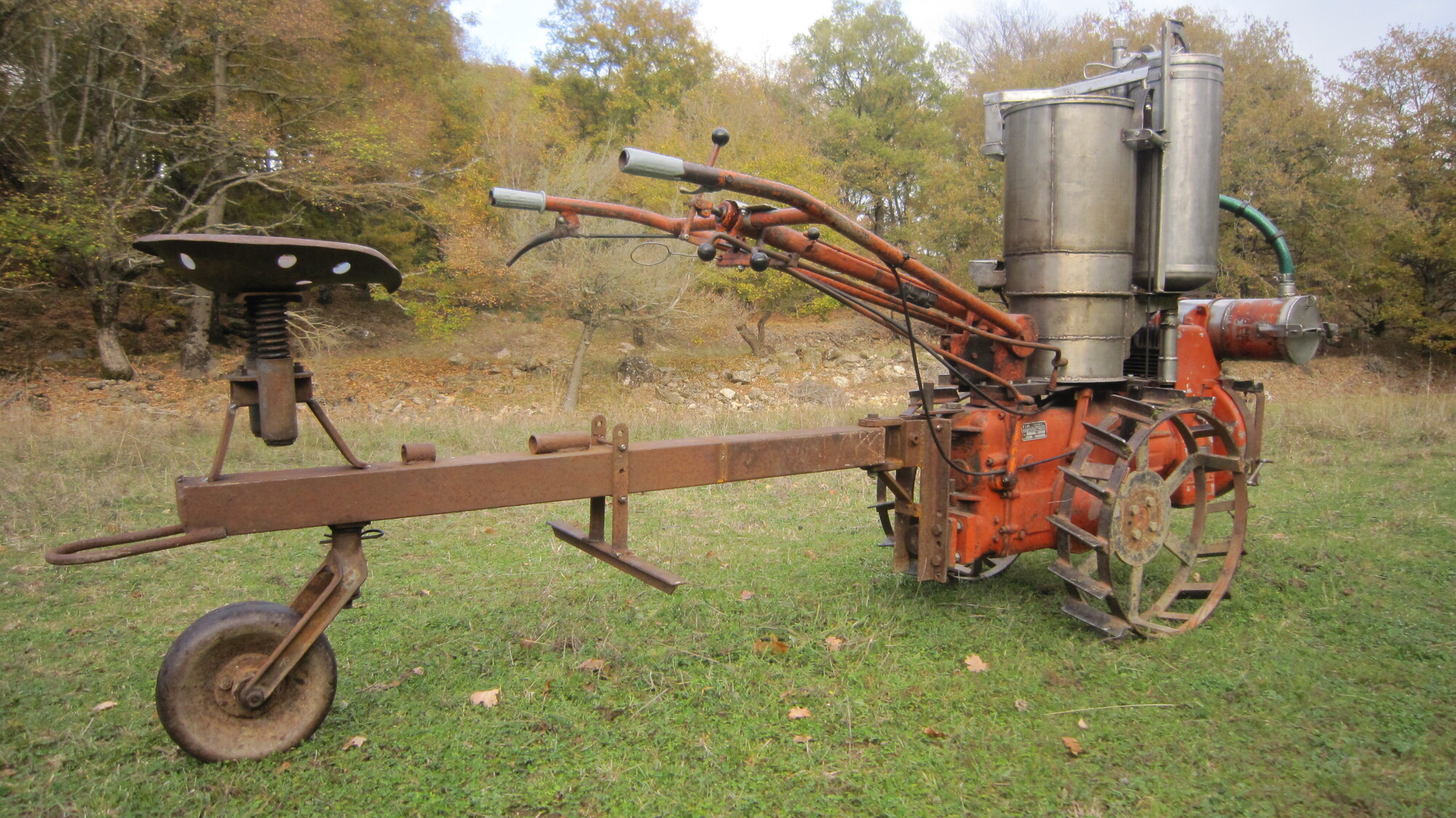

at least a funny vehicle comes out, a seat for lazy farmers, light and versatile for our future seed machine…the bcs seat is excellent with his springs.
in the afternoon some more test run with the bigger water chamber
with the horizontal filter it comes out at least that is best to keep open during run also the starter bypass, so there are less turbulences in the water chamber, a little part of the gas stream goes through the water and keeps the filter medium umid, what gives a better filtering as when it is too dry or dried out during operation by the warm gas…this amount of gas that goes through the water can be regulated with the valve, more close the bypass valve, more gas must go through the water bath…but, as said, vertical filter is easier and more safe in operation…here on the motorcultivator though was no space for it so we used the basement of the former gasoline tank
at least we modyfied the filter, so umidity from the horse hair filter medium can drop down, obviously better…compromise is good, more perfect is better…content max 2 liters of water

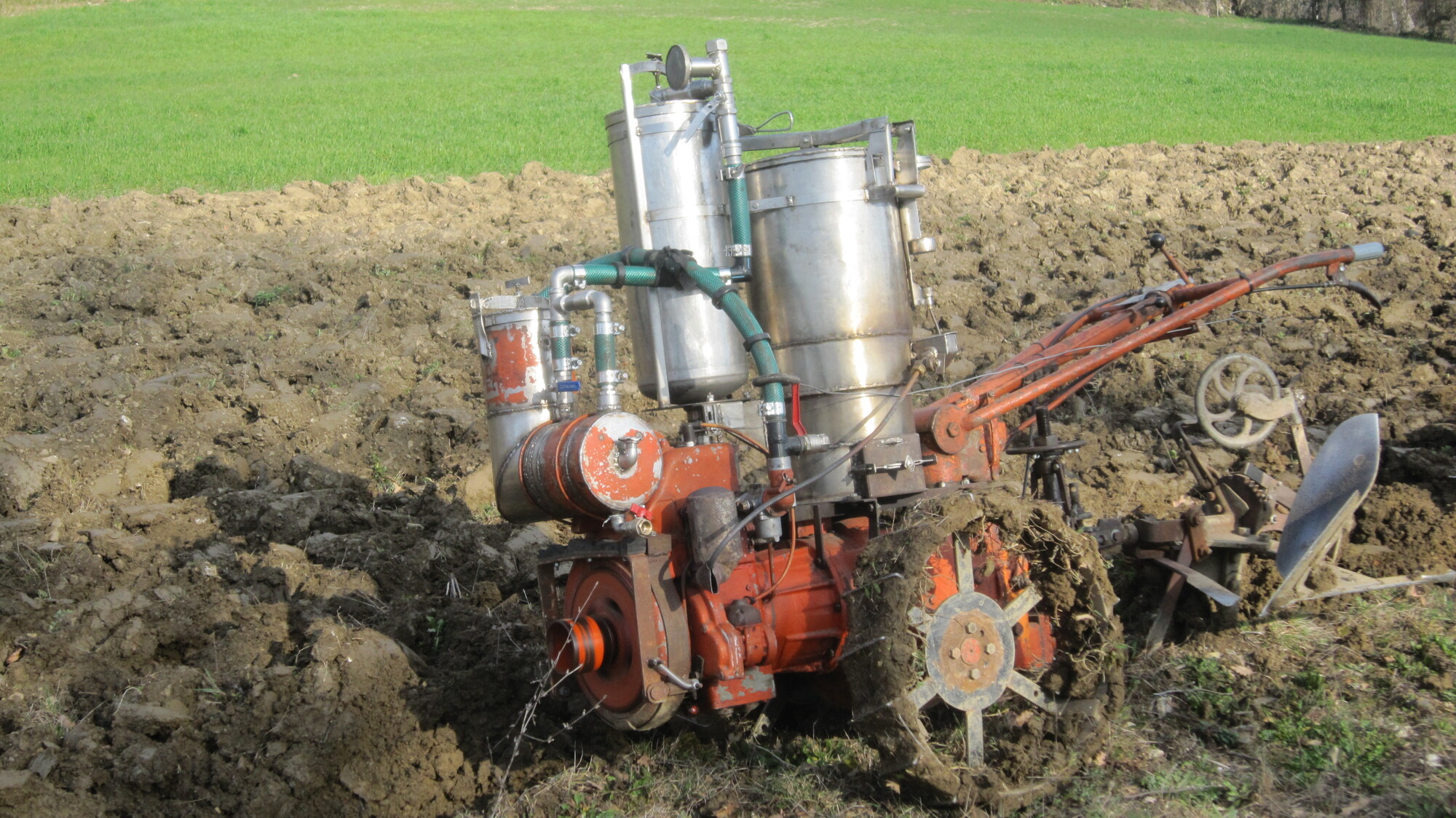

today and yesterday we plowed also, not knowing that tone also does…
in background the wheat seeds from october
nice when the motorcultivator runs without holding the steering pipes, also 20 meters lenght…this is possible with differential blocked and when there are not too much stones in the ground

Giorgio,
I have read with much interest the development of your water bath chargas filter. I would like to see a drawing of your latest design. I have mostly used dry filters, but as you have reported, dust still gets through. I run updraft gasifiers and also have limited fabrication stills. Could you suggest a super simple way to build a filter system similar to yours?
hello steve, here my son has drawn a scetch of the filter…in my topics of the fiat crawler and pasquali you can see detailed pictures…how to build easy? maybee in plastic if the gas in this position not is too hot…as there is water, normal steel will make quickly a lot of corrosion…vertical is the best system because the water can drop down.
