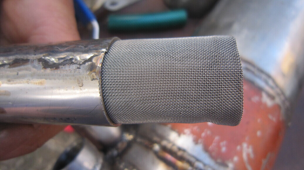

i think the work is relly worth…yesterday for couriosity i opend the throttle block of the pasquali, a pleasure to see, really clean…
can you weld? gas intake pipe in the water reservoir can also be a simple pipe , where some rolled net fits in and touch the bottom for not falling out, the diameter is completely covered from rolled net…i think the good cleaning effect comes from this element, because big gas bubbles cannot pass through, in this way also dust in the bubbles cannot go through…the turbulence in the water bath keeps also the filter medium always a bit umid, in the bottom also wet, so a rest of dust what is not washed out in the net remains here

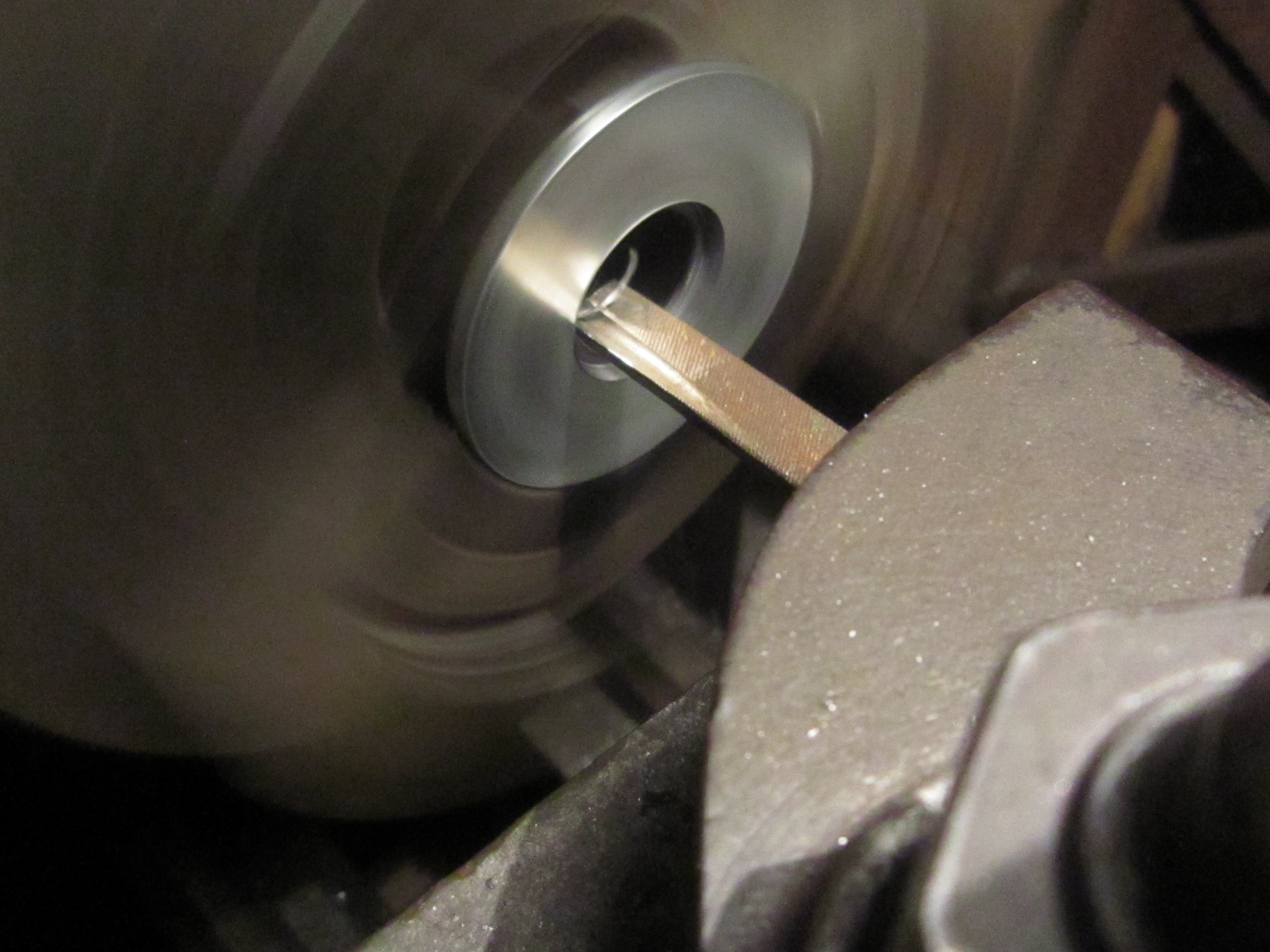

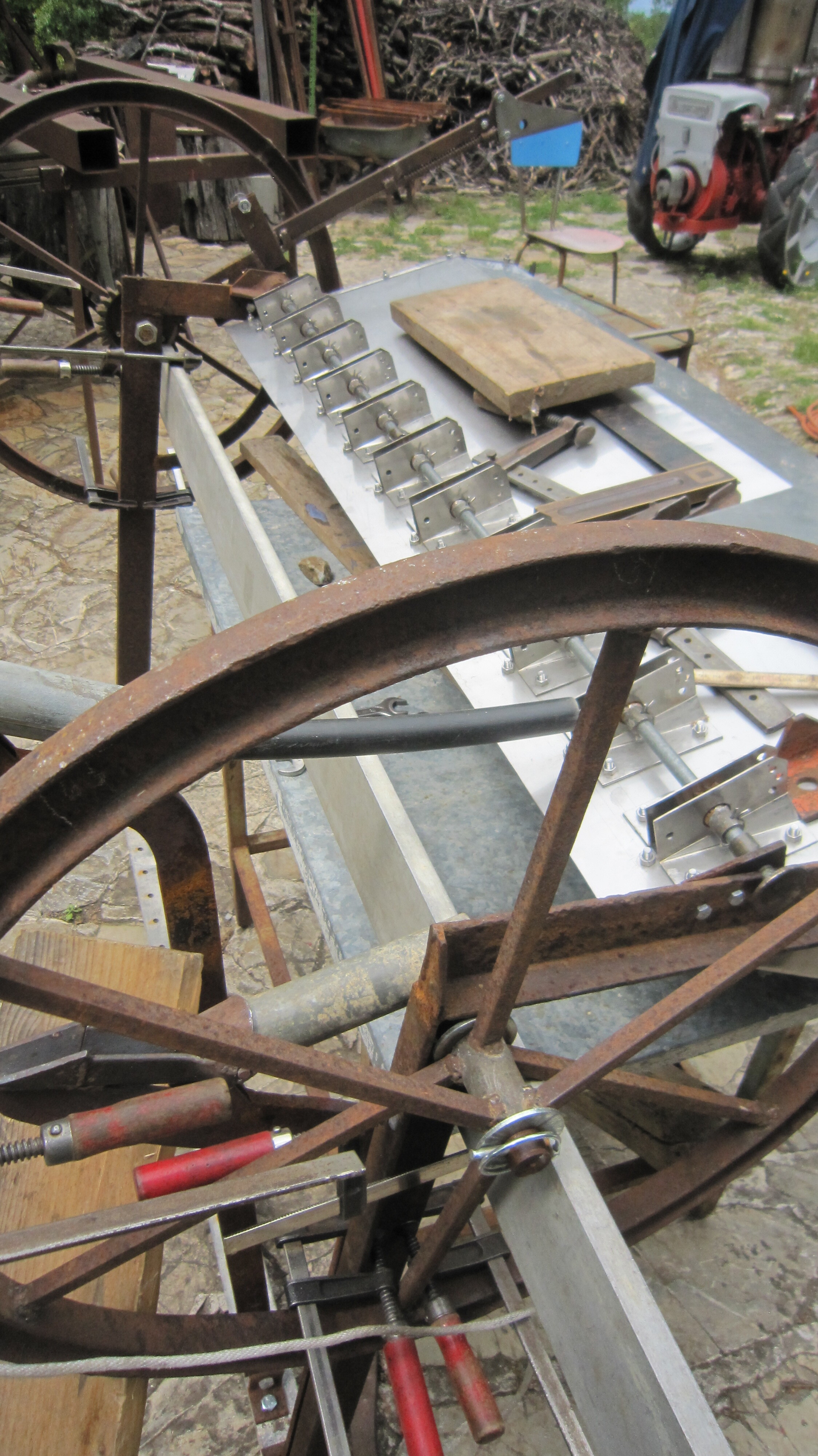

with a old triangular lime can be built a tool for the lathe for working on small inner diameters…i hav needed it for the seeders distribution wheels…
