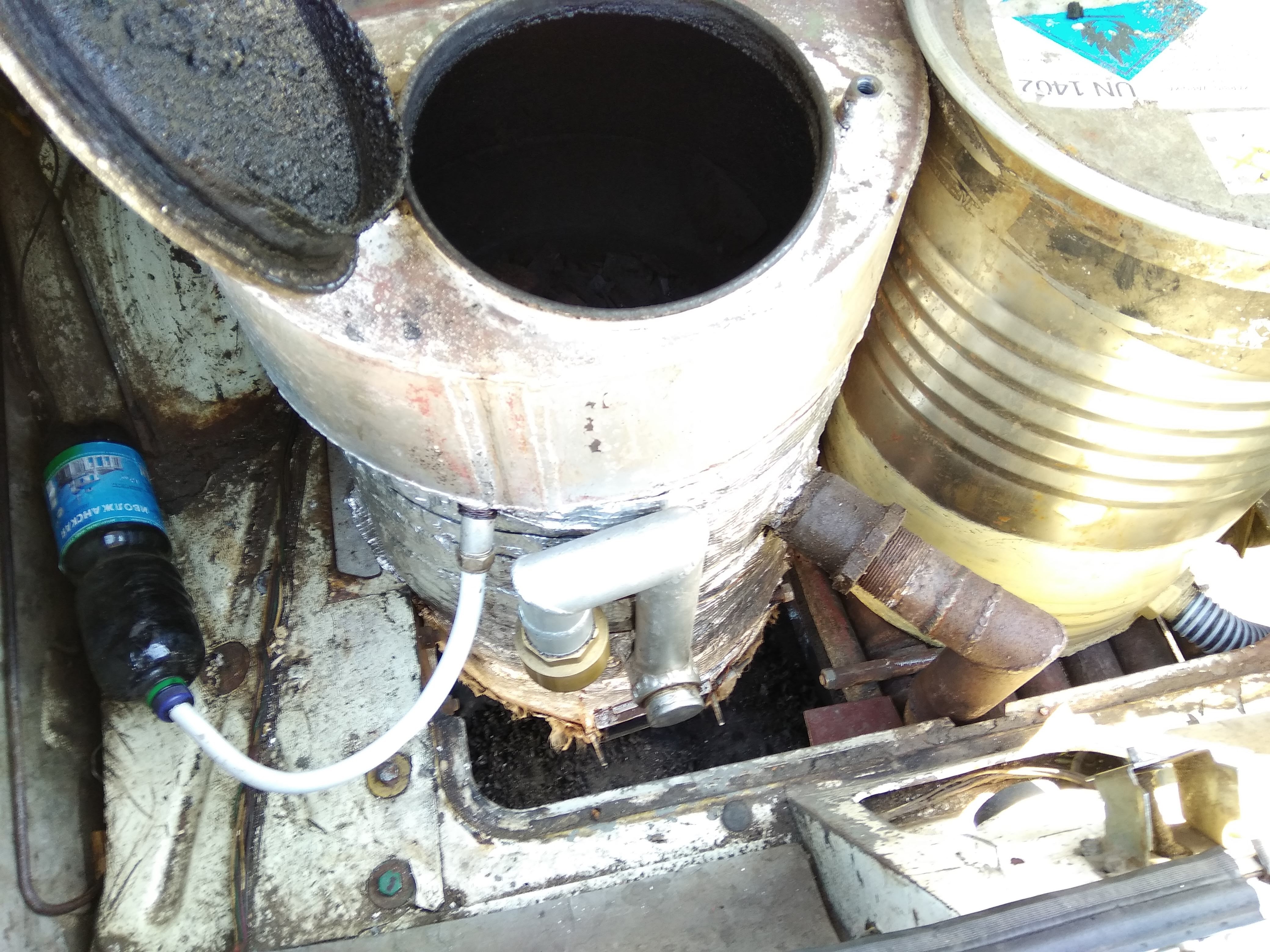

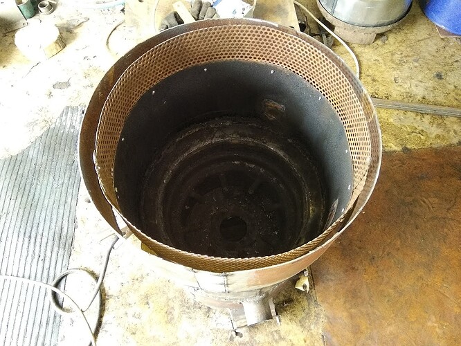

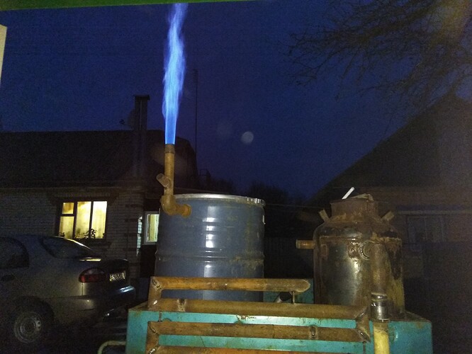

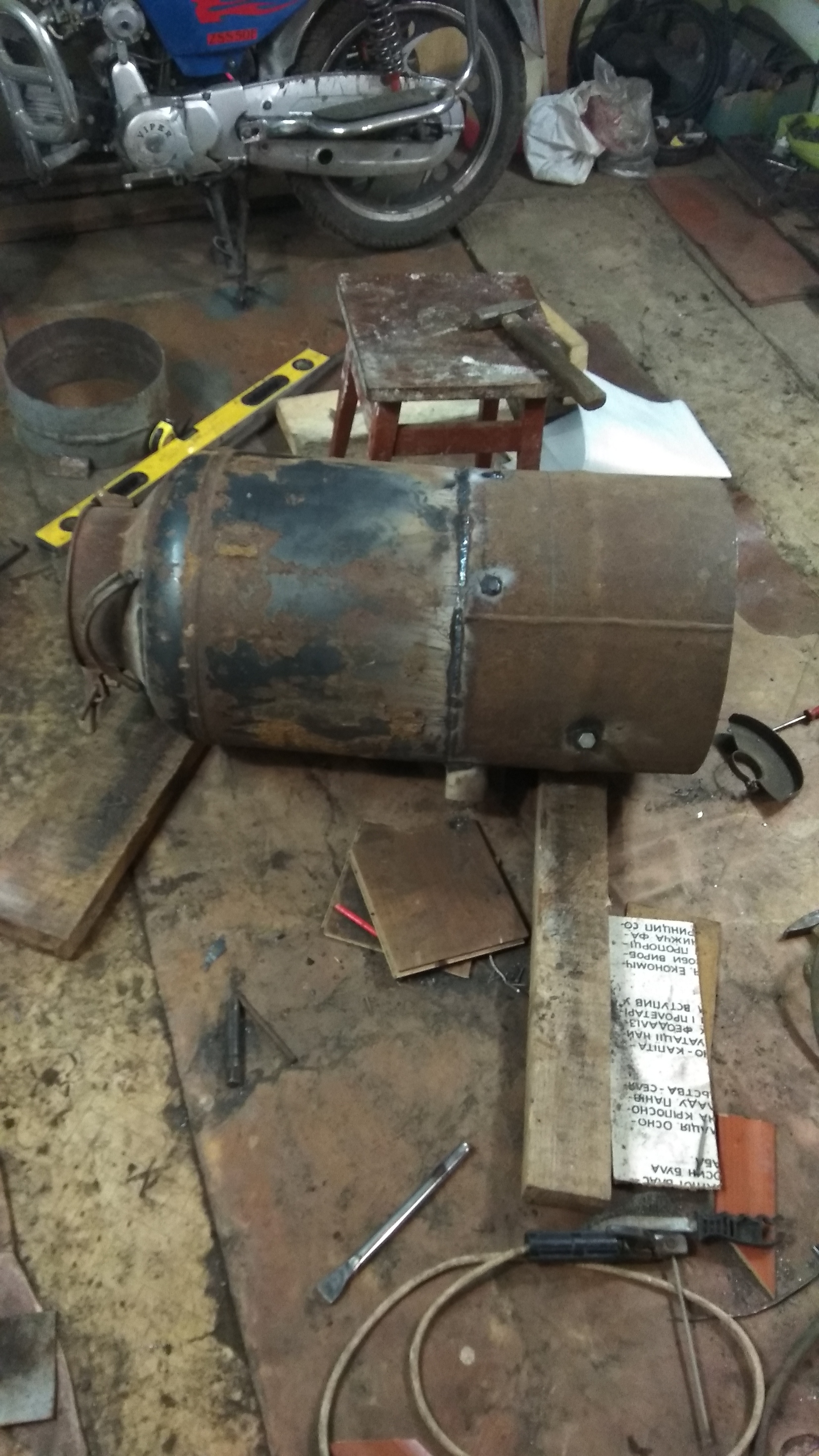

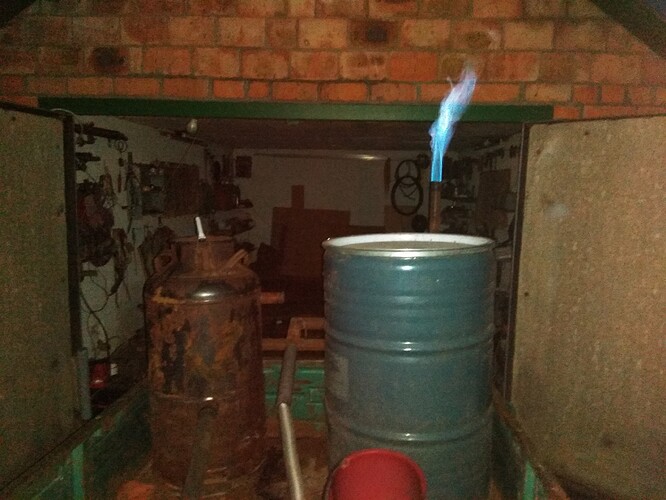

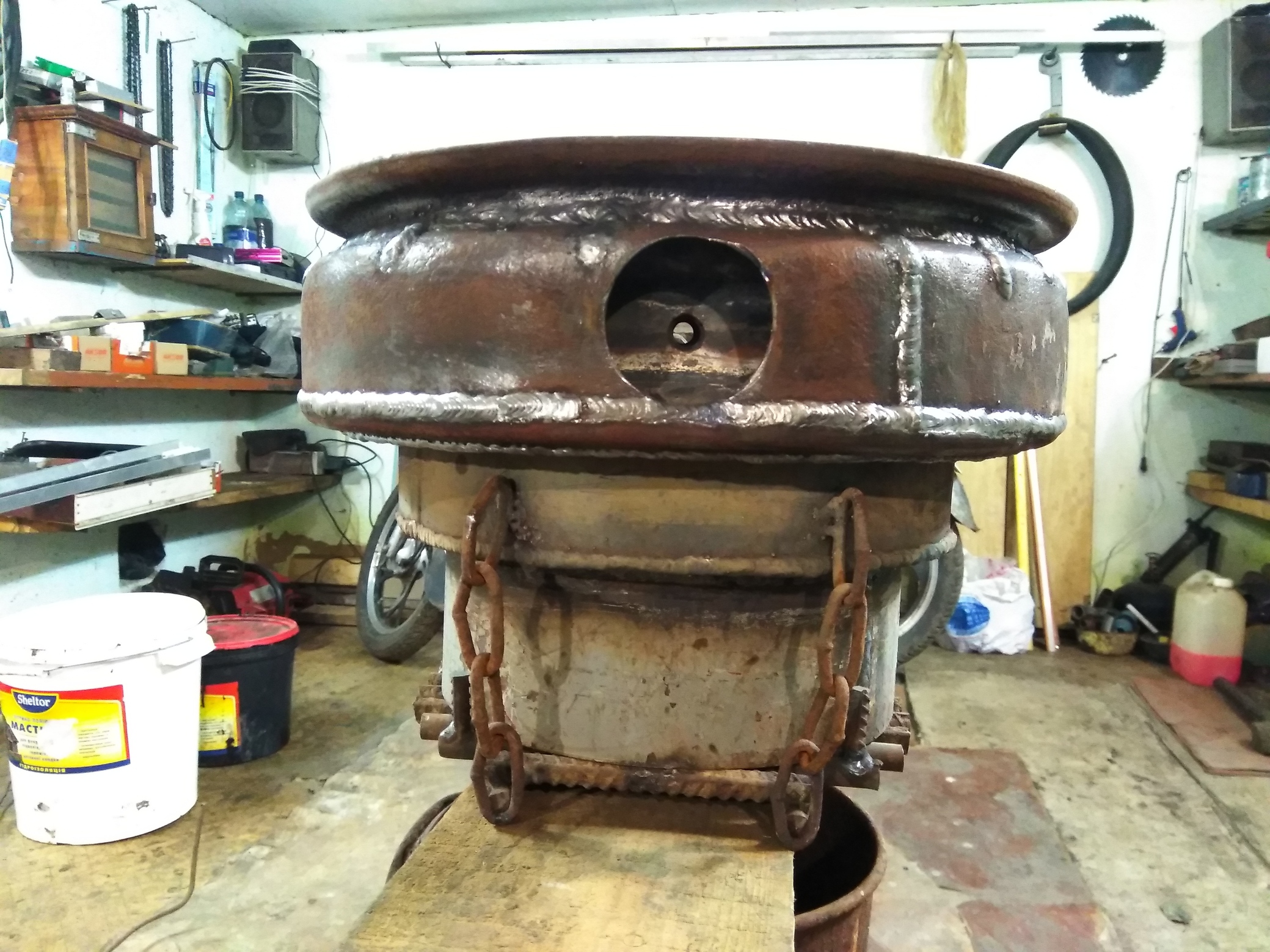

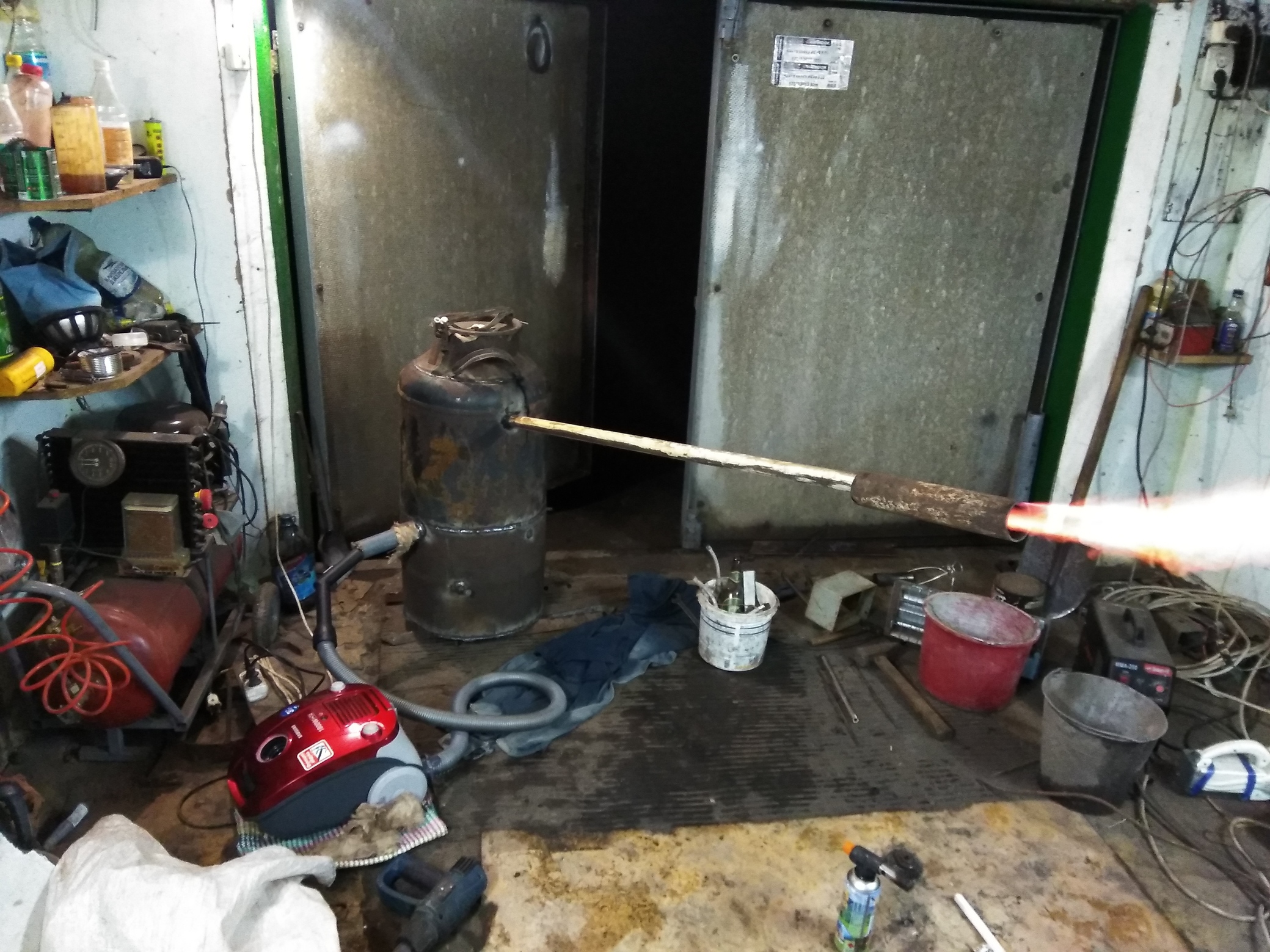

My gasifier on m 412.first launch of the gasifier on chocks

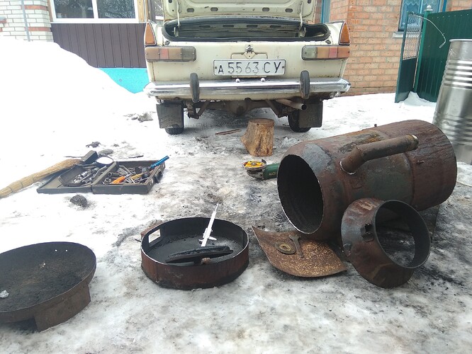

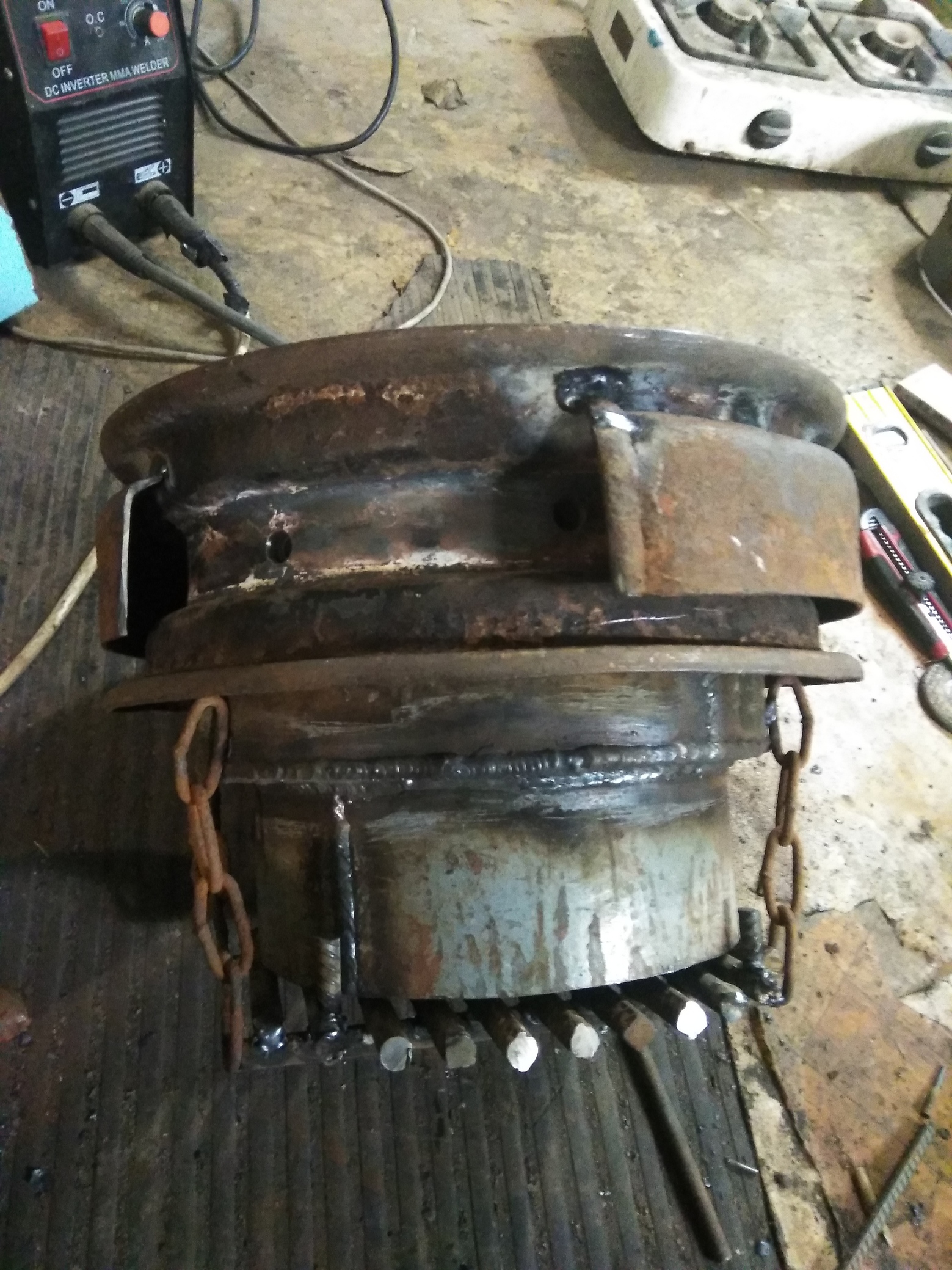

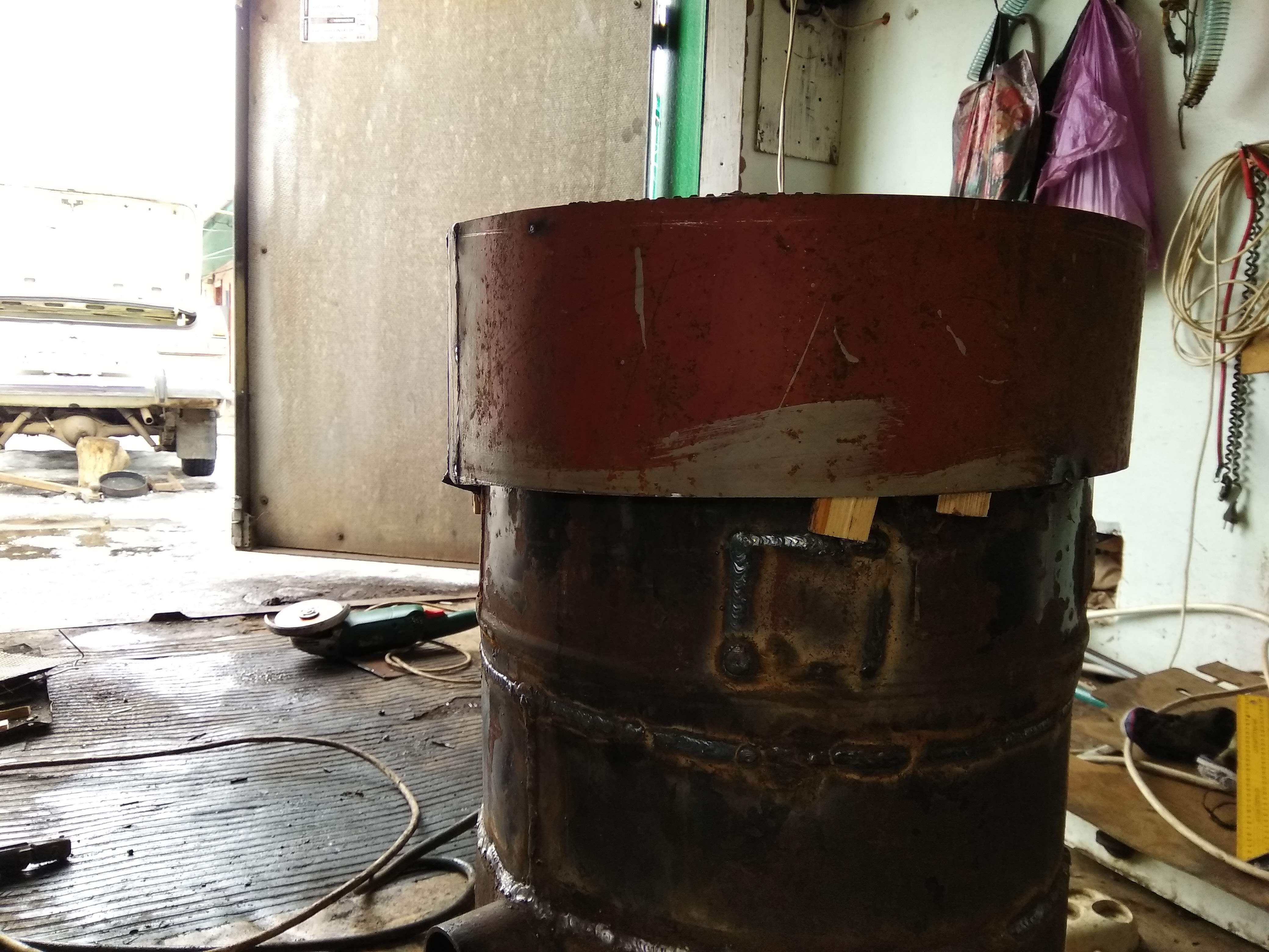

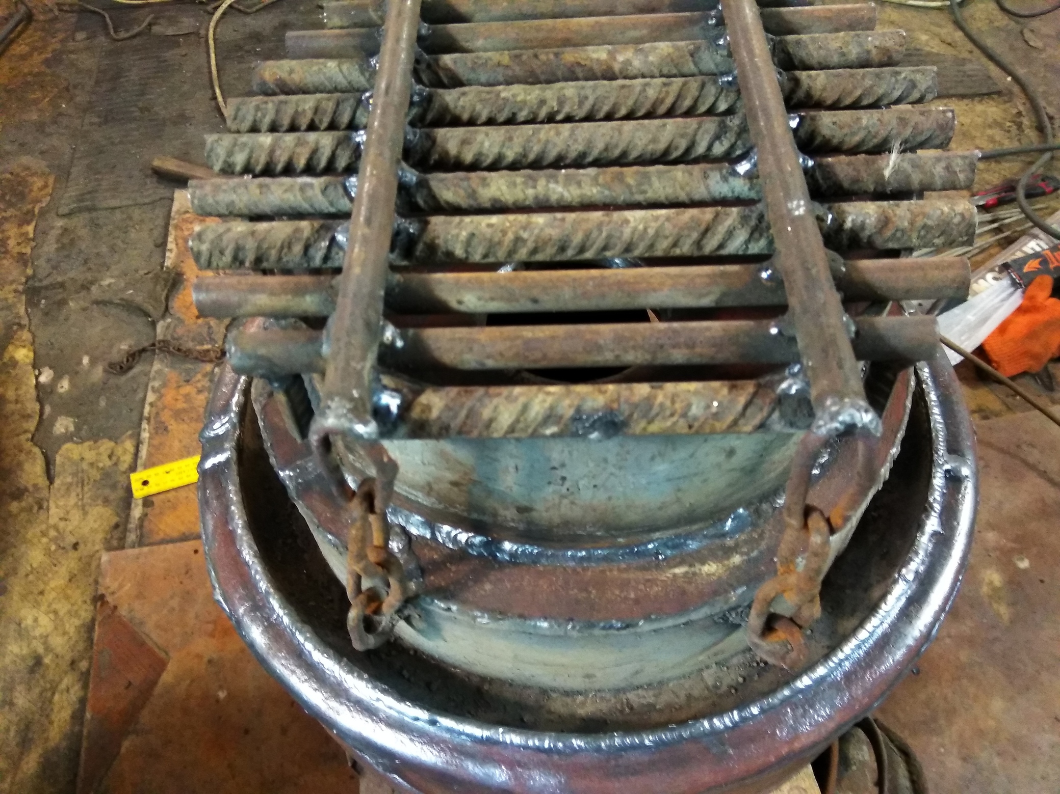

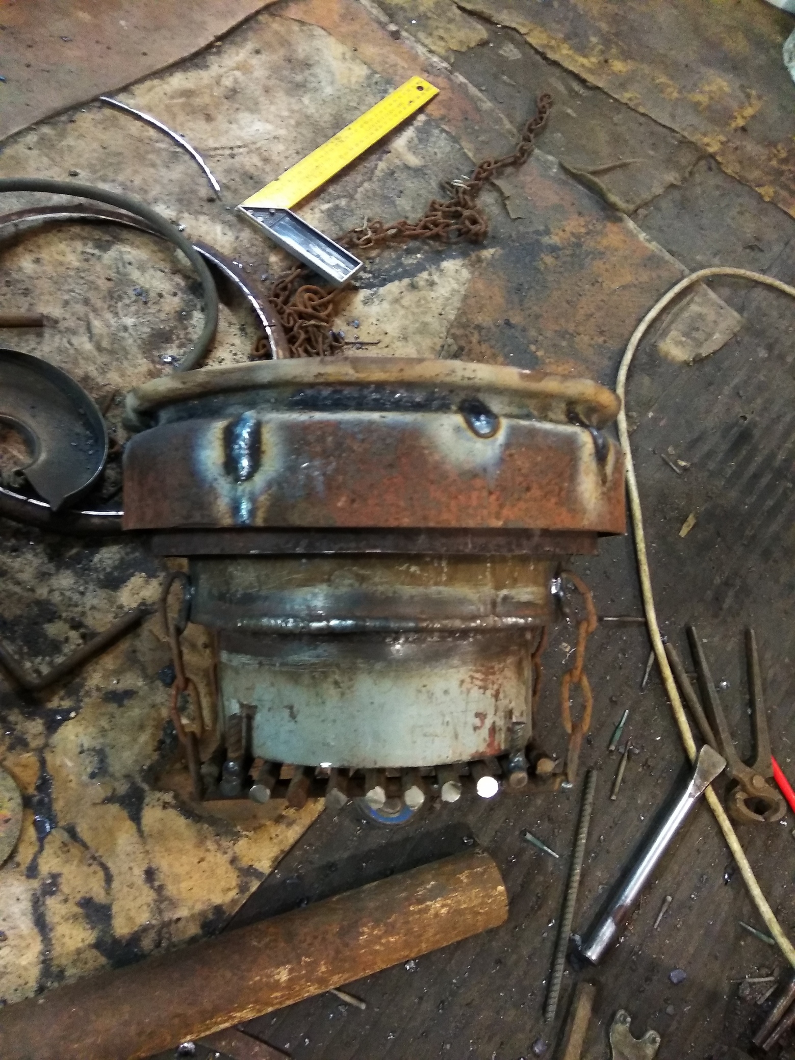

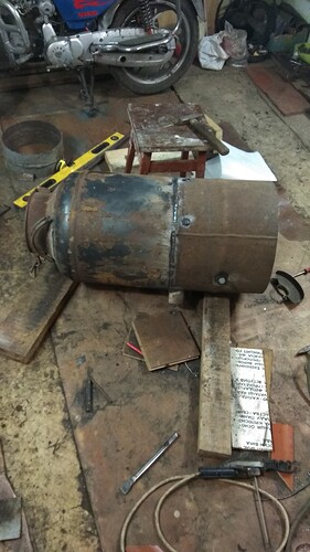

the process of building a gasifier on m 412.

Wow, that’s an impressive build. And nice welds.

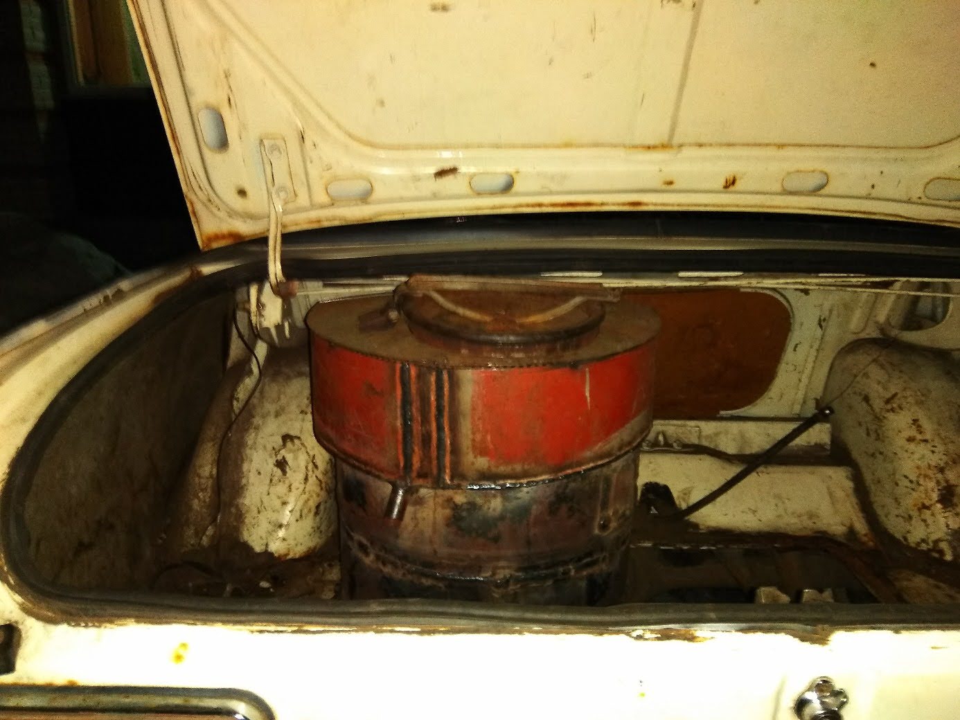

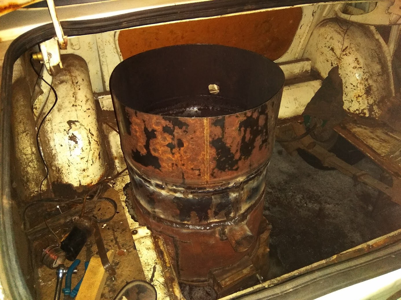

I never realised you even had a condensing wood hopper. What about heat in the trunk? Does the hopper get cooled enough?
How many meters of cooling pipe before entering the sawdust filter?
What about gas mixing up front?
100% wood? No gasoline option?
I’ll save a few question for the others to ask :smile:
Oh, one more. Any problem with smoke in the car after shutdown?

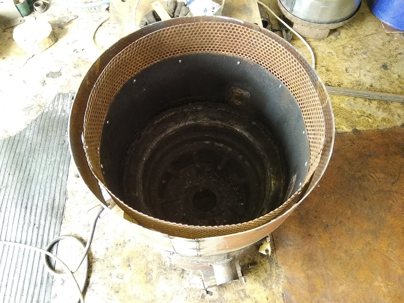

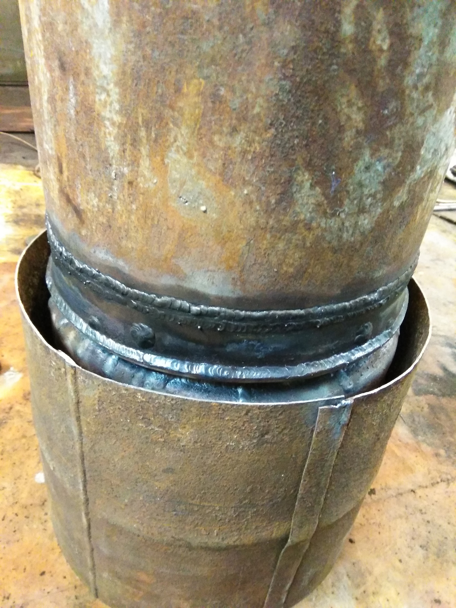

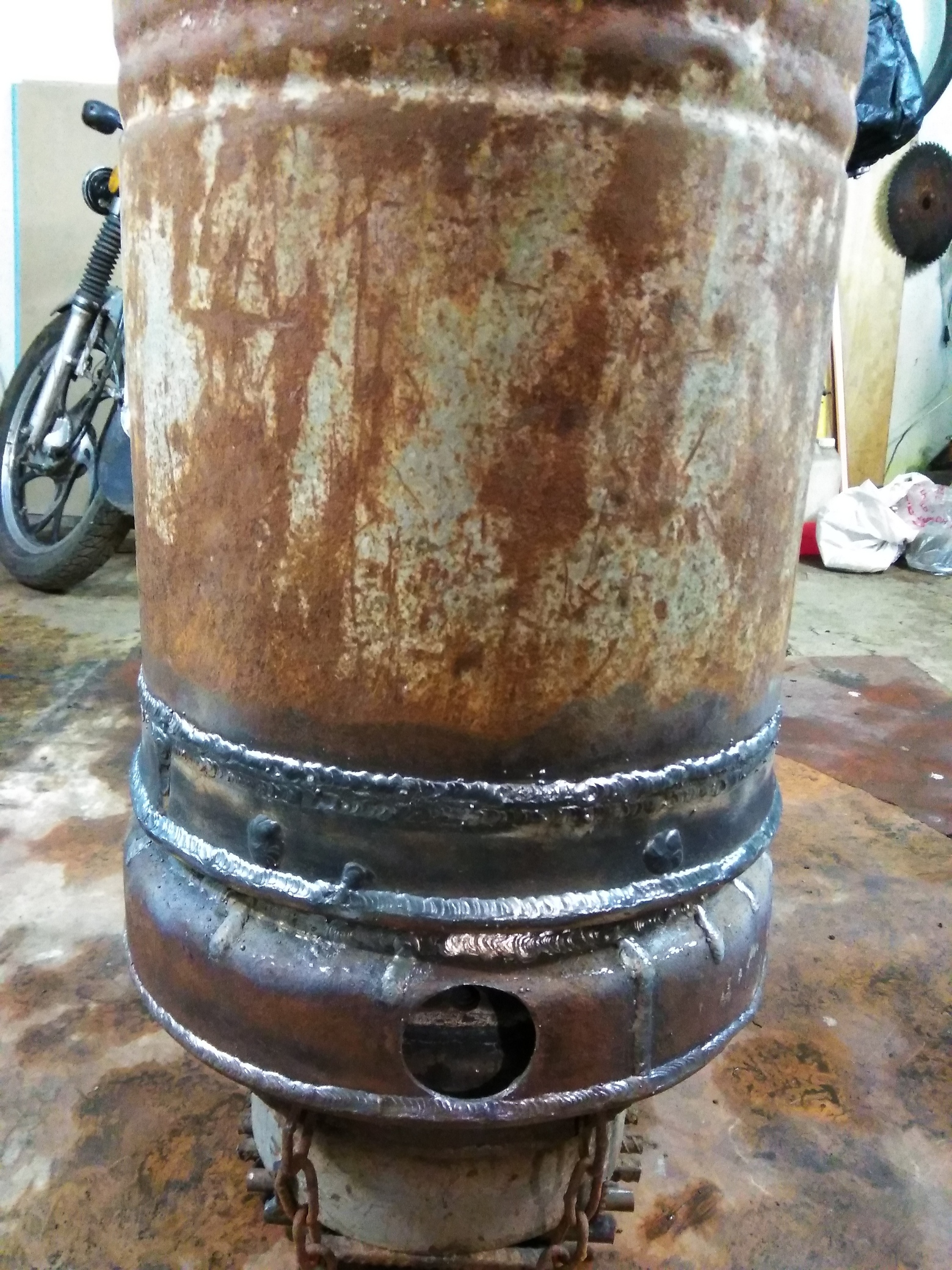

Good details Vitaliy.
I especially love the last two pictures showing you have insulated the Oxidization and Reductions sections.
Thermal-Chemical works best with lots of retained Thermal to drive the chemical reactions.
I welcome you and Jodi especially as raw wood gasifiers here on the DOW.
Surrounded by the growing easy-way crowds of Charcoal-tiers, I was getting lonely.
Well Steve, I guess you never heard that once you go black you don’t go back. Up to now I didn’t know what that meant.

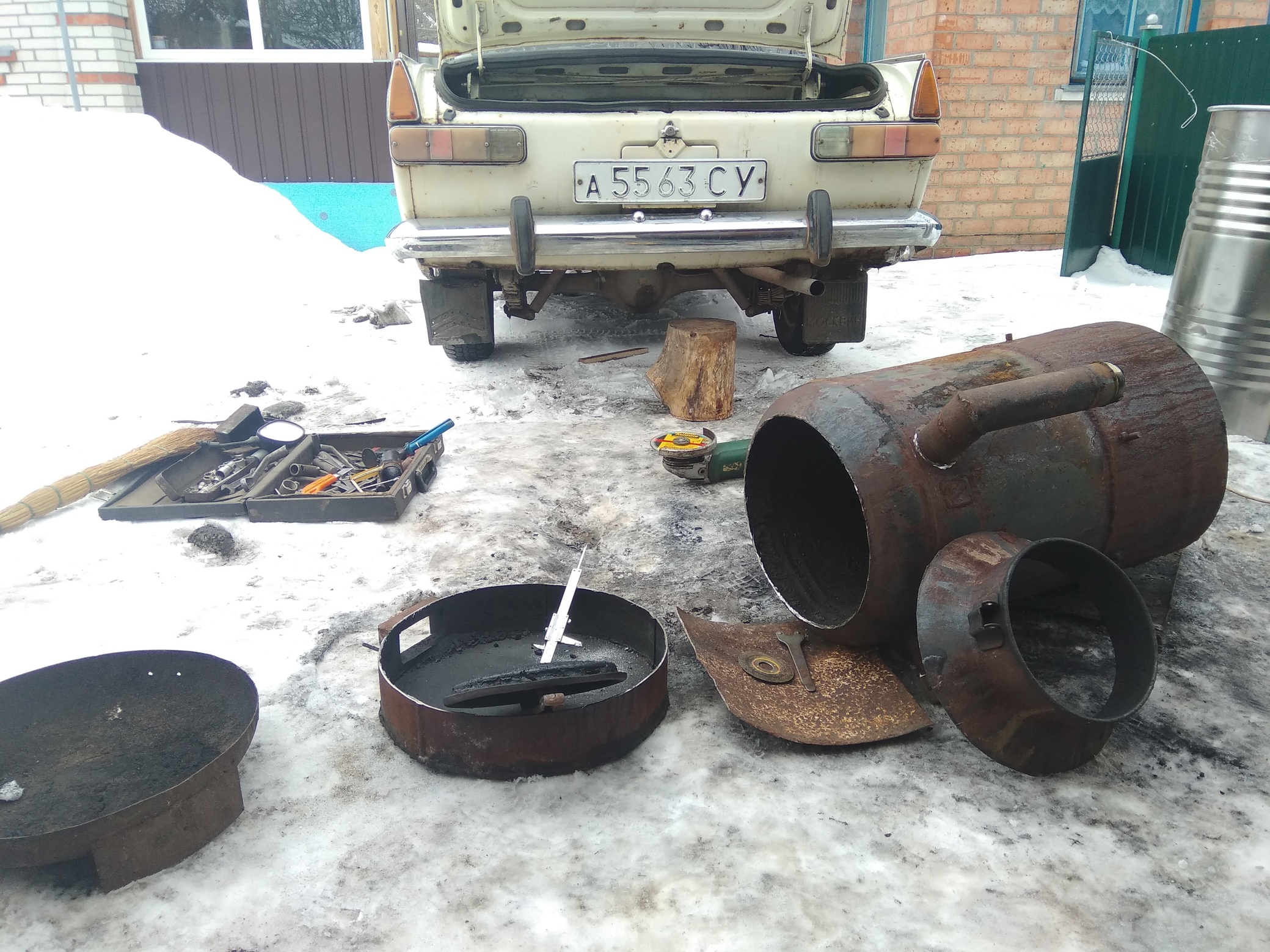

Very interesting Vitaliy. Looks like you repurpose old wheels as well. I use a lot of them.
