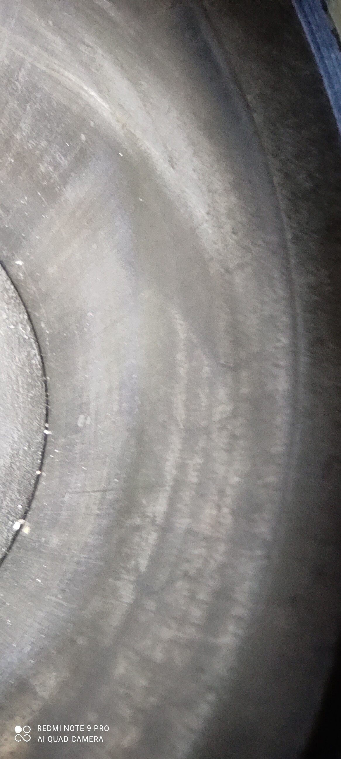

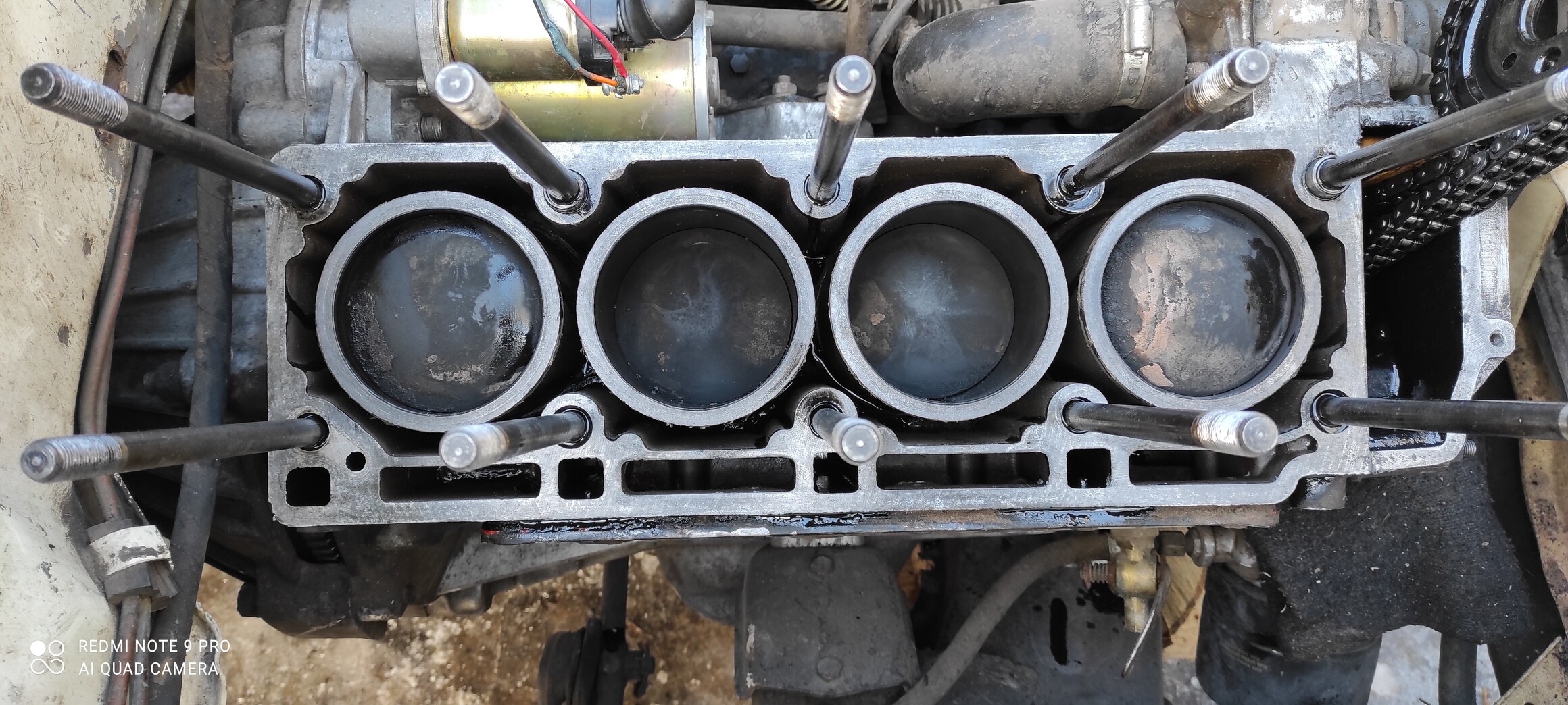

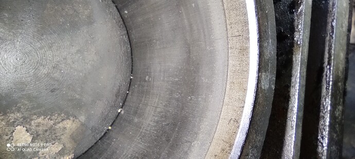

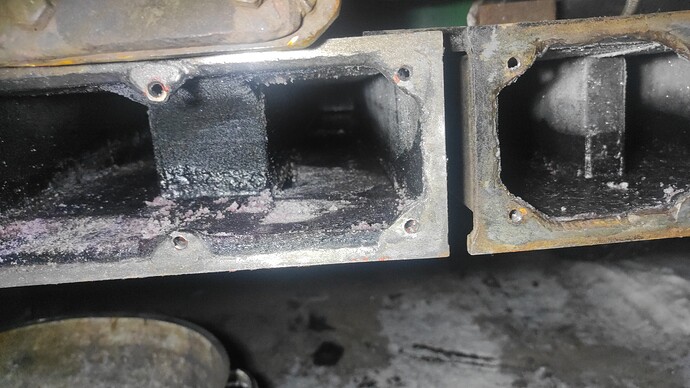

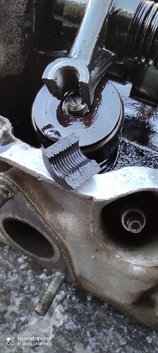

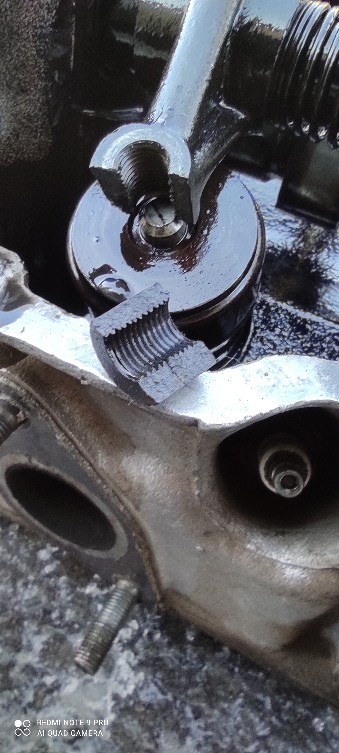

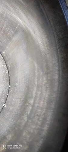

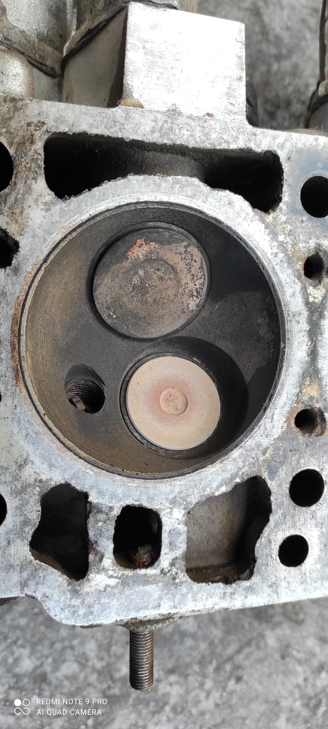

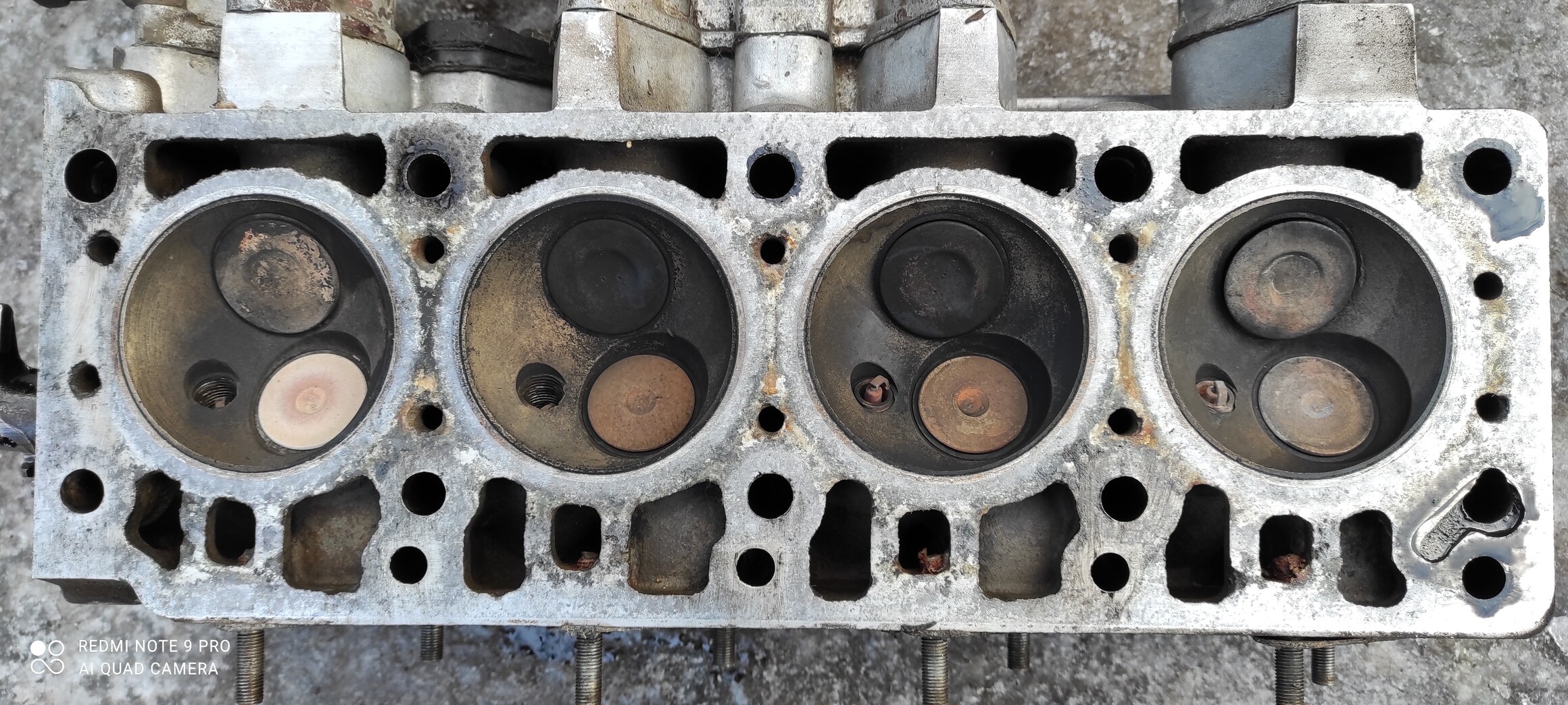

While adjusting the valves, the rocker arm broke and the engine head had to be removed.
Vitaliy, I can see those photos are only days old. it looks nice and clean in there after years of woodgas. Will you take the opportunity to increase compression when the engine head is off anyway?
Yan, in the spring of this year, increased the compression by grinding the head by 0.8 mm, after repair it was within 12 atmospheres. I haven’t measured it at the moment. After repair, I drove somewhere 10 thousand km.

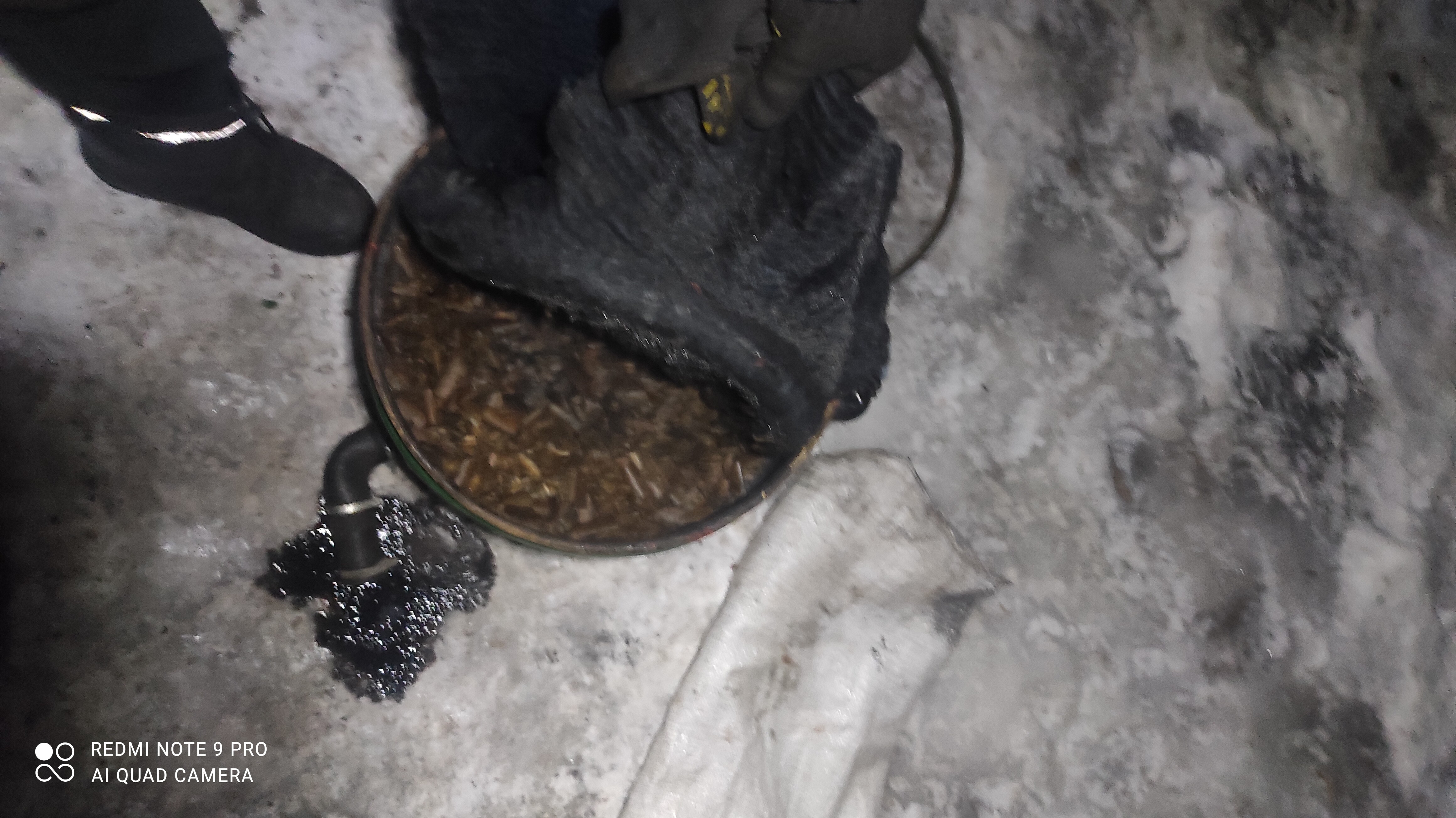

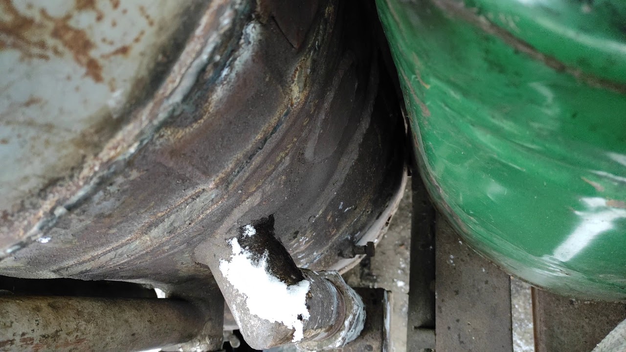

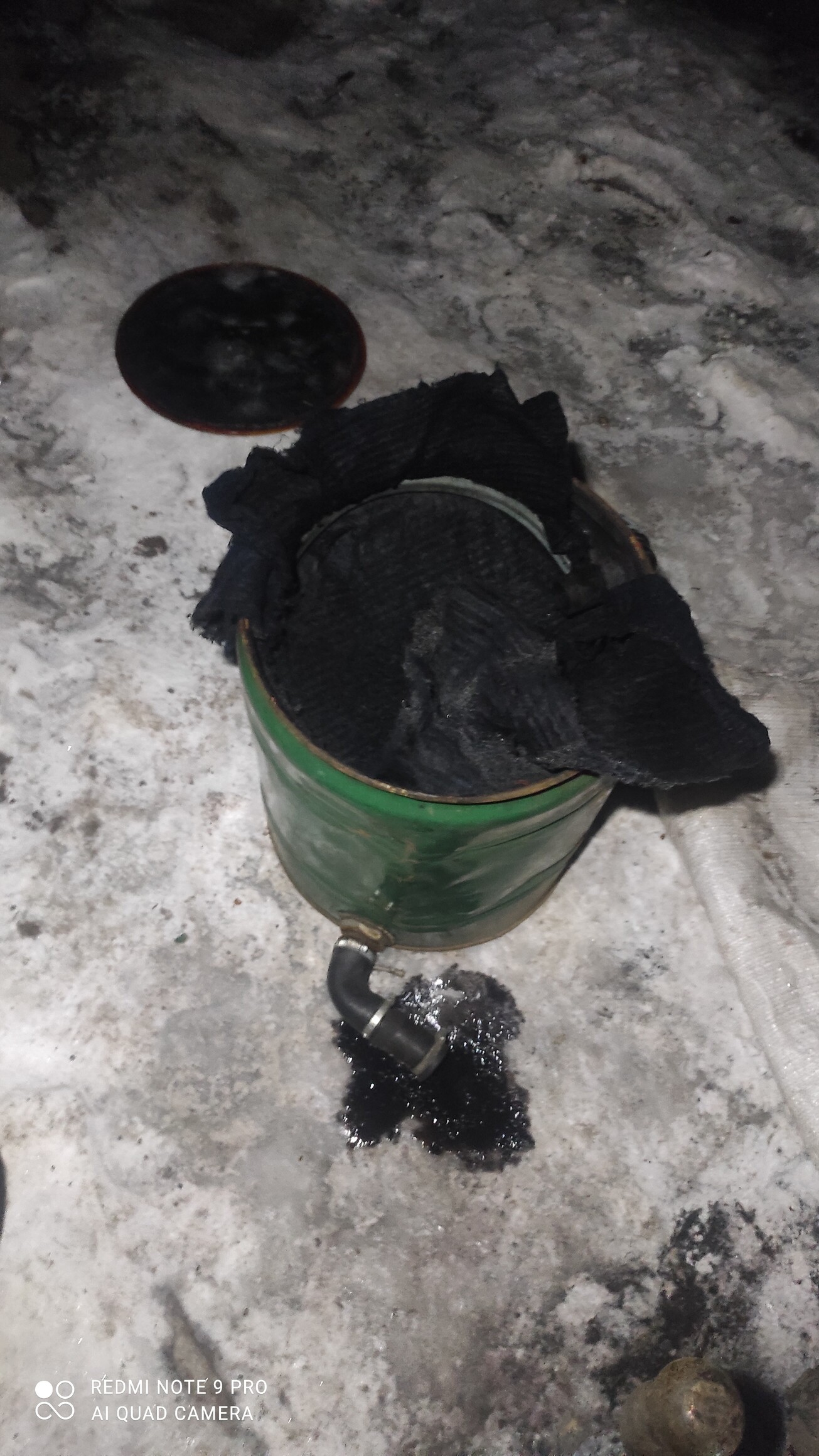

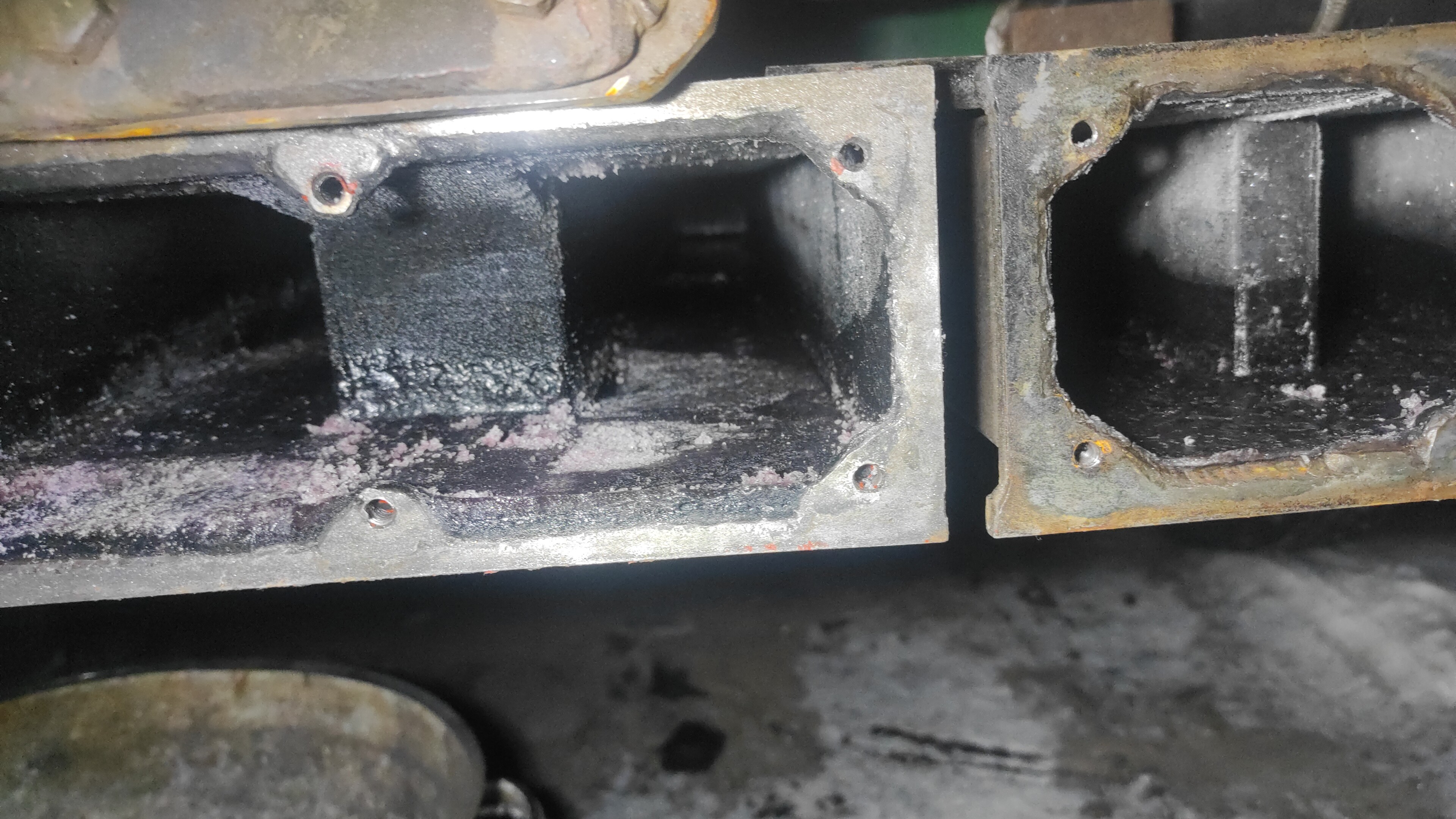

Here is my filter. And an updated cooler.
Thanks for the pictures Vitaliy :blush:

your filter is wood chips and a towel on top after the cooler, right?
Is there a problem with flow resistance when the towel becomes wet?
And your cooler keeps so clean by itself?
Thank you for your pictures!
Yes, at the moment I am using large shavings, sometimes after driving on raw fuel, the towel gets wet and the resistance increases.
