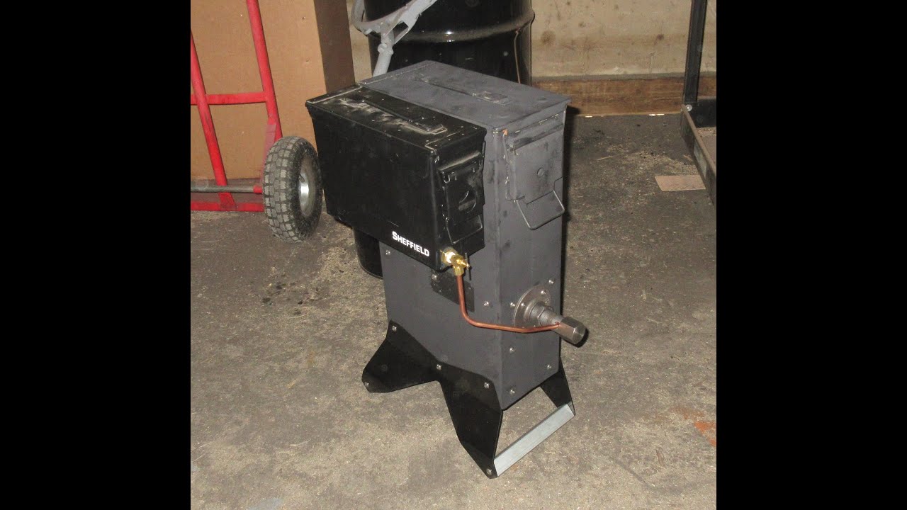

Kind of depends on what type of fuel you want to run, Rick. Charcoal or wood/pellets. I have run a generator that size with just a charcoal simple fire. For the riding mower, fitting it on the machine is a consideration. I’d lean toward one of Matt R’s ammo box designs. I don’t do wood so can’t comment on that.

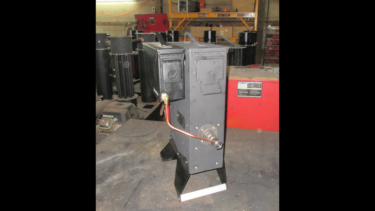

Now that we know you have the skills and equipment. Do you have metal break? Can it bend 16 ga steel? If so take a look at my ammo box tutorial. If anything It will show the basics of my cross draft design. If you can build a box you can make a more robust and larger version of this to run your tractor.
When you get to the blower filter and lid come get me or ask these guys. This is a dumbed down system meant for anyone to experiment with. For the filter you should build a simple drum filter and we can show you how to mount the Ametek blower to it.
This here bellow is the latest nozzle update. You dont need to purge the water tank with this new design.
The dimesions for a unit that will work accross all your engines should be.
10 to 14 inches wide
18 inches deep
30 inches tall.
Nozzle port hight is 6 inches above exhaust exit port on oposing side or the top of the grate. Its actauly a diagonal cross draft.
Use a minimum of 16 ga mild steel 14 ga would be best but depends on your break.
These machines are tollerant to some wood fuels mixed in the charcoal and less than engine grade charcoal. This is running at the higher end though. The smaller engines it will not be as tollerant.
For the lid, weld a flat flange on the top. Add a hinged lid and use flanged rope seal with a center clamp plate to secure the rope seal to the lid. The top flange plate needs to be very flate so no warping, I weld an angle bar structure under ours when we fab the commercial systems. Along with the sides of the hopper box. Then use the spring latches they used on the old Jeeps.
The “V” hearth should reach to the hight of the nozzle and you will want to suspend a grate about 2 to 4 inches above the bottom to allow the grate to screan out the charcoal and then you gas flow will exit from the grate and then out the exhaust exit port. You may want to weld or build a bolt on drop box to the back. This will allow some dust settling and give the gas some time to cool so you can manage the gas with out buring up hoses.

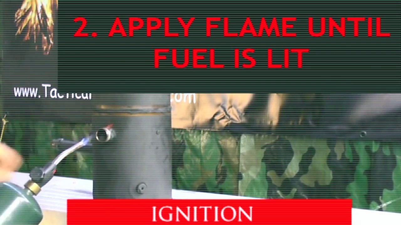

If you are producing smoke out the flare pipe something is not right . You should see a haze but not smoke. Maybe from this video you can judge the velocity of the bowers . This is a raw wood gasifier .

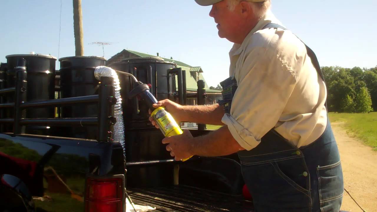

This video is a small version but it shows basically how the FEMA gasifier I started with was supposed to run with the blower forcing air in instead of sucking the gas out.
It looks like this one made smoke just like mine did but it should ignite. Notice that he adjusted the fan position to control the flame.
My current charcoal gasifier can be flared similar to this except I force air into the nozzle. It is difficult or maybe impossible to get a flare with the blower at full speed. Since I don’t have variable speed on the mattress inflater, I just hold the blower a little away from the nozzle which reduces the amount of gas coming out where I test for a flare.
I have never really gotten mine to flare by pulling the gas through the blower but I do use it that way to light the gasifier and sometimes to pull the gases through the hose to get it close to my engine.
