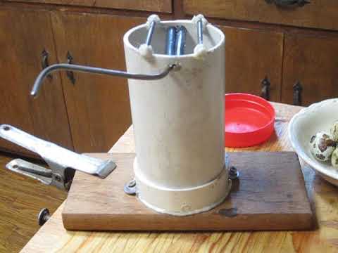

I got tired of peeling hardboiled quail eggs so I made this little helper out of stuff I had laying around my shop.

That is a very good egg peeling devise Don. Good job on that build. Will it work on bigger eggs too?
I don’t know. Never tried it but it might.

Well done Don , a fantastic device well thought out i have never seen anything like that before , just got to love inventions like that .
That is why my shop looks the way it does. I keep everything. :smiley:
I plagerized the idea from a facebook quail group with a few of my changes.
Superidea. Never saw something like that. I can imagine it saves you a lot of work with those small eggs. Top :grinning:
So the nylon wrapped wire is it gear driven or does only one side turn? Awesome idea between me and the wife we wear our fingers out twice a week will be building a couple of these this week ifn i can figure out the mechanism… peeling 48 eggs at a time takes the better part of an hr…
Greg, it is latex tubing, not nylon. This is the same tubing that slingshots use or you can look on Amazon under latex tubing. There is no gearing. the wires are spaced so that the tubing just touches each other and the one with the crank turns the other one in the oposite direction.
Awesome idea thank you for sharing…. My wife thanks you the most as her nimble fingers are getting the brunt of the quail egg shelling… funny how wood gasification fixed a egg shellin problem…
For the good of answering i built one today, it works well on yard eggs, no idea how it would work on a store bought chicken egg but does a beautiful job on quail eggs as well as chicken eggs from the barn. Thanks for putting the idea out here.
Stiill got some finish work but wanted to test my guess before i got too involved.
