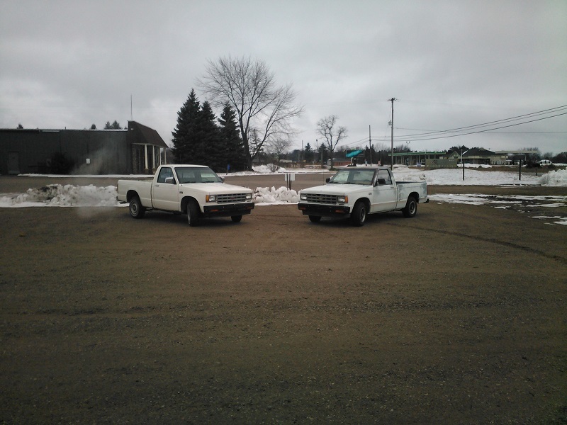

Ok I purchase two almost identical 89 S-10 2wd trucks. Both are southern trucks with zero rust, both are going to undergo restoration and both will receive vortec V8 chevy engines. I am planning to build both identical in paint scheme, interiors and trim. However, one will become a street rod the the other is going to get converted to 4x4 with a solid front axle and early 90’s toyota drive train. I think the 4x4 is the one that will get the wood gas system, the two wheel drive we will double as our shop truck so we will need the bed space on it. So Im returning to my roots, built lots 4x4 trucks in my day and two V8 swaps in the small compact trucks. This of coarse is my personal project so it will not be fast at all. My stuff always takes a backseat to everything, but I will post my progress as we go.

I hope I can keep the drive shafts under this one. The Toyota drive train is pretty bullet proof, Im retaining the 5 speed this is the only week link but if you keep tire size down the 31’s it will hold up just fine. Yeah they are a blast when you can drop shift at 35 mph and put em side ways.
