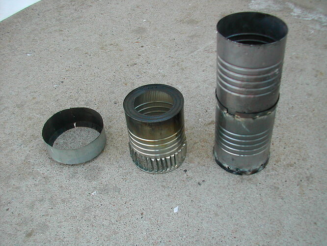

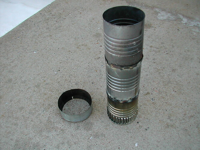

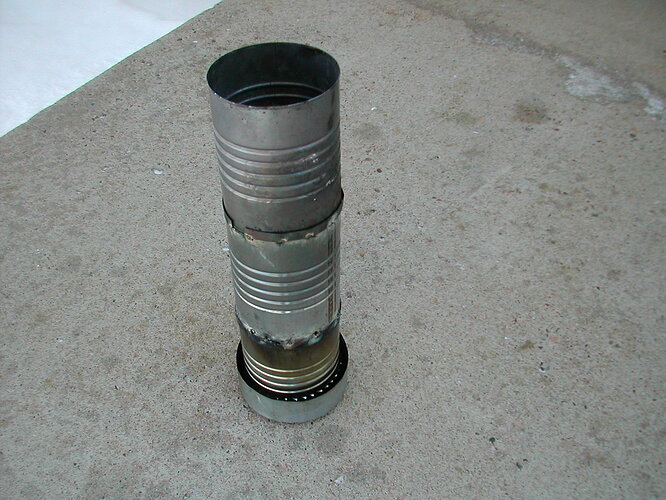

Any how, here are pictures of my afterburner chimney. The idea is to let a lot of air in at the bottom of the chimney so all the smoke gets burned up. A windscreen keeps it from blowing out. And Bobmack is right, the smoke from wet wood just won’t stay lit.
