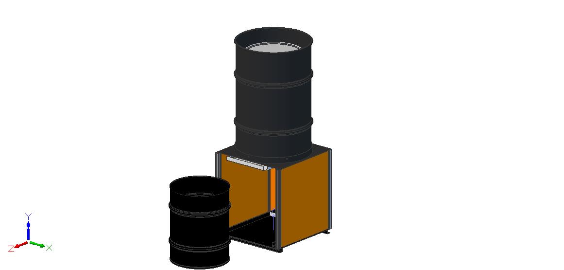

Build it an for sure explore new ways to do it! Post pics!!

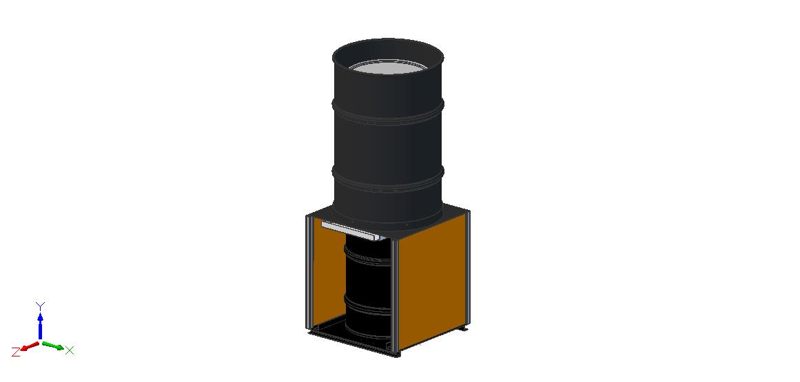

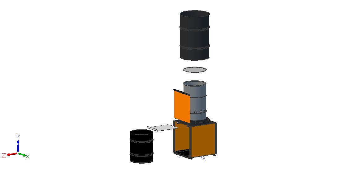

For the barrels put eye bolts in them and use a hook to pull them out and of coarse wear gloves. But they are not that hot, the charcoal cools faster than you think. Your replacement barrel will be cold. I now have a guillotine cut off plate I install to block off the fuel from leaving the grate while you change the catch drums out.

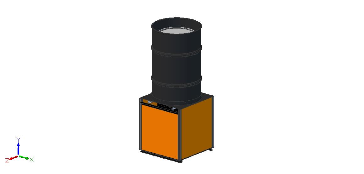

If you do a removable catch bin you must enclose it do not catch the woods on fire!!
I’ve seen your catch barrels and I’m not too worried about how hot those would be, but I meant using another barrel as an afterburner would be pretty dang hot to remove each time I wanted to refill the hopper. Though with a hot water heater tank I would get a good 40 gallons of space per batch so I could make it a Once a Weekend type ordeal with one or two batches. I need to get a reserve of charcoal in case I need to power my little generator.
