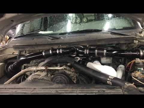

Oofta, first gas line is done. Lost some hair, skin, plastic and sheet metal in the process buts its in
Wayne, my hat is off to you sir you said you managed the Wilbur smith truck without cutting metal. This I could not do, not even close. Well done
Call it “pre-emptive rust loss removal”
Hello Marcus, you really have a lot of pipes on the engine, but definitely a good job. Have you tried to bend these pipes, I have done this many times, I heat it with a hot air heater and it curves nicely, of course more gentle bends.
Yes the air pipes are bent pvc using a pipe heater, I tryed to bend pipes for the gas lines but I could not bend nearly tight enough I just kept kinking the pipes and wasting material. Now if a guy could have found a supply of 2" *90 sweeps ( not street ell, but actual long sweeps) I believe a guy could cut what is needed out of there and make it a much smoother run. I tried throughout the whole build to keep as few sharp bends as possible what for resistance to flow and possible spots to clog up with soot, but it is so tight in this engine bay there was no way to avoid tight bends going up over around and down so many times so quickly in such a short run of pipe. this is also sch40, which tends to distort when bent, but even like over the gas tank which is a bent line it may be squished flat minorly, but the capacity of the line should be the same and still flow fine. And every last pipe is removable to keep maintainability

Maybe next time you need to, set up a jig and fill the pipe with sand. Something you can reproduce since you have dual input. Back when I made PVC pipe bows I made an Easy Bake Oven with foam insulation and aluminum flashing sheet with one of those hot incubator bulbs.
I have done that before to make exhaust pipe at home thats " mandrel bent" not perfect and very time consuming but it works great
I bought a roll of this for a gasifier I haven’t gotten to yet. Bought it a year ago I’m embarrassed to say. I not sure it it could make sharper bends.
The 2" stuff I bought for the Mazda couldn’t bend too tight. It was a 180 degree bends at a 4 foot radius with 6 feet of flex exhaust. It was as tight as I could get it with every segment helping out.

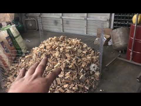

Hi Marcus, make sure you water the hay down in the hopper before starting up on wood gas to get the fines out of the hay. Heck just leave the hopper lid off for awhile the poring rain will take care of it for you. And drain the extra water out using the new 2" drain.
Yup put some nice charcoal in up pass the nozzles and some rocket fuel mix in for the quick start up.
