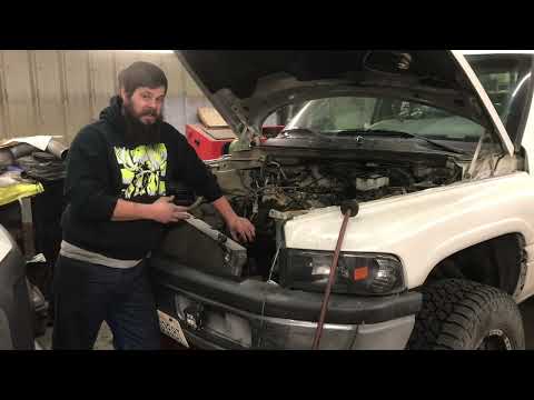

I can break anything I swear. Pushrod was dead straight, and no odd wear patterns on the pushrod, valve stem or either end of the rocker. Just a nice polished spot inside the valve cover where the pushrod had been jumping up and cleaning it by force
Can you check on equimpment to see and to make sure the hickups are on that cylinder only that the bolt snapped on and not happening on another cylinder?
Yes i can pull the plug wire and the engine run exactly the same connected or not showing that cylinder is not co tributing to power made. Could be a cam lobe, lifter, or valve problem. If the woodgas plumbing wasnt in the way so badly it would be simple to hook up a cylinder leak down tester and check the valves and piston rings. I am crossing my fingers that the marvel mmo will loosen something up and that cylinder will come back to life
But in reality this is a high milage motor that does burn some oil, with a unknown service life before I got it. The green trucks motor is sitting a few feet away on standby

I did look at the vakve spring while i was in there and it looked fine, didnt see any breaks or cracks in the spring. If it comes down to it and I use the green trucks motor, I would be very tempted to use the obd1 harness and computer, to see if I get the same performance and speeds of Wayne’s truck…
Oh, so this is a OBD 2 system interesting. So you can change out a OBD 2 over to a OBD 1 on a newer truck. Humm… this opens up more posibilities with newer trucks if this can be done. My 2003 crew cab Dodge Ram with a OBD 1 in it and a lot bigger engine.
The beauty in the second generation full size dodge trucks, all harnesses are plug and play.
V10,v8,v6,6bt diesel are all the same truck with 3 wire plugs on the firewall for the engine harness. The v10 from early obd1 (94-95) to obd2 (96-01) are the same truck, same interior harness except a few options on the dash ( radio, heater fan, lights) exterior lighting harness all the same except fender lights on a dually. Plug and play swap from one to another.
The 96 and newer obd2 is tuned from factory for emissions purposes. The 94-95 is unknown, it may have a much more aggressive timing curve since it did not need to meet emmisions standards.
If my only standard to measure against is felt power by how hard my ass is pushed into the seat when I smash the skinny pedal, my 94 would run circles around the 96. The engines are exactly identical in every way. Exact same sensors even. If a guy wanted to i think he could lop the pigtail off with the computer attached and splice it right onto its counterpart

HI I would say it has not been torqued properly and it has been stretching at every time it is loaded. This has caused fatigue and eventual breakage. I have seen the same on a Cummins L10 engine where a guy fitted a Jacobs brake. It required longer bolts . The guy could not get the specified grade 8 long enough at the time so he got some grade 12.9 allen head cap screws and used them , that was fine . His mistake was that he torqued to the same spec as the std bolts . After some hours use he had a break exactly like that ,which sent the whole engine to lunch .Cause the stronger bolt require a higher torque to get into the critical stretch zone that keeps the bolts tight . it allowe the bolt to work causing the failure
