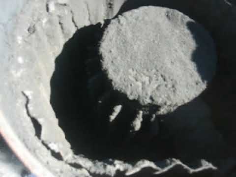

This video shows what I usually get out of my heat x drop box . It is usually just dust .
