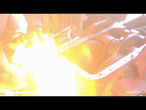

no trying to hijack the thread but I have a tractor transmission that got filled with rain water for a couple years and the engine is rusted up as well. right now I have the transmission full of burnt motor oil I haven’t had time to touch the engine.
How would you guys suggest that I free it up?
I always put a ball peen hammer in center of the bolt ,OR a flat drift,and then hit the big end of the ball peen hammer with a little bigger hammer, if that dont work you either have too blast the nut part of the axel housing with a torch,then repeat hitting center head of the bolt, almost always works- other wize the bolt breaks and you must drill and retap the bolt if you can get bolt out with an easy out drift like tool. ITS much easier if you can add some heat and hammer center of the bolt head.AND yes soak it with wd 40 or some of the other mixes of thin penitrating oils
That heating the bolt not help as well as heating the cast iron block- cast iron case will expand more in the right direction-I would think- though that worked adding heat.I have taken several hard bolts out useing propane too the outer casting threaded areas.
If you heat the cast iron, there is no risk of it cracking?
Jan, if you heat only the screw, the case will not crack, the fastest and most intense heating is heating with electric welding, this is how I solve broken screws,…
Metals normally only crack under rapid changes in temperature. For any bolt loosening using heat I have found it’s best to use oxy/acet with a small brazing tip. That way heat is applied to a concentrated area. I have even removed a bleeder in a caliper like this when nothing else would work. I always use heat as a last resort though. By just heating the bolt it will expand and then contract and that is often enough to break the bond the threads have formed. Last resort is heating the area the bolt i threaded into but sometimes you just have to reach into your pants and get a handful.
ALSO i have taken several rusted in studs-if stud is sticking up far enough ,you can weld a nut on the stud, and the heat from welding helps loosren the coroded theads,and use the welded on nut to remove the stud- so i gess heating the stud do help.I never had any cast iron around the nut thread area brake- as long as you let it cool slow untill not so hot.I might even try the heat the stud and candel wax trick myself- GOOD LUCK ALSO cast iron can be stick welded with cast iron rod-but the whole area must be heated first with a torch. WHAT TOM said is better yet with small tip when that keeps the heat away from other seals or gasket areas.
