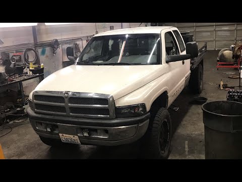

I think im the only one that could turn replacing drum brakes and axle seals into a 40 minute video
oh well if it helps out one guy down the road i think it was worth it
Thanks Marcus, thanks for all the great tips. You make it look so easy to do. Lots of brake jobs under your belt in your years of mechanicing.
I did the other side in about 10 minutes, but turn the camera on and it takes forever and i struggle with it haha

Very nice to watch a master at work ![]()
Ditto what @Wayne said Marcus. I love watching your videos, as you explain things so very well, not only what you are doing, but the reason you are doing it that way. My hat goes off to you sir!

Also, very satisfying to watch with all the proper tools used. When I did rear brakes on the Mazda truck I managed to stretch the job out for two days - and that’s without struggeling with a camera ![]()
Great presentation job Marcus.
I like you learned and showed the two handed push whole assembly back and forth at 30 minutes. No easy swinging around the top buttress - anchor pin and a fellow did something wrong.
Ha! I had newbie assembled pop apart when I did this aggressively. Wrong assembled again.
I also love that you are showing a normal service restoration job.

Yes i once too had a anchor pin not locked all the way in when hand smacking and came rocketing out under spring pressure and smack me in the chest. Much rather it happen at that time then driving down the road and brake parts get stuck in places that severly impeded braking effort when you need them most! Over the years have seen more drum brakes incorrectly assembled come through a shop door then any other component. Many times anchor pins missing or chewed to pieces from popping out, auto adjusters not installed correctly, adjuster in backwards, of course the obligatory leaking wheel cylinders soaked shoes, occasional broken main springs.
I forgot to mention in the video after doing axle seals and reassembly to double checked differential fluid level! What leaked out of the hub seems a minimal amount but must be replaced. Personally i do a differential service at the same time so all new fluids. Definitely dont want those wheel bearings being run dry!
