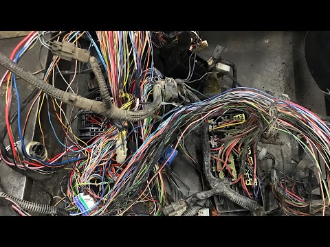

I have no clue. I have been pouring over wire schematics for hours chasing color codes. Holy moly, this is one part of factory fuel injection and on board diagnostics I do not like.
Turns out the main bulk head connector that ties the under hood harness to the dash harness is pinned differently, just enough to be annoying. Engine runs, everything in the cab works perfect but no marker lights no turn signals no license plate lights no brake lights.
Normally I would swap the dash harness from the donor truck but in this case that harness has been chopped and hacked by several previous owners and had its own problems which were extensive enough I refuse to use it. Seen enough pictures and videos online of second gen dodge trucks burning to the ground I wont let mine be one of them.
Did I mention neither Haynes or Chilton’s manuals have wire schematics specific to the 94-95 obd1 trucks, only 96 and up? Or that all the wiring color codes changed between obd1 and obd2? Ya I’m pretty much flyin blind poking things with a test light to find the dedicated circuits and try to work them out from there. The 2 harnesses in the last picture are the interior harness from the green parts truck and the under hood harness from the white truck, with the mismatch bulkhead in between that im pinning out.

Check the ground. After I did the Cummins swap in my 99 Ford 350 I had no wipers power windows, turns out they shared a ground with the transfer case switch, which I remove, because the one I put in was manual floor shift.
That was the very first thing i did checked all grounds cleaned and reinstalled no change. Found several wires in different positions inside the bulkhead so far, but after the wreck last week my multimeter is having issues, makes chasing wires a lot more of a pain
You probably already know this, looking at the picture I see that you took your multimeter battery out but perhaps it helps someone else, when my multimeter shows weird measurements its often as easy as the battery needs replacing.
we are of the same mind set on that one, I dont know if it was just coincidence of the wreck or what but I just popped in a new battery and it seems to be working now. First battery I have had to put in in the ten years since I bought it
