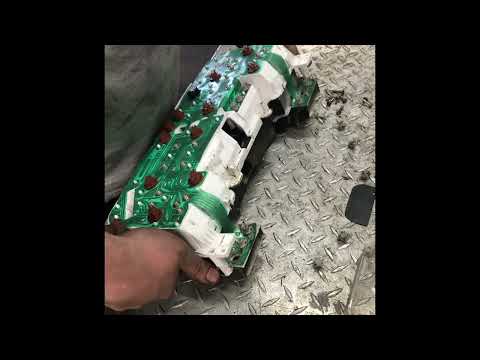

The afr gauge is dimable, but the prosport one appear to be set by the manual setting on the back. With the green light in my Toyota it is no brighter then the rest of the dash Wich are factory 194 incandescent bulbs, that’s why I opted for the nightime setting of green on this build

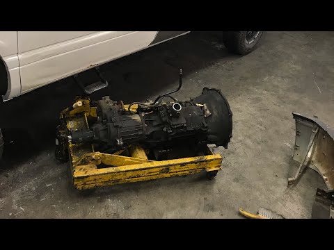

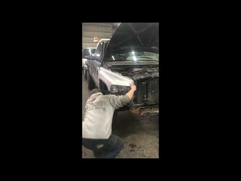

Been going every last minute iv got lately got the trans pulled from the donor truck, ill see if I can get it stabbed in tonight. Ttill need to swap radiator, delete the abs pump that has failed and swap it to the rear abs only from the 94, but in the 4wd front axle actuator assembly and all its lines, finishing painting the front clip so its all one color, clean up the interior, figure out the electric mirrors that are inop, swap the air box over for the time being while I start building the gasifier system onto the donor truck, swap the front axle outer assembly’s so I have manual locking hubs and serviceable wheel bearings, I may end up swapping the exhaust off the other truck since it is stock and in better shape and I’m sure ill discover more as I go along. just keep cruising along and get the truck on the road on gasoline so i can concentrate on the woodgas system
